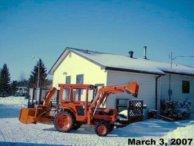

I've had my B7800 for 8 years and it now has 338 hours on it. I am still amazed at how much work it can do. I run a 5 ' bush cutter and a 74" rear snowblower with absolutely no difficulty. It has not given me any problem in the 8 years except the safety switch on the HST pedal came loose once, but that was a simple fix. I highly recommend the B7800.
