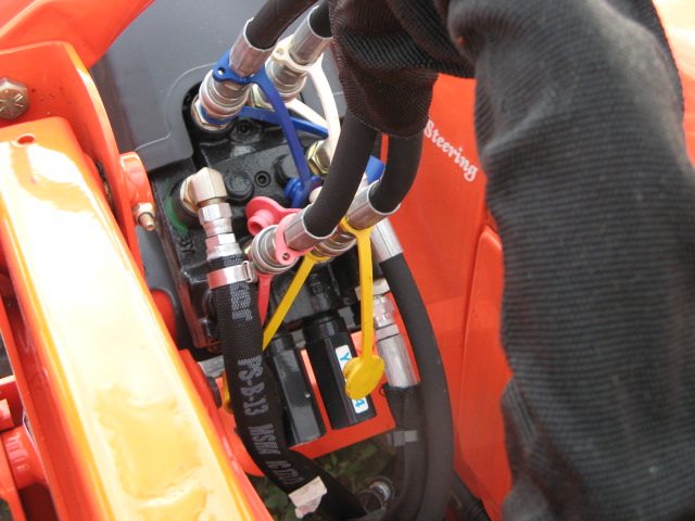

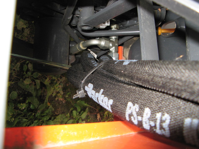

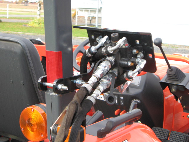

I just went to my dealer yesterday and he had a rear remote setup on the
B7800 on the lot.
I took a few pictures and will post them when i get home, there is a neat bracket that mounts the valve to the rops and the system has three hoses. one return to the tank teed into the return from the loader valve plus the two hoses for the power beyond loop.
hope this will clear up some confusion, but I'm certainly no expert so I'm not even sure if this setup is done the right way.
   / b7800 rear remotes
#2
ok guys here are the pics, one is of the T into the return line, one is of the bracket that mounts the valve to the rops and the third is a picture of the loader valve.
the hose with the protective wrap on the loader valve goes to the remote valve and the hose without the protective wrap goes to the pressure block on the tractor the same as if the tractor didn't have remotes.
anyone have any idea who makes that bracket to mount the valve to the rops
thanks
