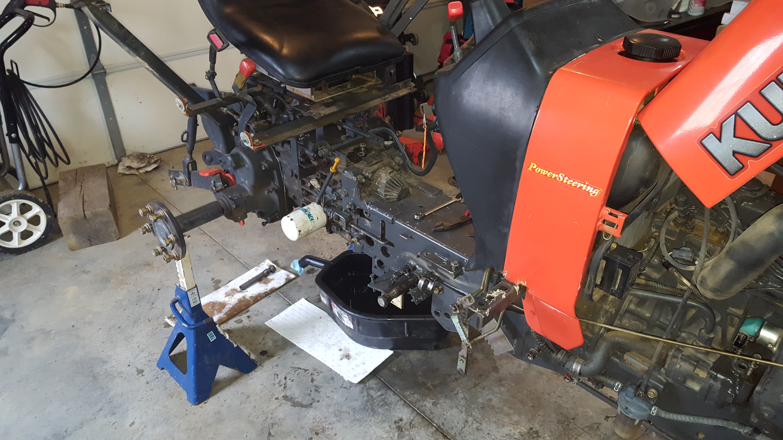

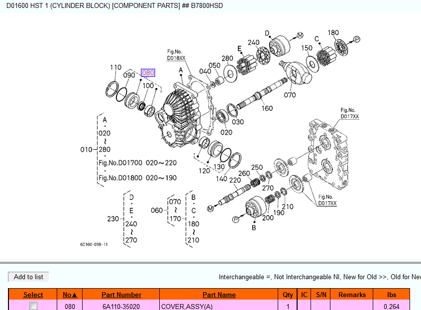

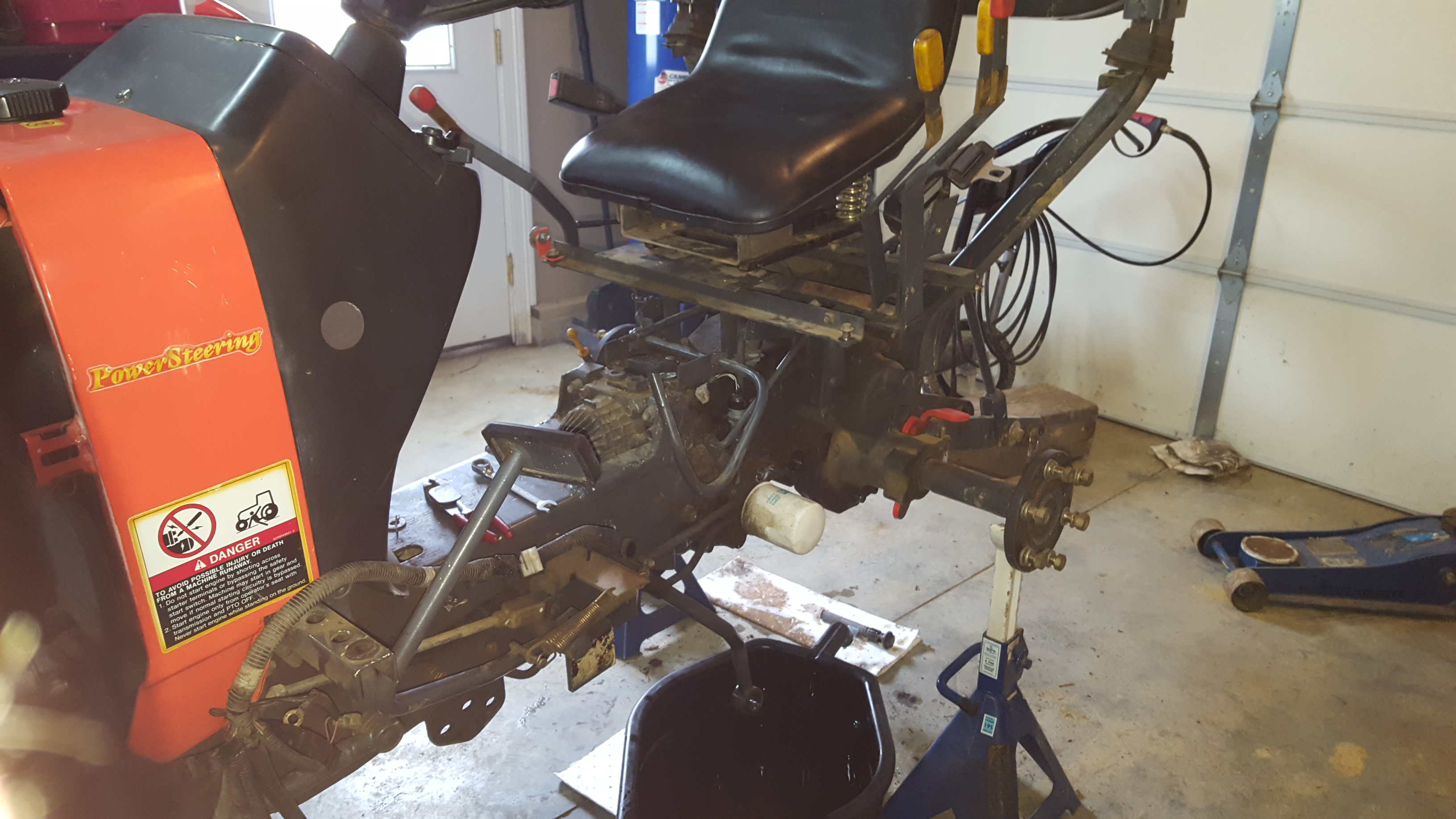

Hello everyone. New guy here. just had some issues with my 2006 B7800 while out mowing the other day. Noticed the tractor was not going as fast while mowing. I found that is was faster in reverse than forward. I stopped mowing and creeped back to the garage to find low fluid and a leak at the side cover where the speed change shaft is. I talked with the local Kubota dealer and got what I needed ordered to fix the leak. Doing a full fluid and filter change on it as well. Now to replace this part I need to split the tractor. I haven't had any luck finding the WSM online for this (if you know where it is or wanna share, that would be awesome!), but I did start tearing into it. Now do I need to split it at the clutch or can I split it at the rear and not tear apart the front body? I am attaching pictures of where I am at right now and one of the parts that are leaking. Capture.PNG20160409_141809.jpg20160409_141828.jpg20160409_171354.jpgCapture.PNG20160409_141809.jpg20160409_141828.jpg20160409_171354.jpg
