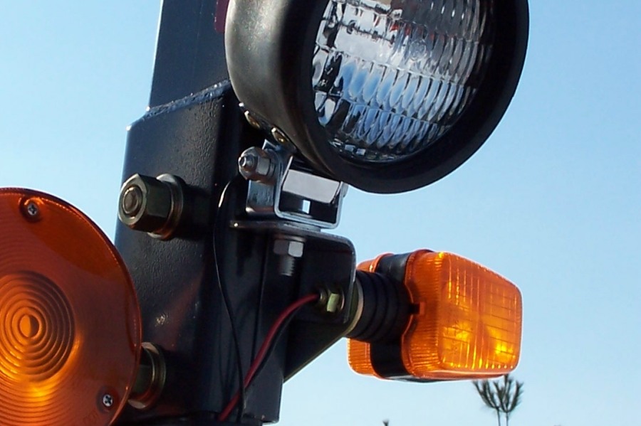

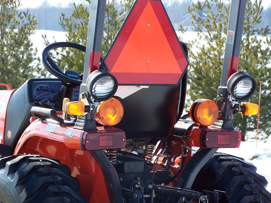

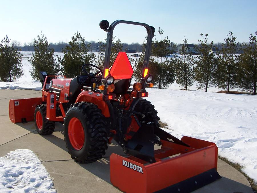

I recently added some floodlights to the rear of the tractor using home made L brackets fastened into the existing side light brackets. The lights are fed by a relay, which is wired into the headlight switch. When the headlights are turned on, the rears also come on.
Photo attached.

Close up of bracket.

Back up shot.

Nice install B,
Let me ask ya, I just got my 7610 and it has a backhoe on it so I was definately looking into some rear lighting. 2 questions: What type of lights are those and did you have to upgrade your alternator?
My biggest complaint of my new tractor is lack of seat time. Yes, you could say I'm "all hopped up on tractors" now.... /forums/images/graemlins/smirk.gif
   / B7610 Rear Worklights
Mo,
I got the lights here http://www.awdirect.com/awdirect/finditem.cfm?itemid=6119
I did upgrade my alternator from the 14 amp to the 40 because I also added two 100 watt front facing lights. See this thread. But I think these lights are only 35 watts each. So if this was all the lighting you added, the stock alternator will be fine.
