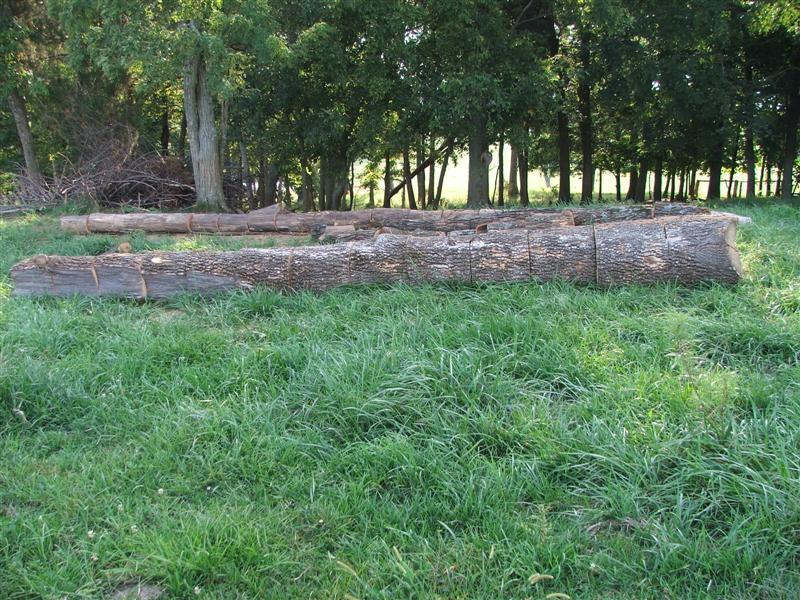

Here's an Ash that I pulled out of the edge of the woods and about 300yds. to the house, I have already cut it into stovewood, it is 26" at the big end and 16' long. Steering brakes would have come in handy.
