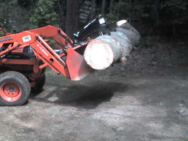

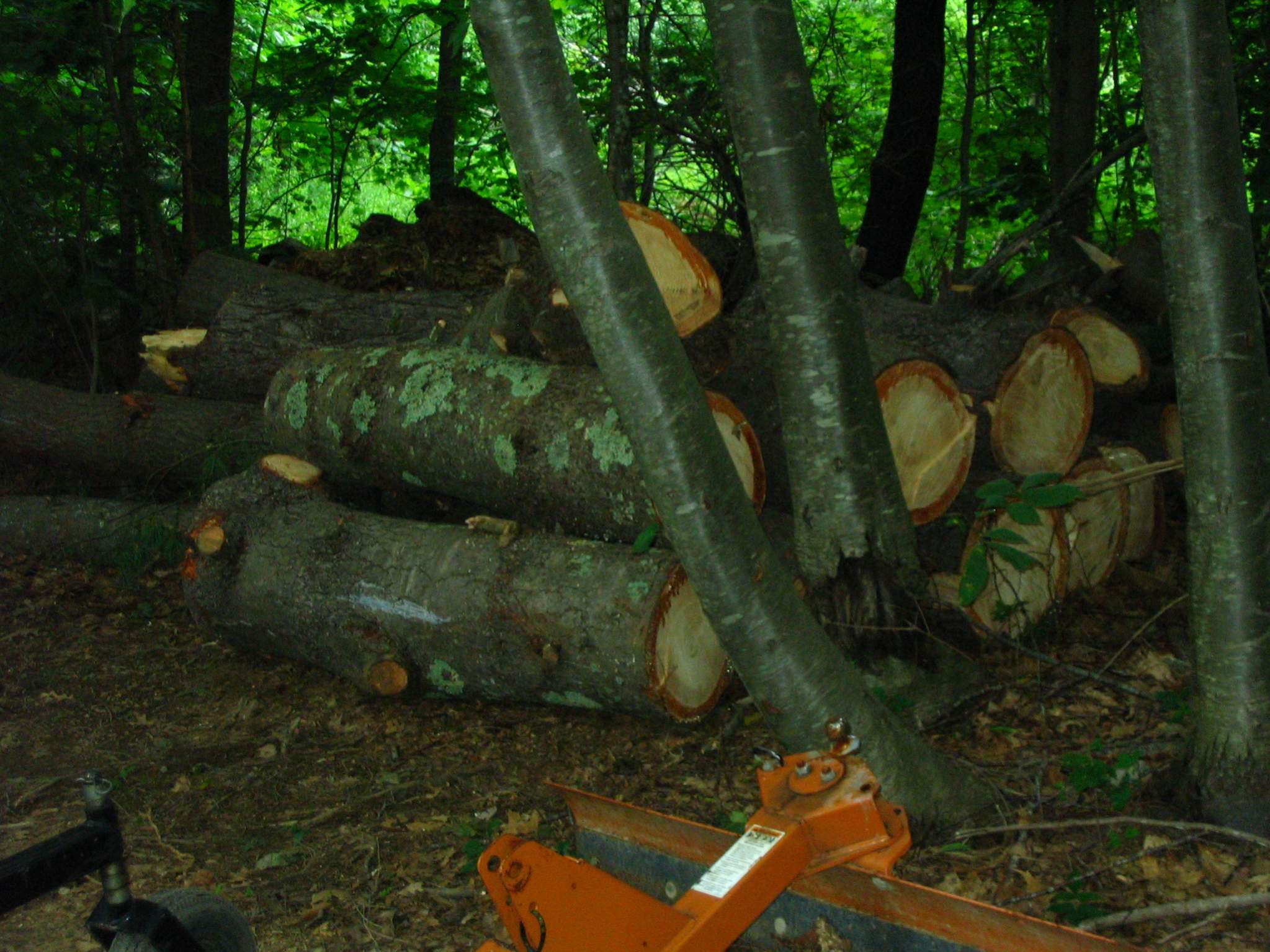

I second easygo post with my 7510.. I have loaded turfs, and use a hitch 3 pt hitch mount to chain up and lift the logs, key is getting the butt off the ground...
Also see attached pic of the bucket with my grapple...with the loaded turfs I could handle oak and maple logs 4' long up to 30" and these fresh cut pines 6' at 30"+

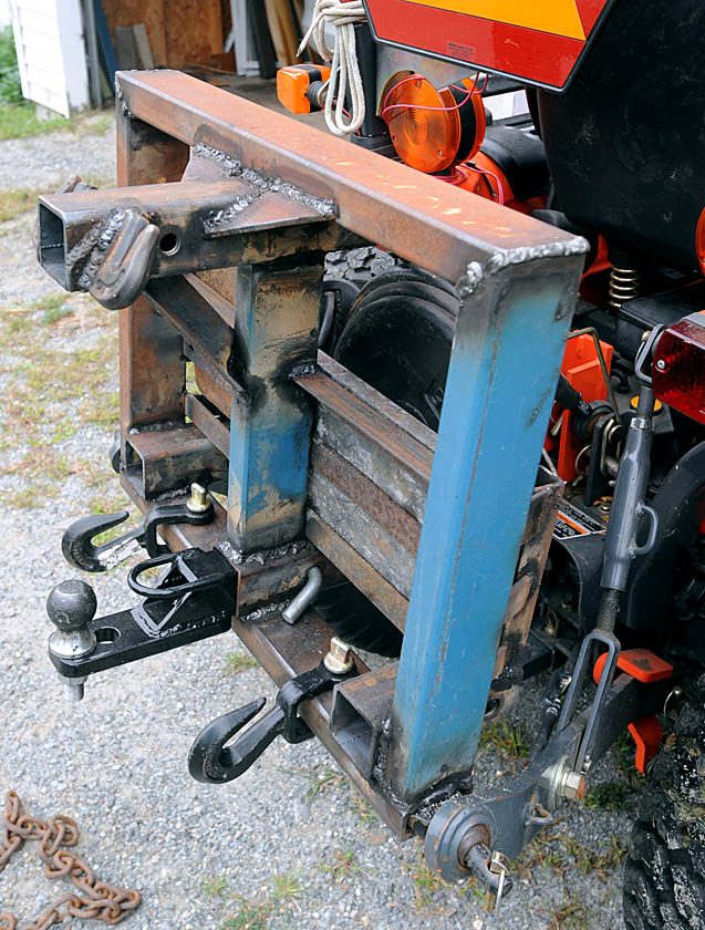

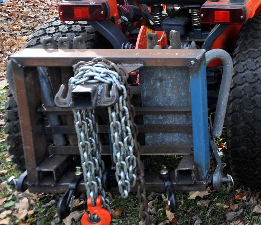

I have a similar setup too. I built this combo contraption last year with hauling logs in mind. I have short chains that I choke around the but end of the log with a slip hook and put the chain into the top grab-hook. The slack end of the chain has a grab hook that I slide onto the first available like as the chain exits the slip hook and slide the chain into one of the lower hooks. It sounds much more difficult then it is. So that way the actual pulling force comes from the lower links and the top only has to hold the log off the ground.

Nice set up Easygo...

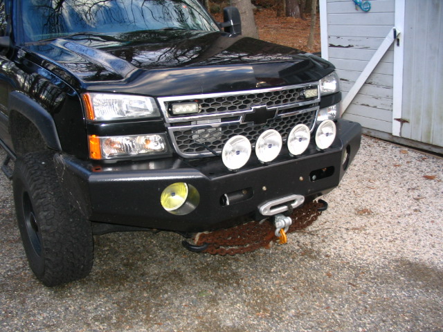

If I need to winch a log out, I get the truck!! 12K winch, if that don't work, chain it and GUN it!!!!

Looks like that truck would pull out your tractor and log at the same time without a hick-up.
