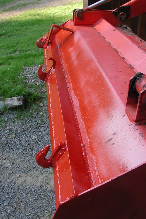

Just got a B7510 Yesterday, and am a total newbie at tractors. I am reinforcing the top of the blade with a piece of 1" black pipe, welded along the top, under the lip, for my hooks.

Your idea for reinforcing the bucket with steel pipe where you plan to attach the hooks sounds like a good one. I would be interested in seeing that once you get it completed. Post a picture if you can. I got the B7610 this Saturday and I am looking forward to getting more seat time. Enjoy your tractor.

   / B7510 #6
Denni,
I was going to use a piece of pipe too. On my B2910 it fit perfectly under the lip.
Then I noticed I had a piece of angle that would give a better surface to weld the hooks on.
I have attached a picture of how mine turned out. I am glad I went with the angle, but I am sure the pipe will work pretty well too.
Happy tractoring... /forums/images/graemlins/smile.gif
