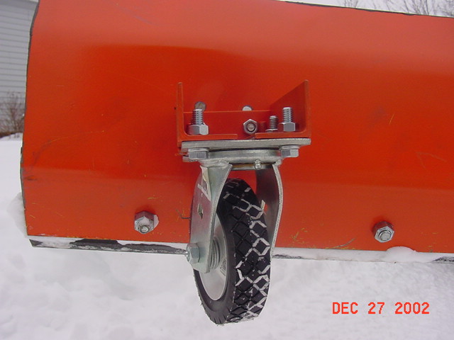

I have the same 7500 and a 6' rear blade but instead of adding shoes, I added wheels that keep the blade 1" above ground. Check it out.
