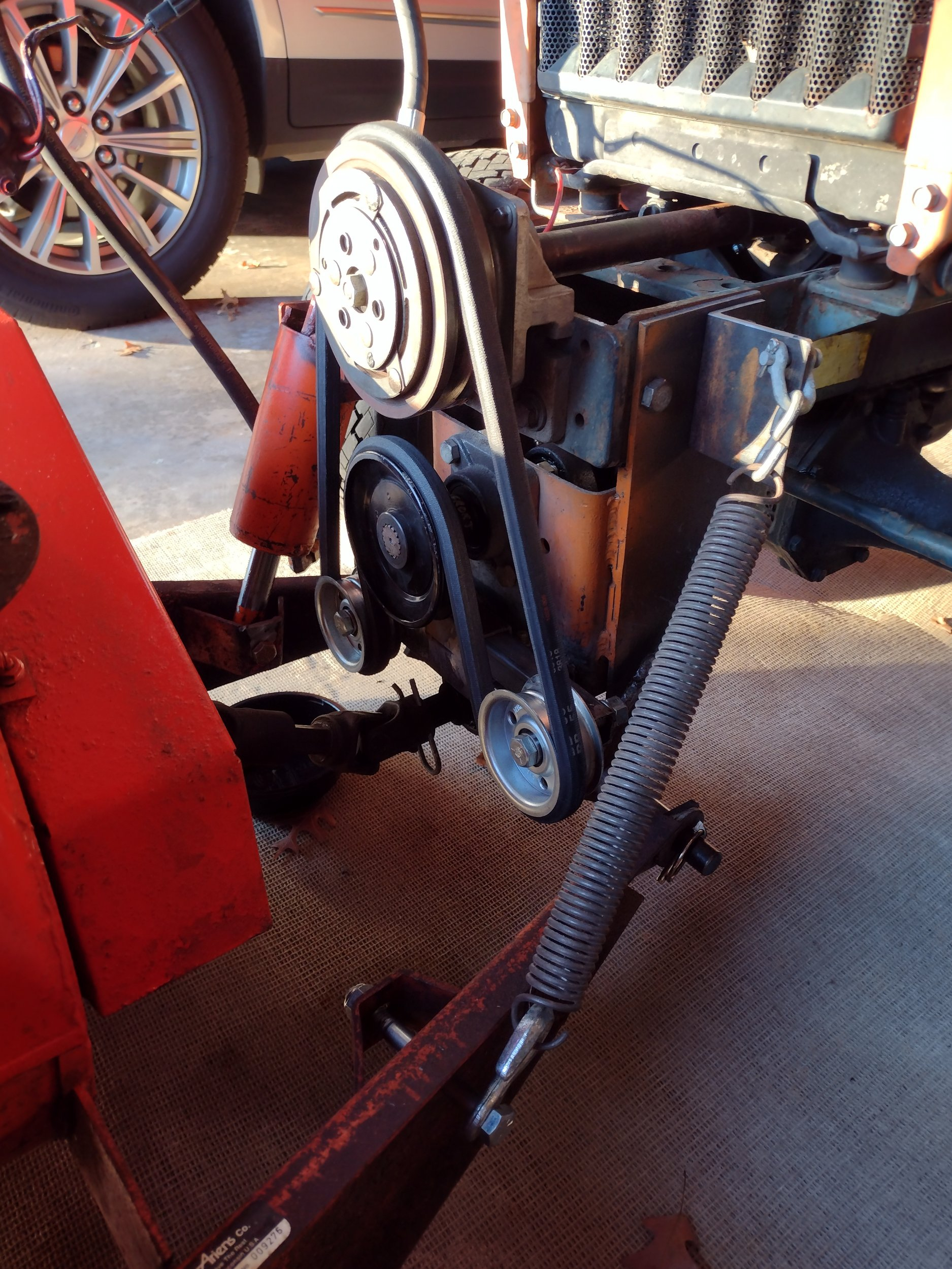

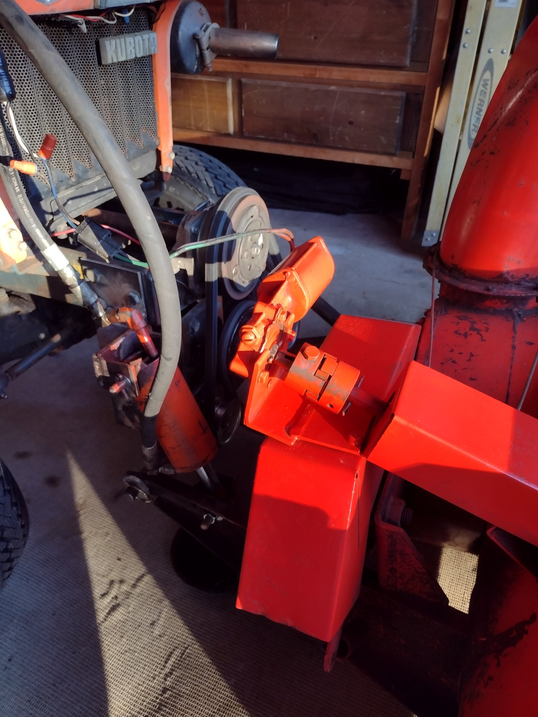

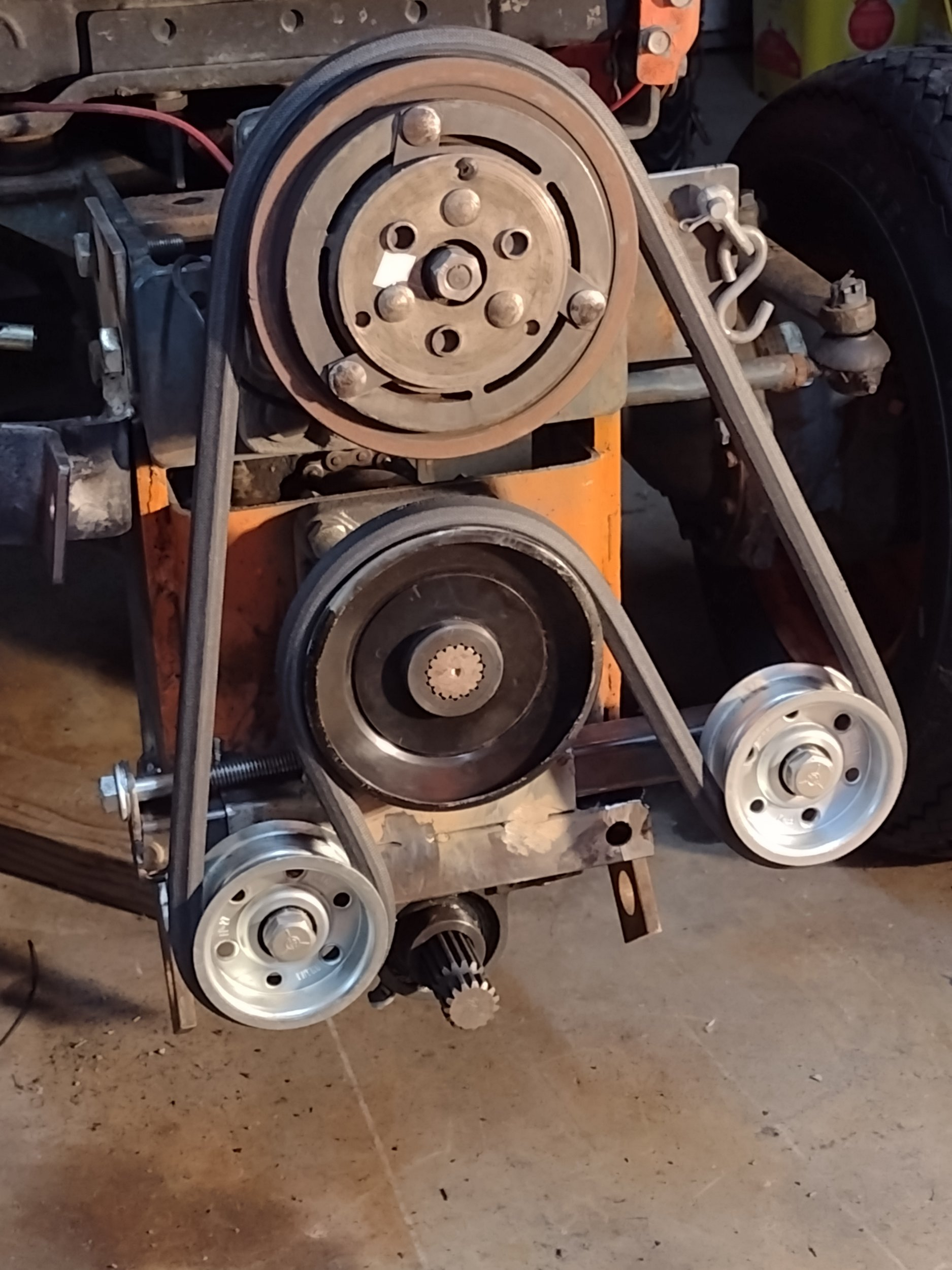

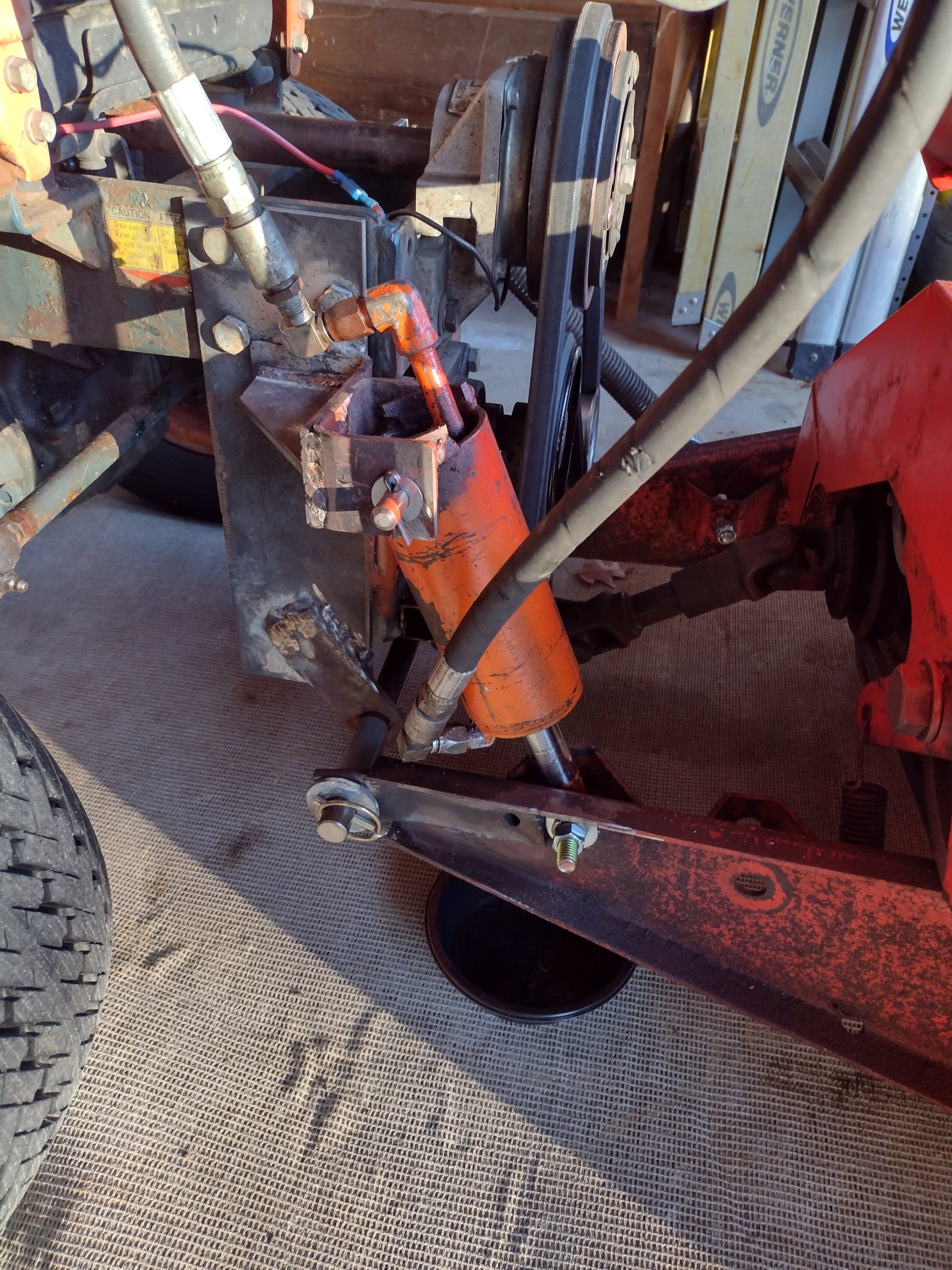

The project is done! Purchased a very good Ariens 2 stage blower (old Kubota one was a single stage) and had to make a reverser (of course) as the new one runs opposite of what the tractor runs. Here are some pictures in no particular order. Also, here is a link to see it run. New video by Larry Hoyer

Thanks, it was a design and build as you go with what you have on hand (mostly).

It looks very good and I hope it will work well!
Hopefully those idlers will stand up to use.
/ B7100 tractor and snowblower
I hope so too. Have extras on hand in case.

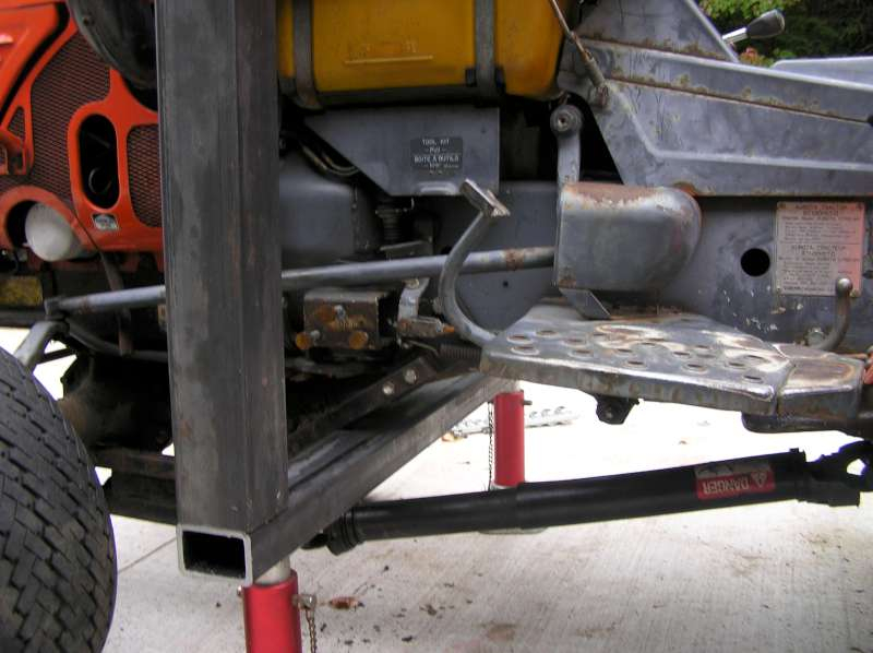

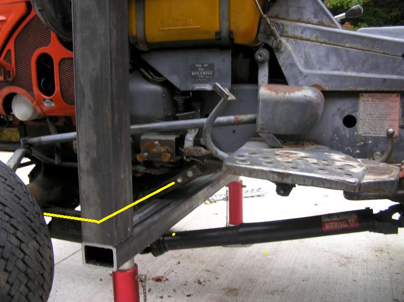

A couple of suggestions for you. I spent a lot of time researching front blowers on B7100 while helping a friend.
The original design by Kubota had solid steel support bars running from the bell housing area of the tractor up to where the blower was attached.
These bars were 1" solid square sections with a bend about mid way along the bar.
I have marked up one photo with a yellow line trying to show you where the bar connected to the tractor. The image is confusing because a loader project was taking place.
If you do not have the majority of the pushing forces applied to the tractor as shown, you can actually break the bell housing.

There are holes in the tractor where the pusher bar is attached. The square bar has a plate welded to the end where it bolts to the tractor.

This appears to be a HST, mine is a standard tranny. The mount for my conversion and the original snowcaster pushed off of the main tractor frame.

I had a similar investigation prior to mounting a front blower on the B7200. I was even warned about breaking the tractor in half by a fellow that did just that. Not the same tractor, but a little farmall.
So I looked into subframes for blowers and blades. Took the ideas, and built with a frame that goes all the way back to the rear axle.
Of course there is a difference in the mid pto output location on the B7200, and the engine drive of the B7100. But that's in the details.
OH! Buy the way, be sure to lube the splines on that engine extension shaft. They wear down to nothing, and replacements are hard to find.

Replacements are almost impossible to find at anything close to a reasonable price. I've been looking. Have always greased with the zerk on the pto drive but this year I removed that to take a look inside. All was good. Shot some grease down the tube, reinstalled and greased with the zerk. Should be good for quite a while. If anything happens to that, the plan is to attach a rear pto pump with an aux tank and go that route. I pretty much only use this tractor for snow removal anymore.

Have used it several times now. It worked well but because of how I had to mount it, I have to shut blower off when I raise it due to the angle that imposes on the drive shaft. Not a big deal but one thing that I have to remember. Originally as I mounted it, the blower raised too high and the short PTO shaft disconnected, fixed that by limiting the raise height and then fixed it permanently by swapping out the original Kubota hydraulic cylinder. If I was to do it over, I have been thinking that I would eliminate the original PTO clutch arrangement, mount the blower closer to the front frame and run a shaft from back PTO to the front. Would still have to fabricate a reverser but back there it could be done with #40 chain. I am going to video clearing up the next snowfall and post a clip of that.
