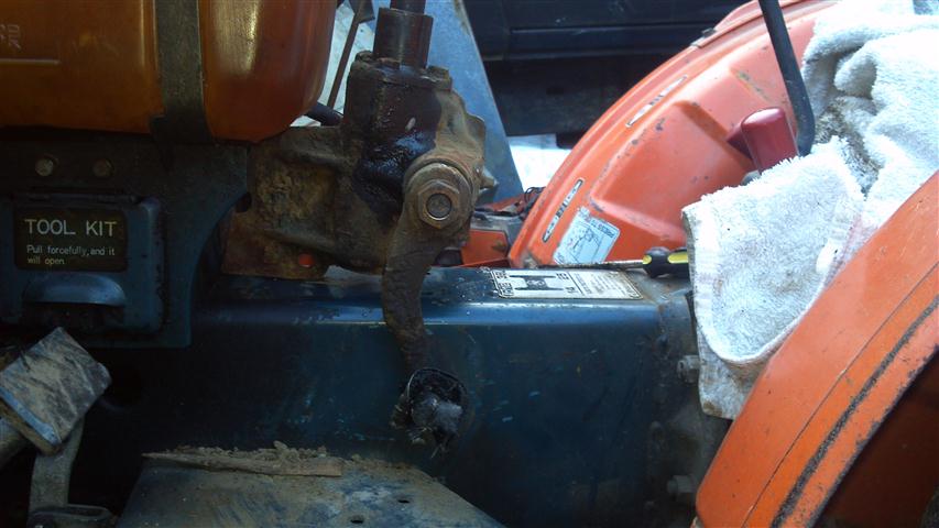

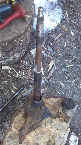

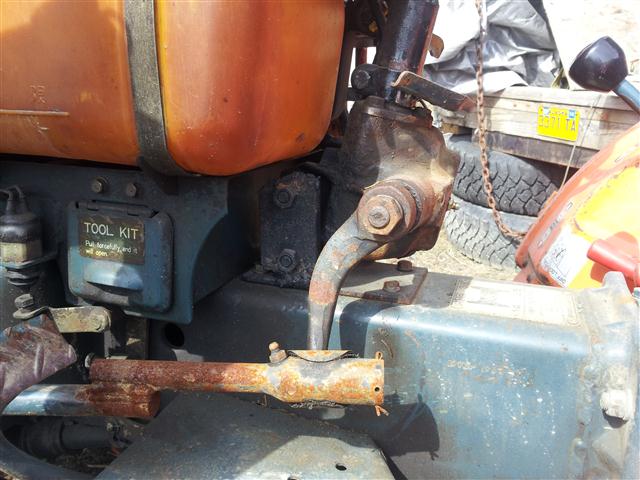

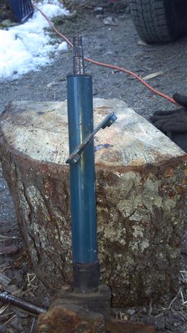

I recently bought a well used B7100 (70's) and after removing it from the collapsed barn it was in and got it home, I spent hours reading on this site about how to fix the steering box. It was apart when I got it with bad top and bottom bearings.
Without too much trouble I got it back together but the Ballnut thing was a little rough. Not bad, but bad enough. It came apart after about 10hours of moving snow and topsoil. I had an idea.
I had just upgraded by daughters CJ3B to saginaw steering and had the old Ross steering box laying in the shop. It has no ballnut to come apart! it has the shaft on the other side but the steering shaft enters near vertical and turned around (from in the jeep) it all swings the right way. It requires building a mounting bracket and removing a small amount of the mounting flange from the box. The ross shaft is hollow and the ID is the same as the OD of the Kubota shaft (fits nicely).
I am not quite finished but enough to know it's gonna work. These steering boxes have got to be stronger than the Kubota piece, and while I am cutting the column and the draglink, it doesn't modify the tunnel. They are also routinely cast off by Jeep guys, so should be cheap.

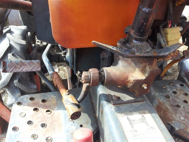

Well, this worked out. The willys box needs slightly more effort than the Kubota box did, but has a longer steering arm and a bit more throw than needed. I may shorten the arm to reduce effort and throw. Power steering may be in the works anyway, and a steering valve (forklift) and ram might replace it.
The box leaked oil a little, so I just tapped it for a grease fitting. No more leaks. Made it through a winter of moving snow anyway.

Barrett: How did you fasten the dash since the ross assembly has no means to mount it? Got a mechanic looking into it but thought you might be able to help, yet again!
/ B7100 steering box upgrade
#12
I combined the upper section of the Kubota column with the lower part of the jeep column. If i remember right, both the shafts slip fit id/od, and the column pieces butt welded together.
