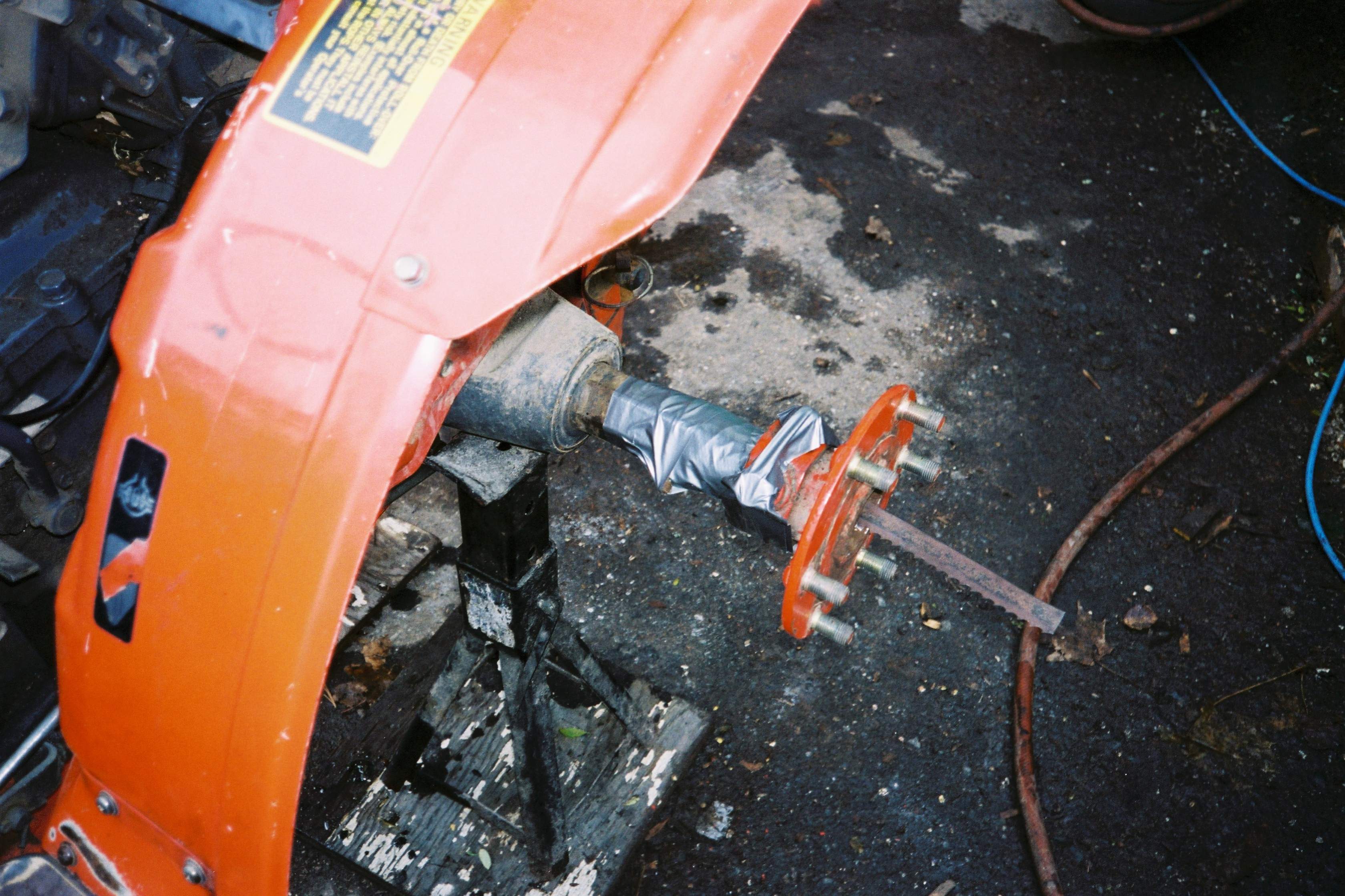

Our B7100 has had both rear wheels fall off about 4 times over the past 2-3 years. The factory part that holds the wheel on the axle is a brass(?) pin with a small spring clip on the end. I reverted to this recently and it lasted about 2 months. Previously I have been going with long bolts and two nuts and they break. Has anyone else seen this? Is the problem that the hub on the wheel is worn? What to replace?

There is a new style hub for the B7100 axles. They work very well.:thumbsup::thumbsup:
I had the same problems. My wheels would tend to go to the inside rather than out and off. I tried shims but they worked out. Finally resorted to putting "Duct Tape" over the inside bolt so the broken pieces would stay in place and stop the tire from moving inward. Finally put the new hubs on and no problems there after.

Like Egon said, get the new style wheel hubs. I replaced mine 2 or 3 years ago and all problems have stopped. It cost around $300.00 for both sides from Kubota to do the job. I recently say the same hubs on Ebay for around $100.00 each.

Thats one sexy looking wheel hub there Egon; Was the adventure worth looking at the stub shafts and how was thier overall condition?
/ B7100 Rear Wheels Falling Off #6
Oh yes. The stubs were in good shape. The original hubs were a poor design.:)
The duct tape worked!:thumbsup: sort of.:)

I found that cutting the spring that was under the tension bolt and tightening to 110lb/ft ended my problems with the loose hub. The spring was bottoming out and not allowing the tension bolt to apply full pressure to axle.

My results using better quality bolts and cutting the spring were not successfully.:(
Perhaps some thicker shims tacked to the hub would work.:confused:

Last weekend I cut shims from some steel flashing I had and put them in. I cut them about 3/4" longer than the mating surface so I could bend up the ends at the inside and outside edgoe of the hub to hold them in place. This took about 80-90% of the slop out, but it still doesn't feel like the bolts are tightening up completely. I'll let you all know about the results.

I tried that using 3/4 in bandsaw blade. Didn't work for me.:)
