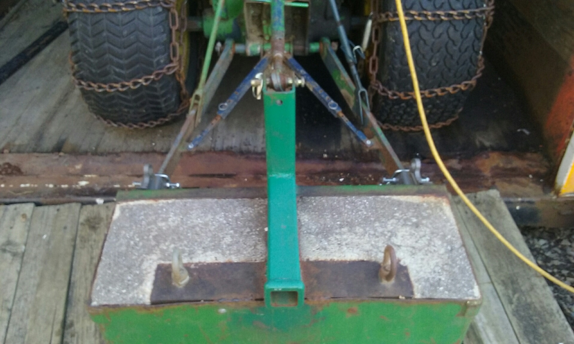

Your right about the lift arms being different. On both my B7100's they are straight with bends only on the ends. I thought the bend at the end is what you were concerned with. I don't think the design of yours would be a problem. I'll have to think about it some more. Here's a picture of mine.
The reason for the green paint it was bought by a Deere employee that painted it John Deere Green one month after it was bought NEW. I have all his purchasing info and he was looking at Deere's and others before getting the Kubota. We call it a Kudeere.

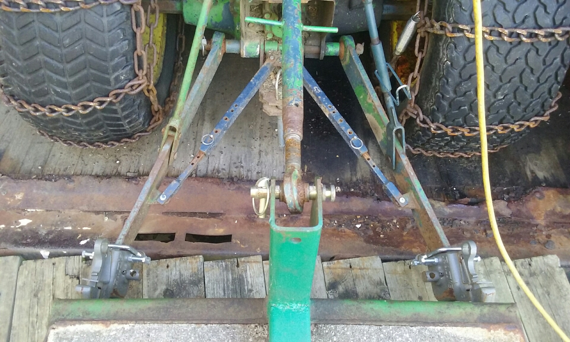

The bend at the end is what concerns me. I think I have 2" or less on my arms after the bend. How far is from the middle of Pat's pin where it attaches to the lower link ball to the tractor end of Pat's?

You don't seem to have gotten a reply so I went out and measured mine. Center of the pin to the back of the U bolt that helps stabilize it is 2 1/8" However the slot at the back is 1 1/2" wide so there is room for a little bend in the arm. Mine is a category 1. If that is what you need you can get it on ebay from Radcliff electric for $169.00 with the stabilizer bar and free shipping. That was the cheapest I found it. Since my tiller has cat 0 spacing with cat 1 pins I had to cut 2" off the inner bar on the stabilizer to get it narrow enough. one of the best accessories I have bought for the tractor yet.

Thanks for the reply. Earlier I didn't get a reply so I bought it anyways and it works fine. My PTO shaft on my RM-48 is still long enough too.
I had to buy a longer top link for my box blade so I can tip it back enough. Sure makes hooking up my equipment easy now.
