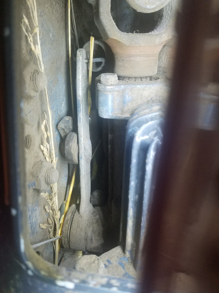

Well in my case, it's the same cause and a little different. I can see where the issue above happened, the V notch slipped off, and wore into the washer holding the bearing on, in the past, but the spring is completely missing, so there's no contact now.
I have a Kubota dealership about 4 miles away, so will head down there and see if they have the parts. Will be nice to have this working again, or at least better than it is now.

Glad we were able to help (in spirit anyway)!
Give us a follow up as to how it works after the new spring.

I have exactly this problem with a B1750HST. Is there anyway to fix this without a rear separation? 20180918_221052_resized.jpg
