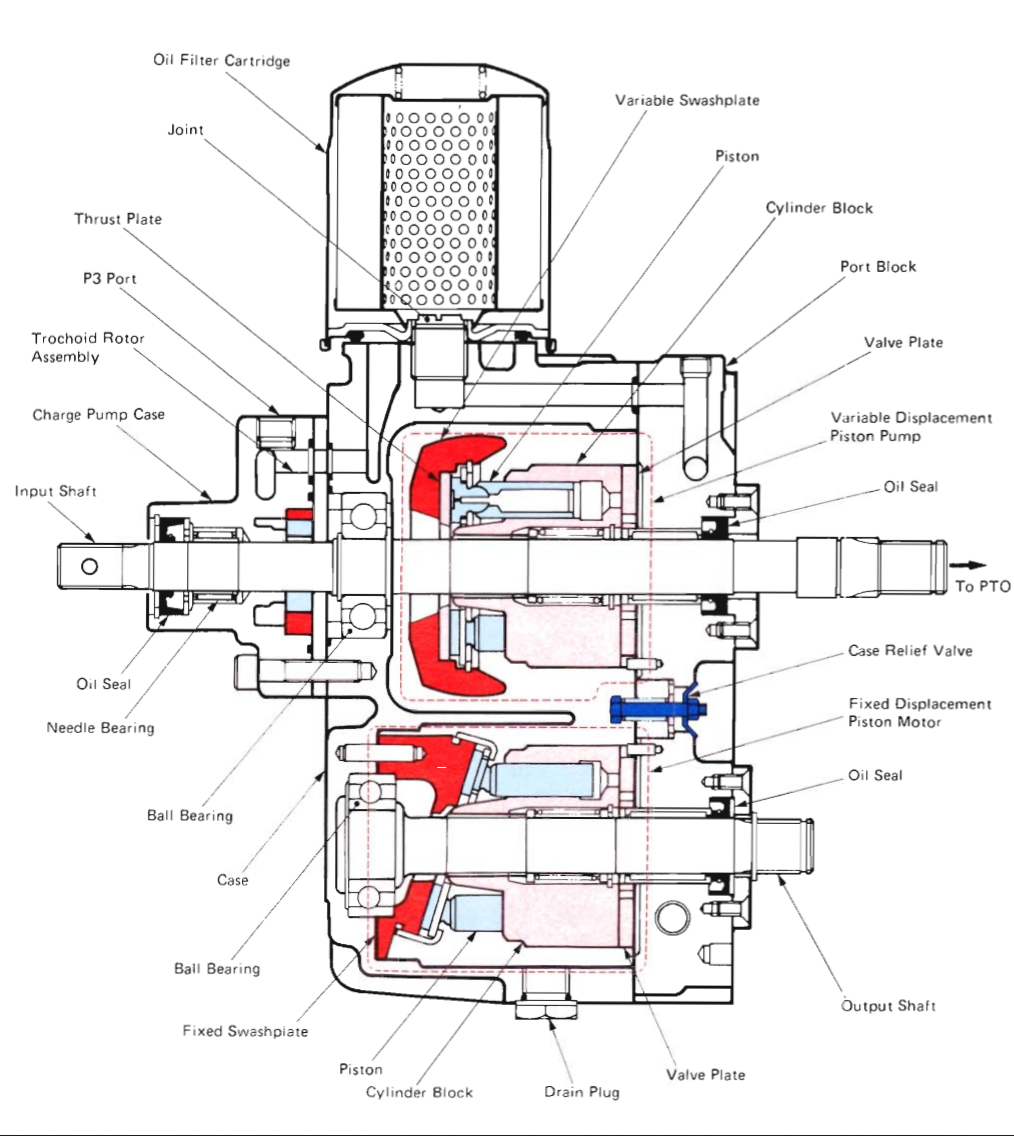

Hey rockyroadnz,
Just in the off chance that you see this, I wanted to say thanks. Your instructions have been a big help.
I'm just having some issues removing the input shaft. I've disconnected the bolts holding the Charge Pump Case on, and can pull the shaft out an inch or two, but that's as far as it goes peacefully.
From what I understand your instructions are saying, it's just supposed to come out the front. Do I just need to pry it out?
Looking at the manual, it looks like there are gears and things attached that should prevent it slipping straight out, so I'm a bit cautious.
And here's the diagram image I'm referring too. Any help/advice would be much appreciated.
Hi ToastySteve, glad the info helped. It is a while since I did this job so the memory is fading. Yes the shaft comes out the front with the charge pump. I definitely would not recommend prying it out. perhaps a few gentle taps on the back end of the shaft but no more force than that. Remember this a precision machined transmission so getting heavy handed will probably damage it.
Looking at that diagram you posted I note that if the shaft has moved forwards an inch or two then the shaft surface for the rear bearing will be about going through the light pink cylinder block. I have a vague recollection that the light pink cylinder block moved around a bit inside the housing when the shaft was removed - so it might be a case of jiggling the shaft until it 'finds' the hole in the cylinder block. Alternatively get someone to hold the HST with the shaft pointing down while you hold the charge pump and shaft together. Then jiggle the shaft or the box and see if it comes out. Be careful to do this on a clean surface so you can see and find any bits that fall out.
I'll dig around in my metal scrap heap tomorrow to see if I can find the old shaft and check the diameter of the rear bearing surface compared to the rest of the shaft. It might give me a clue. Meantime let me know how you get on.
Good luck

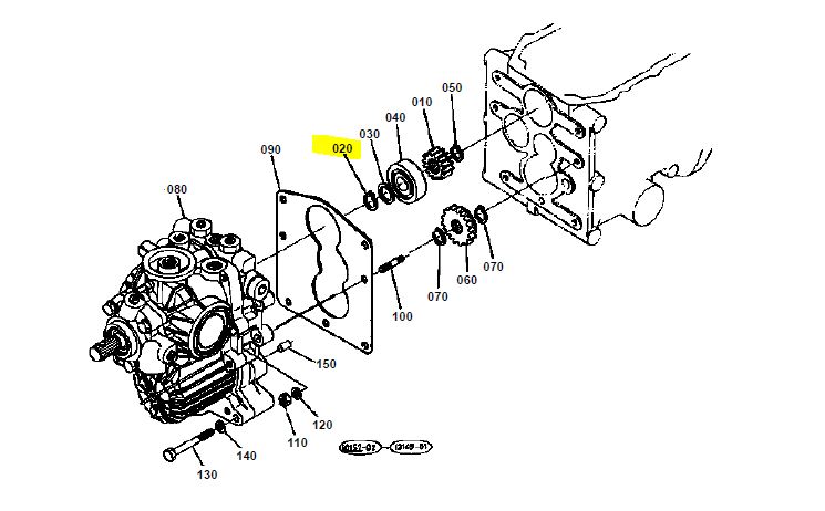

Hi again ToastySteve. One more thought (and sorry if this sounds silly) - did you remove the second circlip I mentioned in step 1 of the shaft replacement instructions? It is number 20 highlighted in this pic HST parts.JPG

Hey mate,
Thanks very much for your help.
I've had a win. I think that I was trying to remove the shaft without removing the whole charge pump... I think I was just removing the front of the charge pump, if that makes sense.
A few more bolts and off it all popped, no worries.
