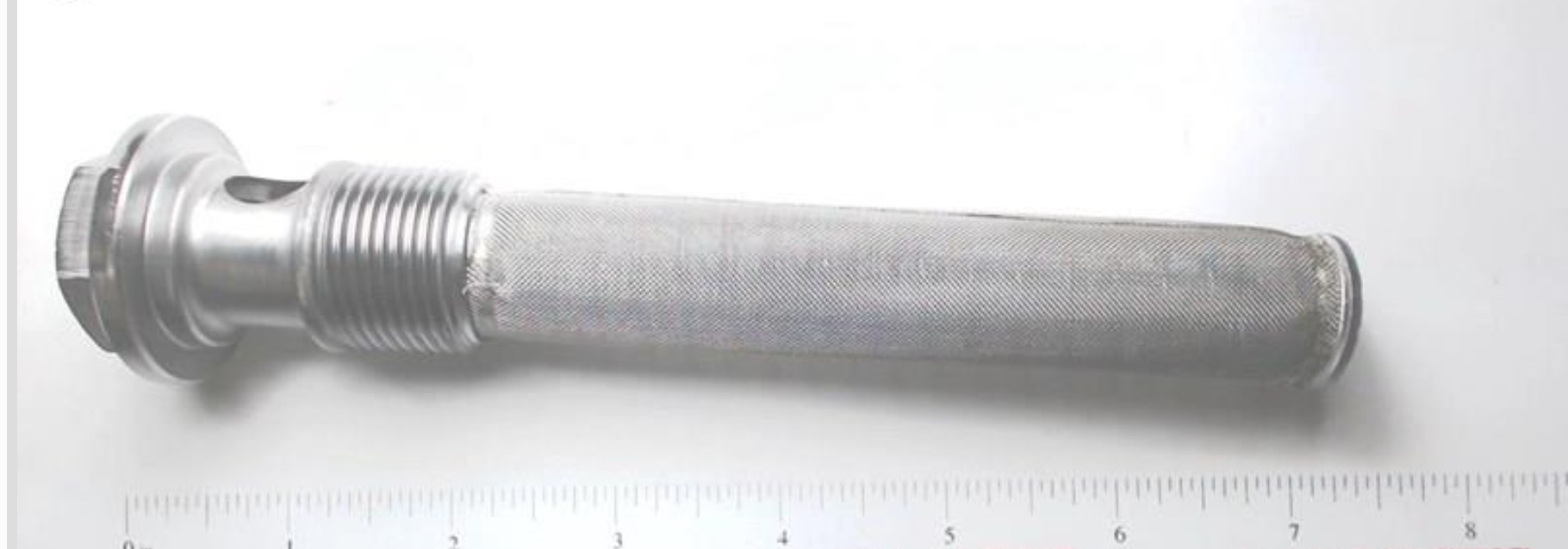

As per the thread below, I ordered new filters, oil and O-rings from Messick's and began cleaning/replacement today. When reinstalling the smaller filter/strainer, the thread jammed about three threads in. After removal and inspection, I think some metal bits from normal system wear and tear were laying in the threads and caused binding. Further cleaning these out have not helped, so I fear the internal thread is is lightly damaged. I assume (spell that "hope") chasing it with a tap will cure it, but I need the thread specs. Does anyone have this info or know where I can get it?

The filter/strainer of issue:
