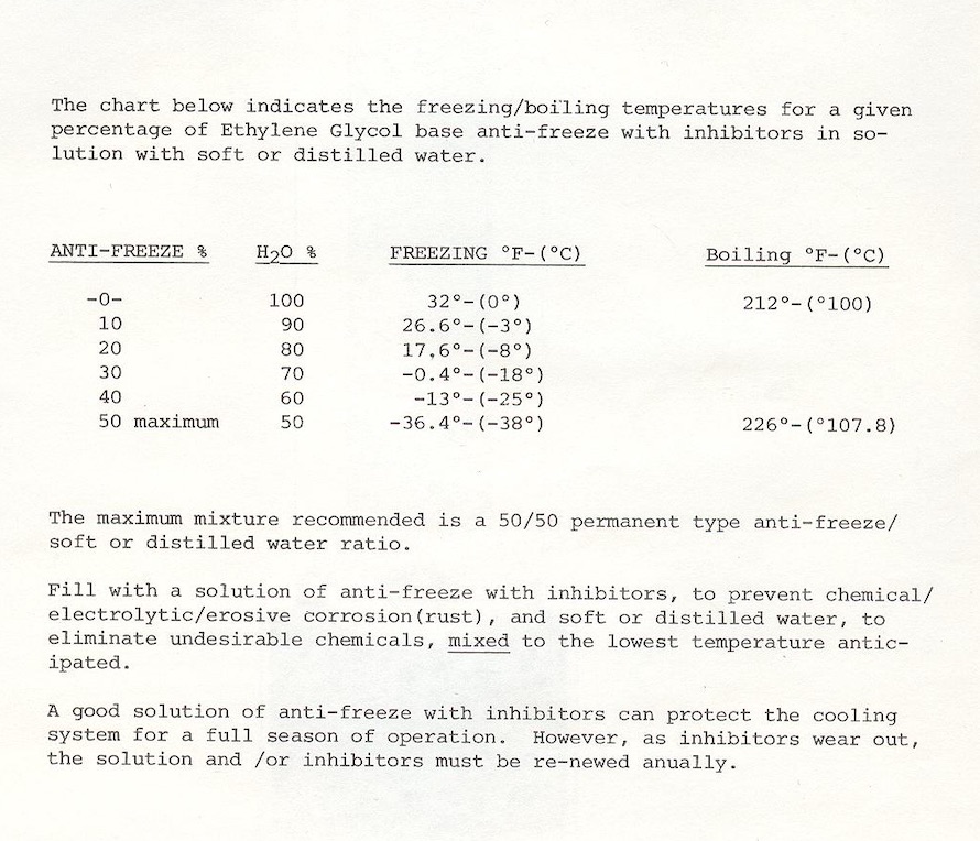

I cleaned my whistle, and while I had the radiator off I cleaned all the cooling fins.
Good. Be sure to use no more than a 50/50 mix of ethylene glycol and water. If your climate is hot, use less glycol to the water. Either use a premix, or I used to buy a gallon of 100% ethylene glycol at the auto parts store and mix it with distilled water. You need to premix and shake it well before pouring it into the radiator. The reason for the distilled water is that you are also trying to keep the inside of the radiator and engine block as clean as possible from any kind of coating.
It's also important to keep a good seal between the radiator and fan shroud to make sure that the fan is pulling air through the fins rather than around from the side of the radiator.
Thermosiphon cooling works pretty well on the flat or going uphill. It suffers when working down slopes that are steep enough to put the radiator somewhat below the level of the engine. That's pretty steep and not usually a problem - especially since the engine is doing less work on a downhill slope. I did overheat mine once years ago when digging along a steep drainage ditch with the front loader. All alone and concentrating on the work.....the blast of steam through the whistle nearly caused me to soil my pants. Back on the level or pointing slightly uphill it cooled down quickly while idling...
rScotty

That's interesting about the heating up when mowing. Does it run hot when going downhill? That's when the thermosiphon is least efficient.
You can help it run cooler by slightly reducing the amount of glycol. The real technical recommended percentage was always 40% glycol to 60% water.... that gives a noticible increase in cooling over a 50/50 mix while still protecting down to about -13 F. We just always said 50/50 because it was easier to measure for most folks.
Resist the impulse to run straight water.... eventually everyone who does forgets to change it in the Fall and the result is a cracked block. That's a much bigger problem than just running hot in the summer. Thermosiphon engines are designed to run a bit hot without damage. Glad to hear yours is doing well. Not sure I'd change much. Those were dandy tractors. Well-designed for intelligent owner maintenance and given that they would last a lifetime.
rScotty
