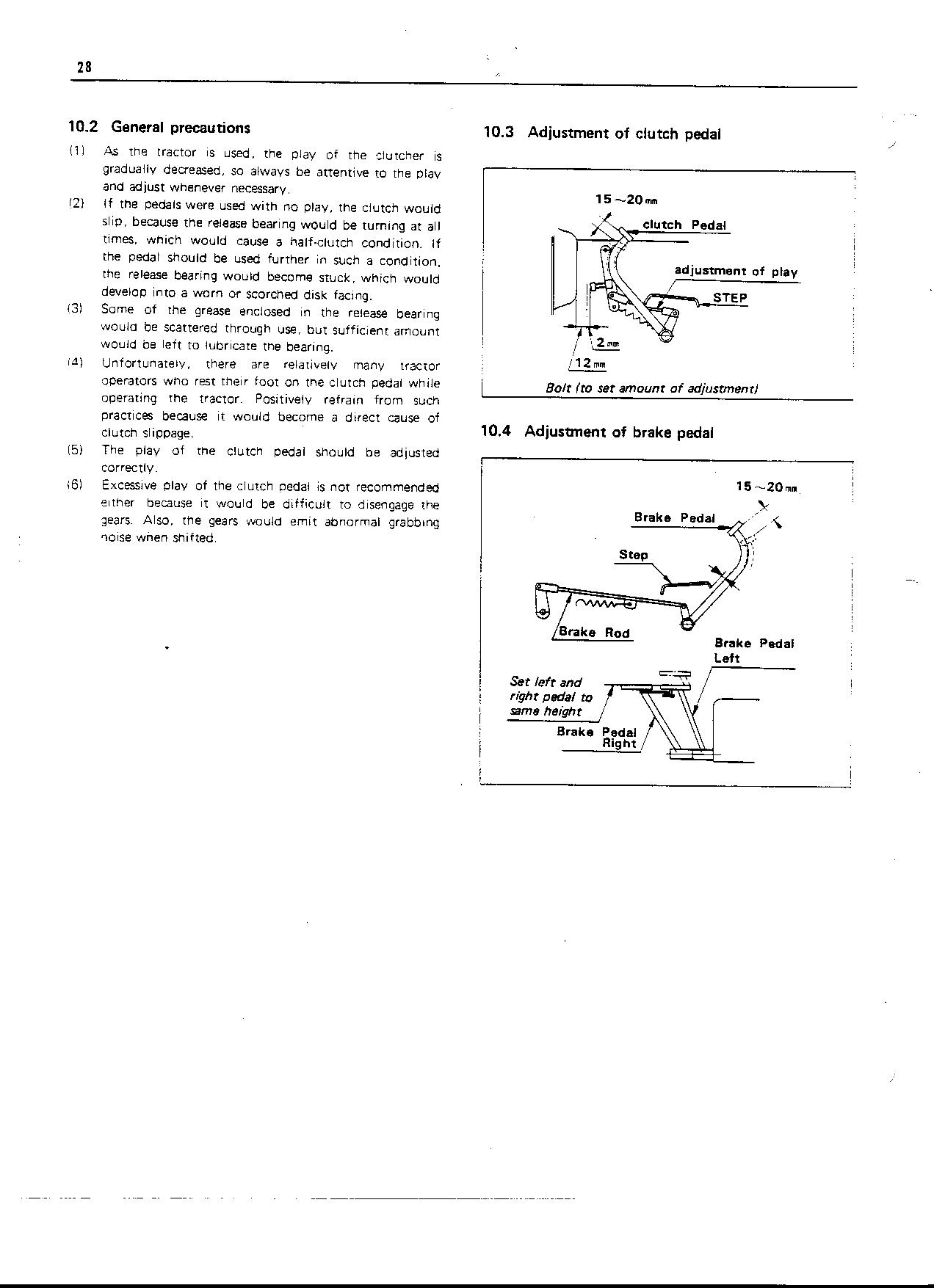

I've got the pedal adjustment all the way out.
This is the part that's confusing me. You say all the way out but it needs to be in farther if the clutch is slipping, not out. Maybe I'm misunderstanding you. If you look at the attached picture, especially 10.3, the threaded rod with the "adjustment of play" arrow is the one that should have threads showing out the end toward the front of the tractor. This will move the bottom of the clutch lever toward the back of the tractor which is what you want.
Sorry for the confusion. I have NO clutch.......it won't disengage. I have to idle the engine down and "slip" it into low gear. It's like the throw out bearing isn't engaging the fingers on the pressure plate. I'm going to copy and print the picture you sent to use once I get this figured out.
THANKS!!
