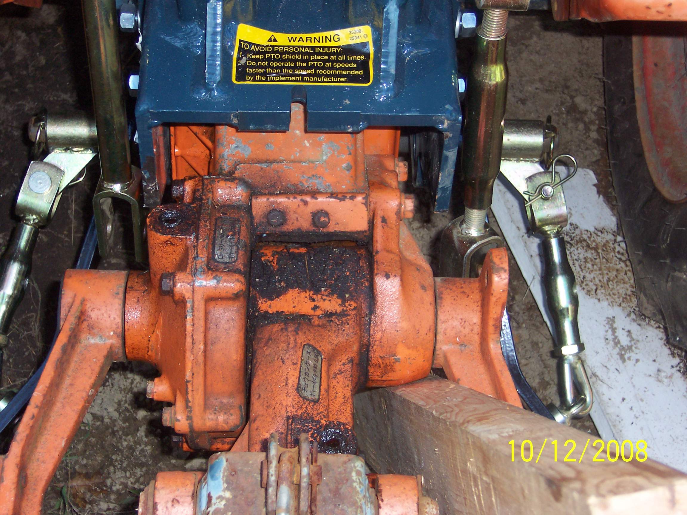

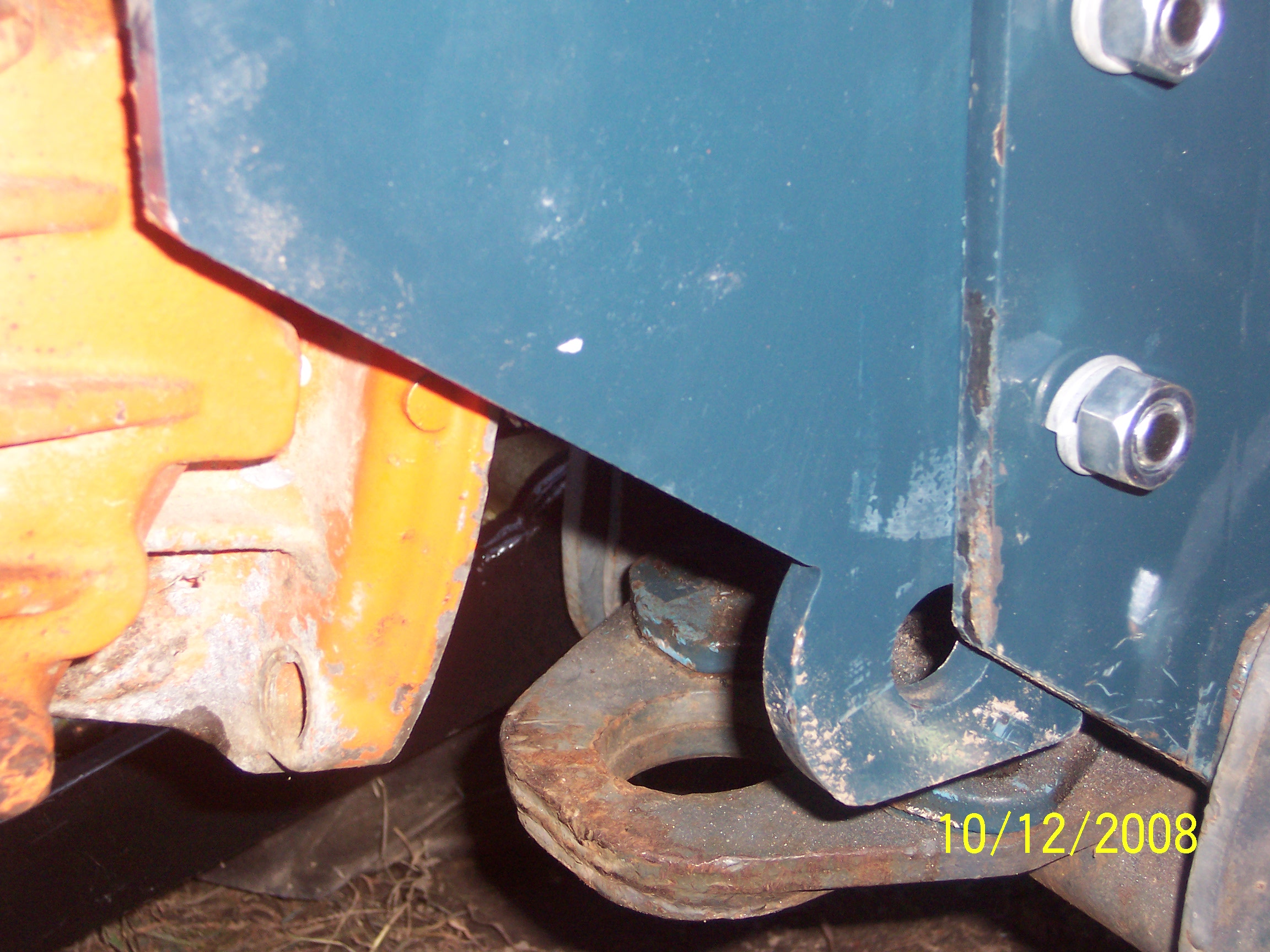

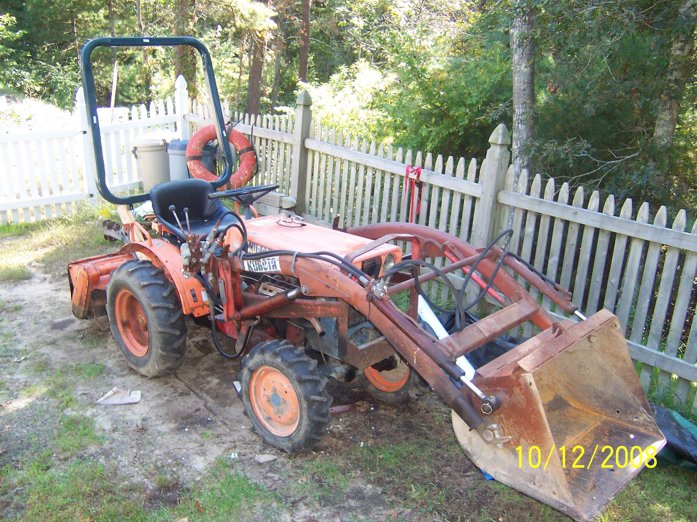

/ B6000E ROPS #7
More ROPS problems.
I put my ROPS on. I agree the instructions were sort of vague, but it is a CLOSE fit tolerance wise.
HOWEVER, the "adapter" bracket and the ROPS frame make my original "reverse" rototiller not fit.
The area between the bracket is about 1" too narrow for the hinge of the tiller to go into to 'face' up to the rear of the transmission housing. It is about 6" too far away to get close to the mounting bolts.
The only idea I have come up with would be to get a piece of 6" heavy channel and make two brackets to mount the tiller on, extended out further from the pto mount. (provided I can find a 25mm 18 spline stub shaft extension)
Anyone got any other ideas?
