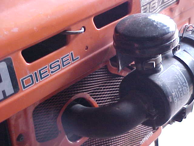

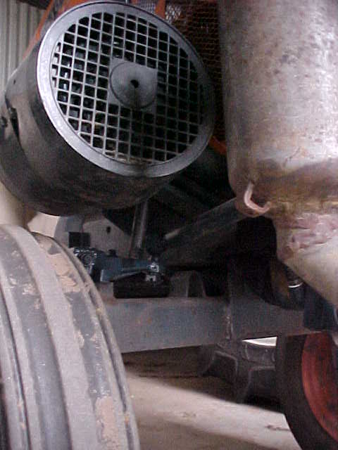

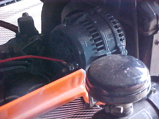

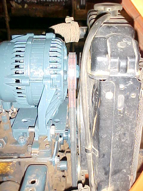

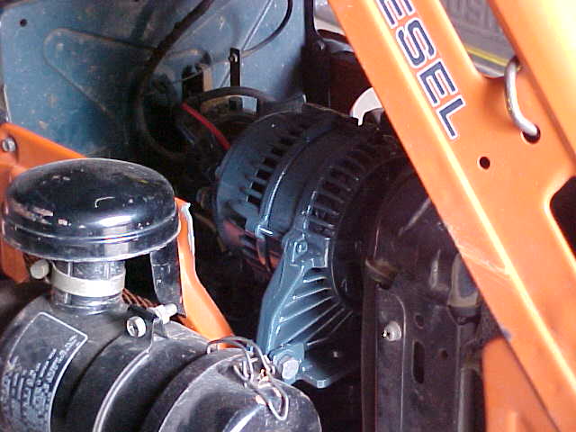

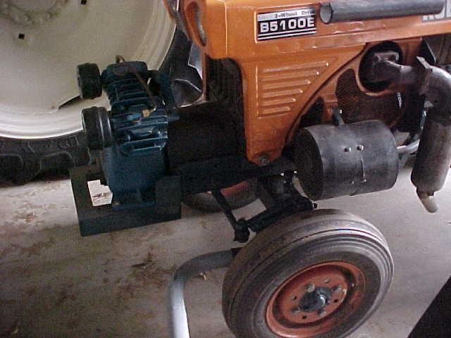

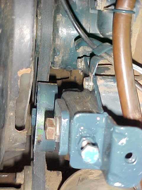

/ B6000 Dynamo question #9
MVC-548S.JPGNo need to apologise for owning one of these.
I expect these tractors will be performing reliably long past me.
Never known the magnets in the dynamo to give out though, I would have suspected the AC/DC Rectifier behind the dash - but they're not inexpensive to replace either!
If you take the fan belt off and turn the fan manually - is it jumpy as it ought to be?
I've fitted alternators to a B6100 (as I use it to tow a 12V sprayer and dynamo doesn't have enough output) and a B5100 where it powers a magnetic clutch to drive a compressor (likewise, not enough output).
Did the 5100 first and mounted it outside the LHS panel, the belt goes under the jockey pulley (fitted a flat face over the V belt groove) and then up to the fan pulley. Changed the tightening bolt so it now pushes the jockey in.
Also fitted a couple old TEFC elec. motor fan covers over the alt. to keep most of the rain out.
See the first three photos.
Did the 6100 second, my brother convinced me it could be fitted above the engine on the RHS. Had to cut away the bit of the side panel that gets covered by the hood anyway, to fit it in. Also had to bend the injector pump output lines a little.
Once again changed the jockey to pushing in (a bit lower than it was) to gain proper contact with the fan pulley and tightening.
See the last five photos.
Both are Bosch 85 amp alternators, made in Australia, as fitted to Holden (GM) Commodores which are exported to the US as Pontiac GTO's I think.
Did consider direct coupling to the crankshaft front spline but weren't sure if the alt. would work in reverse and I'm still thinking about fitting a magnetic clutch there to drive an outfront mower.
