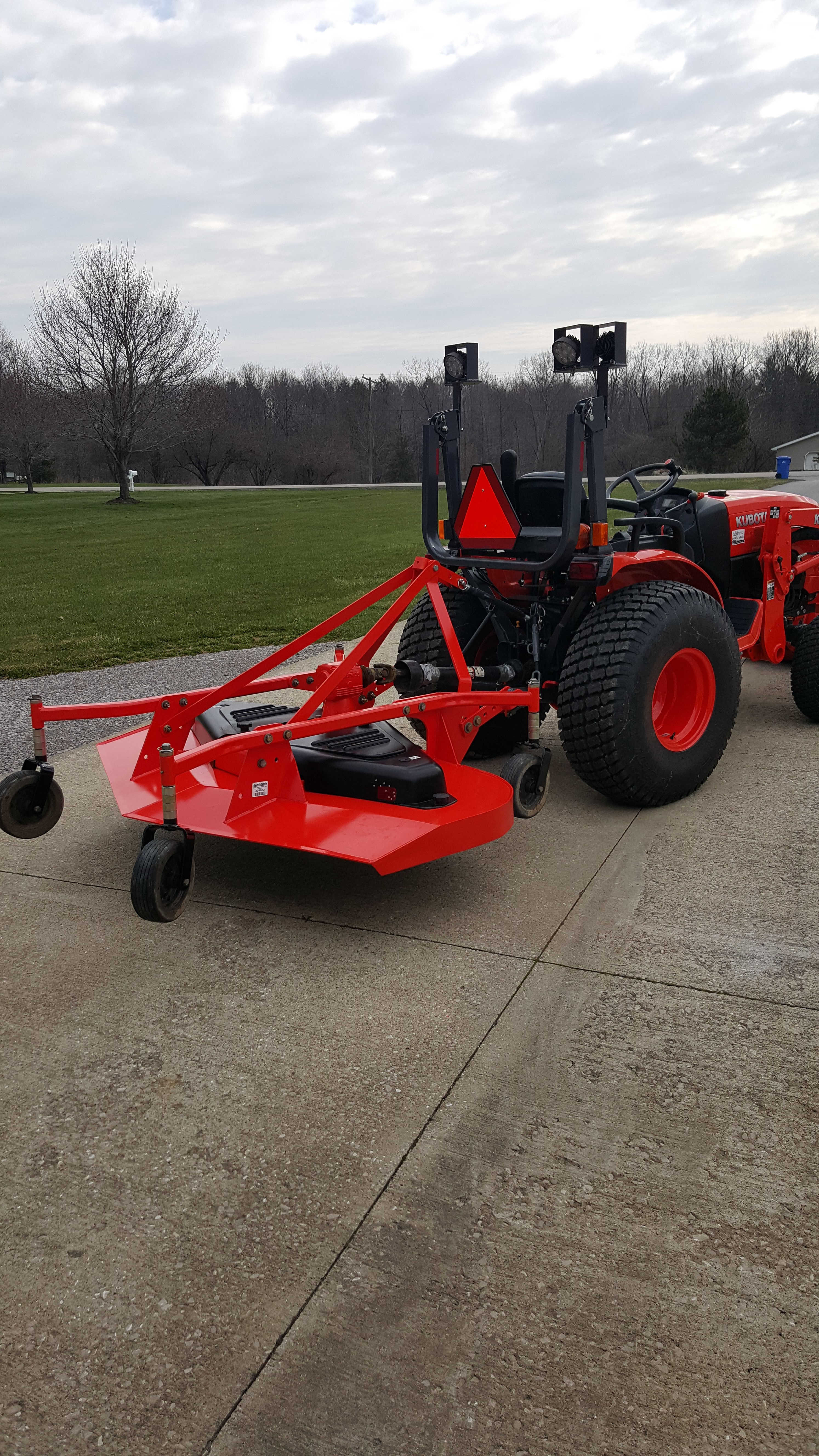

I'm using my B3200 for mowing my lawn. I have turf tires and the rears are loaded. I normally remove the FEL but sometimes I only remove the bucket. I'm cutting with a MMM. The tractor normally does not leave ruts unless it's very wet conditions. In the areas where I turn a lot, there are marks. This is mainly by the rows of trees that I have. The marks are from the front tires always turning in the same place. I'm cutting close enough to the trunk so I do not need the push mower. The B3200 does ok, just not nearly as well as my BX2660 did.

I've been happy with the the B2650 in 2 wheel drive with the 72" mmm on turfs. Nice cut although this year I'm fitting it to G6 Oregon gator blades and just completed fabricating and mounting a discharge outlet cover for mulching and close in mowing by sidewalks.
