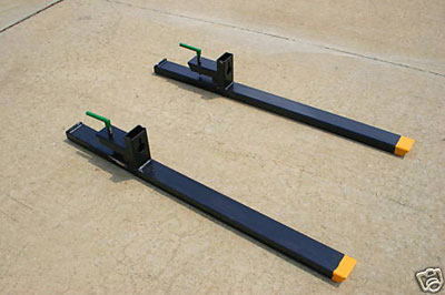

If you are only looking to lift 500 lbs, and if you are not going to be using them that much, I would consider saving yourself a lot of money and buying a set of chain on forks.
They can be had off Ebay for $150, and they work well.
I have a set that I have used for moving hay between barns (hay on pallet), moving fence posts, moving cut logs, and picking up a pallets of coated fence material (close to 700 lbs....at the extreme edge of the lifting capacity of my tractor).
With the ratcheting chain pull, they go on in a couple of minutes, and come off more quickly.
The only major disadvantages with them is that the weight is further forward, reducing the lift capability. But if you max at 500 lbs should not be an issue.

To the OP: If you're keeping the tractor for years to come and only want to mess with forks one time, avoid clamp ons. Been there, done it and was sorry I spent the money. But they were Payne's and about twice the price of Titan's. Expensive lesson learned.
This is in no way a knock against Titan's product, but here are my experiences with clamp ons:
• The screws made nice dents in my bucket bottom.
• Poor/no visibility.You simply cannot see your target through the bucket.
• If you don't hit your target squarely the forks will kick sideways on you. Especially if you put a piece of steel between the screw and your bucket to protect it.
• As someone else mentioned, clamping to your bucket puts the load that much farther out from your lift arms, reducing capacity. You may think that you don't need max capacity at this moment but there may come a time in the future that you'll need or want to lift more.

I would absolutely agree that COF's are not always the best option. But, in some cases, they are the perfect option. Our clamp on forks are a very good quality product at an extremely good price.
With that said, no doubt I would prefer a structural steel fork attachment with forged forks. Solid and handy! You'll have em' forever and you'll love em'.
