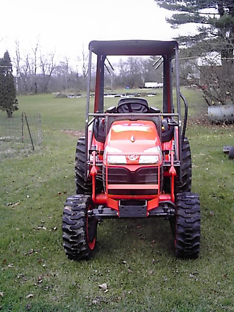

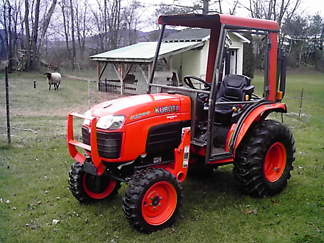

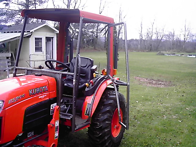

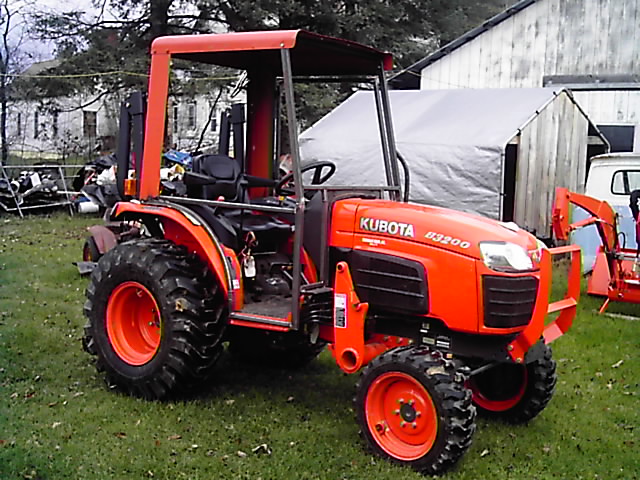

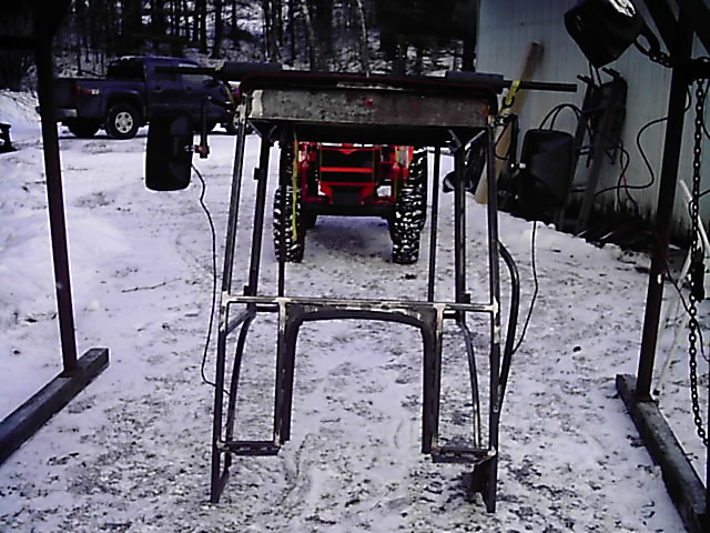

I started this prodject back in Sept and have been waiting to post untill It was done but I am looking for some motavation to get myself working harder on it. I will post a bunch of pictures and hope to take many more as I finish this thing. Any way here they are let me know what you think.

I thought I had more pictures than that. Guess I will have to take some more in the morning. So far I have met my objectives and they are to have a nice fitting cab that can be removed for summer mowing. I picked up some of the glass last friday. I had tempered glass custom cut for the two windows and the panel below the right hand window. I also had a piece of laminated glass cut for the windshield. The total so far for the glass is $398 I hope to cut some laminated glass that I already have to fill in the rear side windows and the lower windshield sections. If all goes well I think I will have tempered glass cut for the door as well.

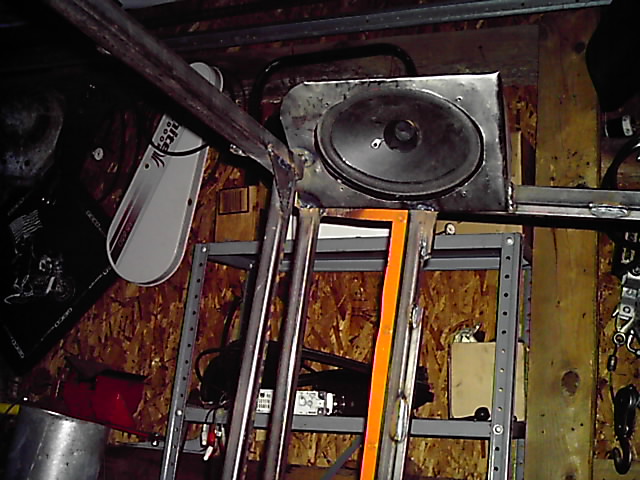

I am currently working on the frame for the rear window. I still have to finish up the mirrors and I am working on a radio and switch panel. I made speaker mounts last week. I really need to take a few days off from work so I can get closer to finishing this cab. I only get one day off a week and by the time I get home from work I have little motovation to go outside and work on it. I sure wish I had done more when It was warm out.

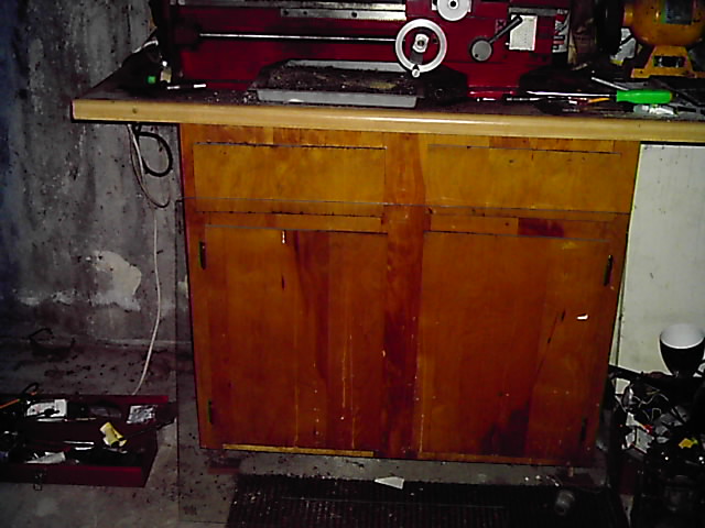

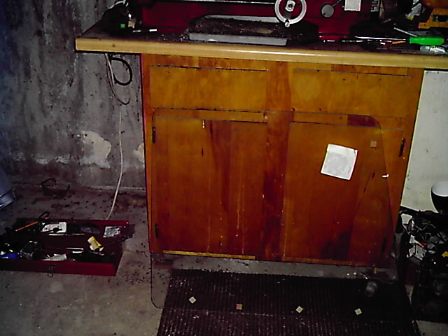

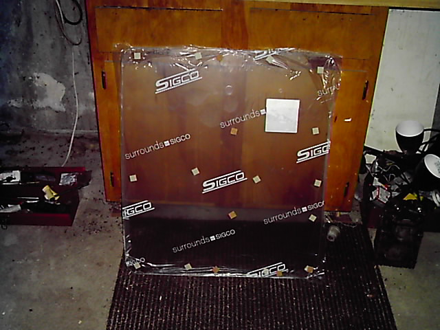

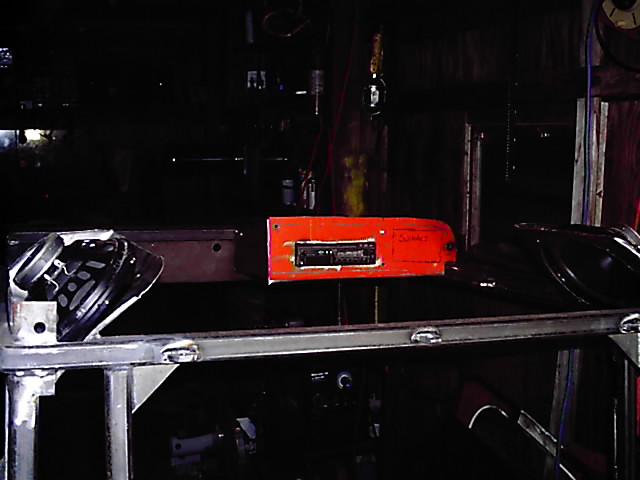

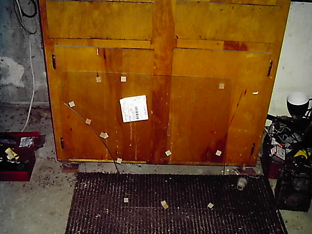

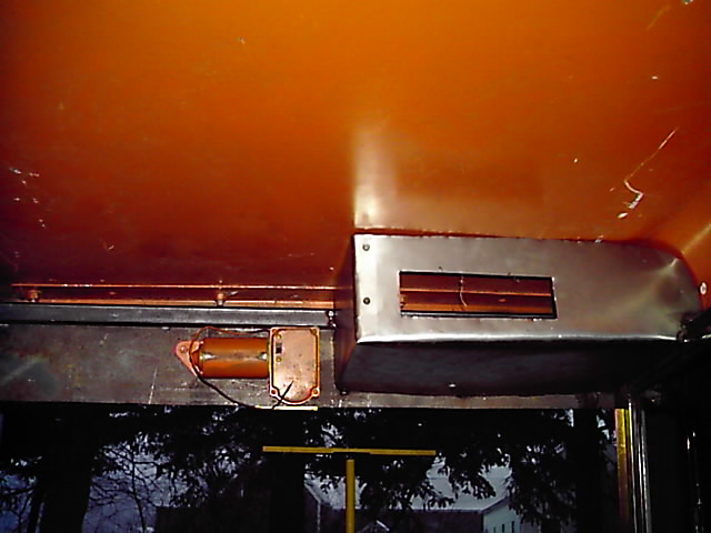

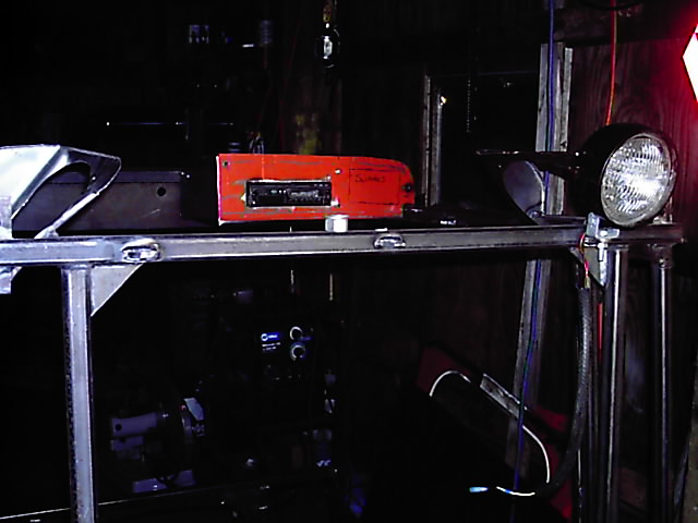

Ok as I promissed here are some more photos of the cab. I was able to work on it this morning and got a lot of loose end taken care of. The first shows the box I am building to hold the radio and some switches. You also can see the front windshield wiper motor. It came with the original curtis cab. The next 4 show the glass that I bought so far. It is so clean that it is hard to see. The first one will be the rear window and is drilled for a wiper motor. 2cnd is the side window. 3rd is the lower right side I like this one the best with its nice curve. Last is the windshield I was going to have this one drilled for a wiper but the glass man told me not to do this so I had to change the design so that it would work with this glass. I have more pics but the work shop is so dark that they are not clear enough to post so I will need to take more later.

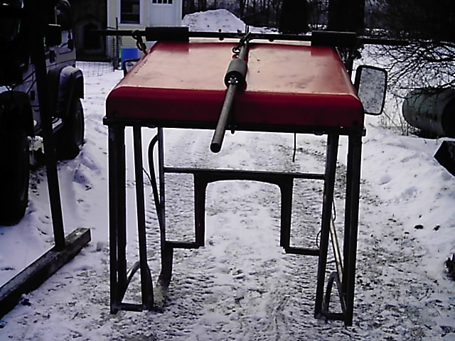

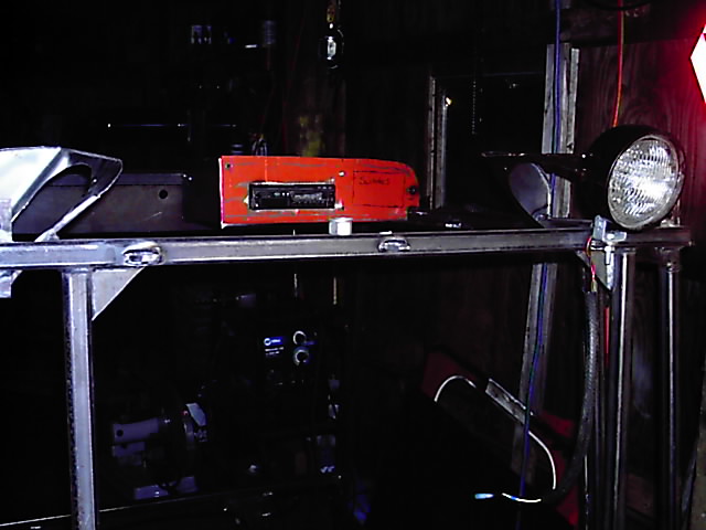

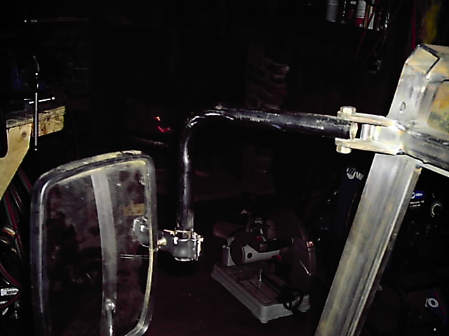

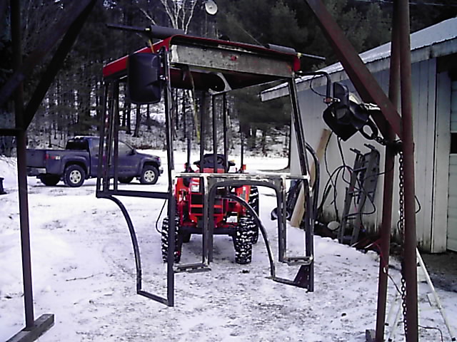

I had a fairly productive day. I would think another day like today and I could start getting ready for paint. I got the radio and switch mounting plate set up. the speaker boxes are mounted and I got the mirror mounts welded up. and the rear light mounts are made. I still need to make front light mounts. I spent a bunch of my time today fixing the mounting holes for the cab. I slotted the holes so that there will be some adjustment now. It would have been much easier to have just done it right the first time. I will need to do some work on the rear of the cab to get it ready for glass installation and I want to build better hinge mounts on the cab frame.
I want to paint the cab the same color as the roll bar. I talked to the kubota dealer last week and its $12 a can. I wish I could spray it with a paint gun but I would need a better place to do it than my work shop.
