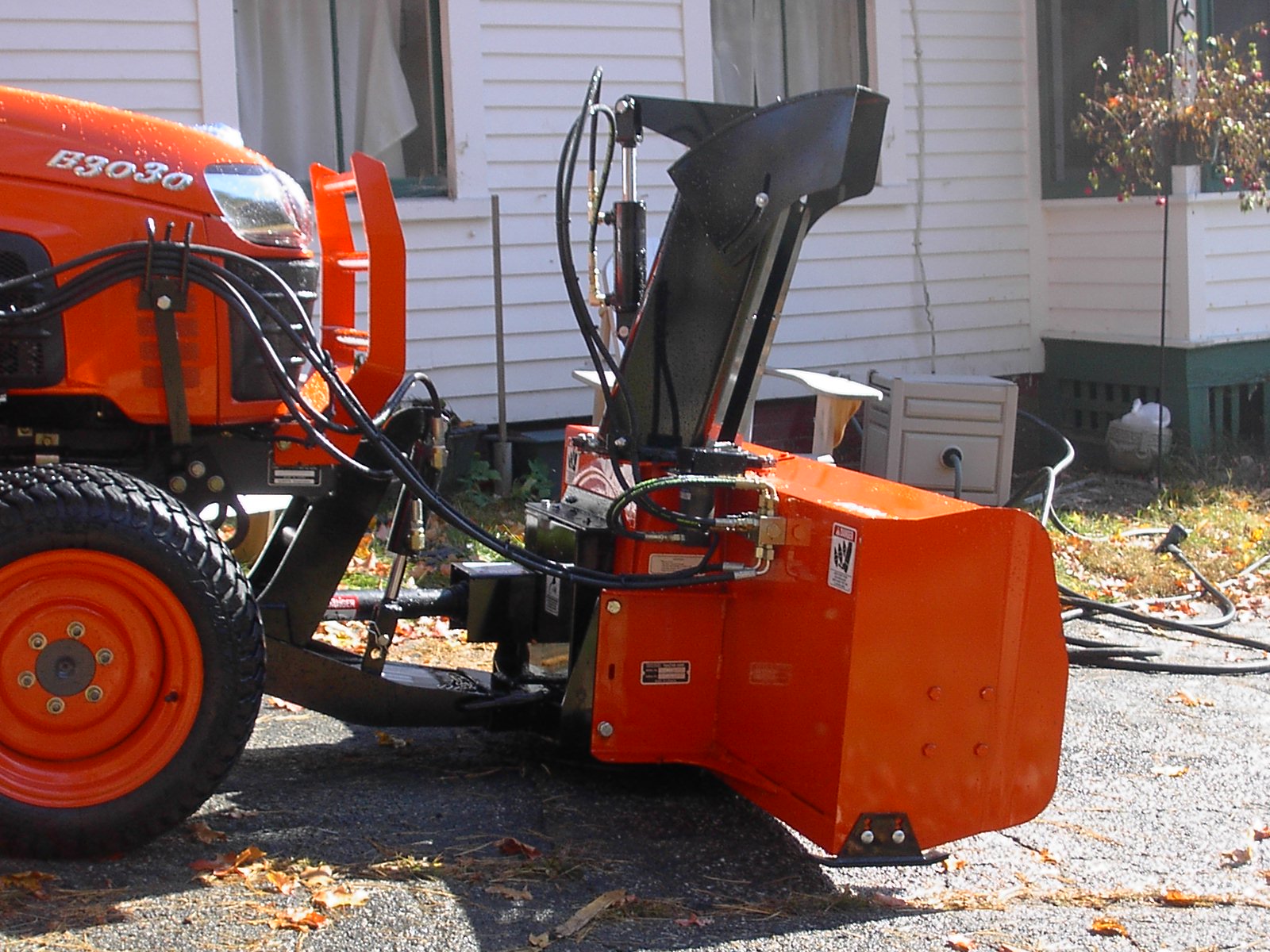

   / b3030 snowblower #7
Can't help with the electric kit because I installed the BL2666 hydraulic chute deflector kit on mine. I considered the electric, but even though the hydraulic kit is more than twice the money...... i figured it was forever. I feel its the cats meow, and as with all factory Kubota accessories, it is complete down to every nut and bolt.
