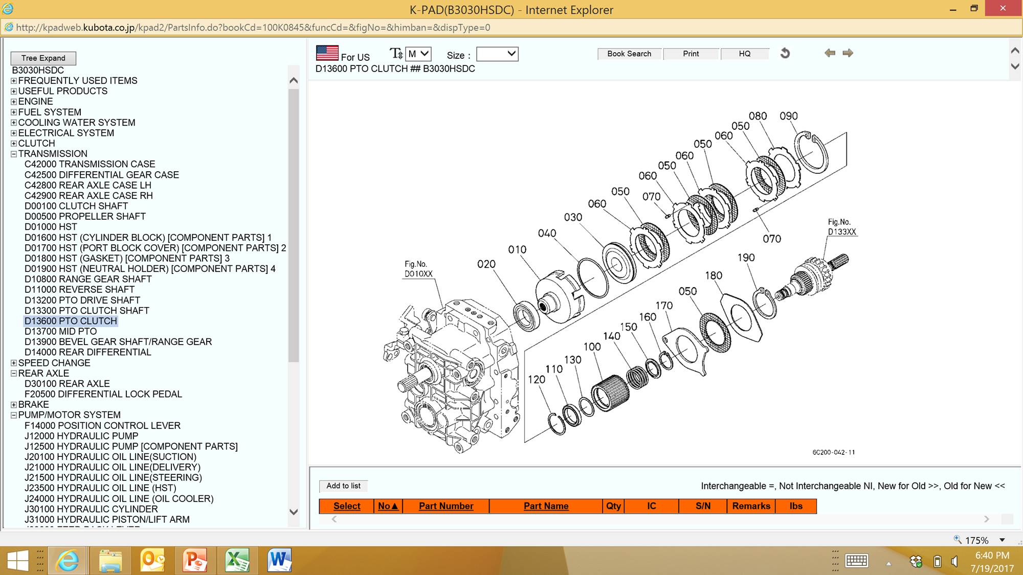

Yes, they do have clutches for the PTO output.
KPN: 6A700-13750 DESC: DISK,CLUTCH QTY 5
KPN: 6A700-13762 DESC: PLATE(CLUTCH,1.2) QTY 4

Here's the exploded view in the event it helps your understanding.
