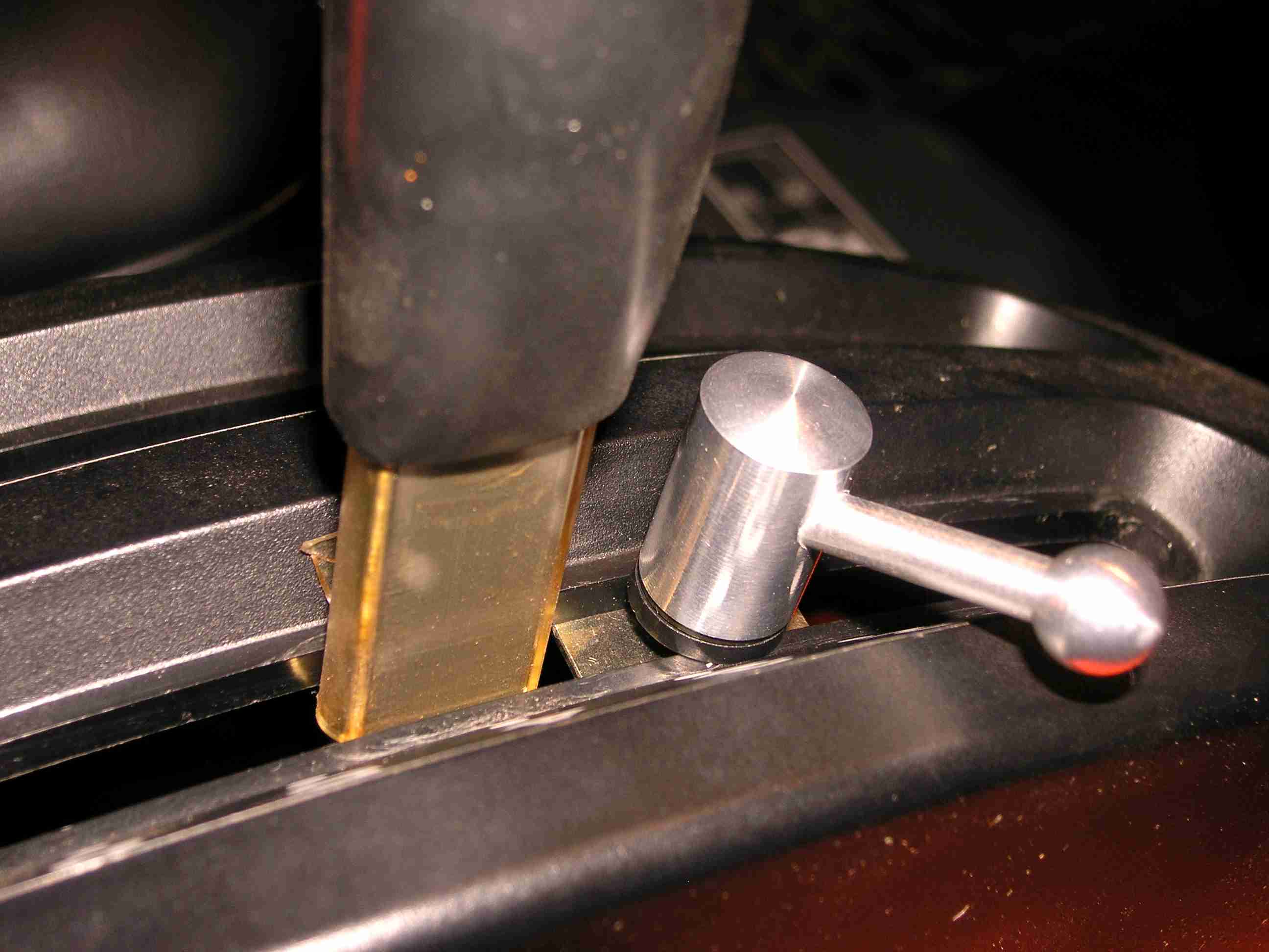

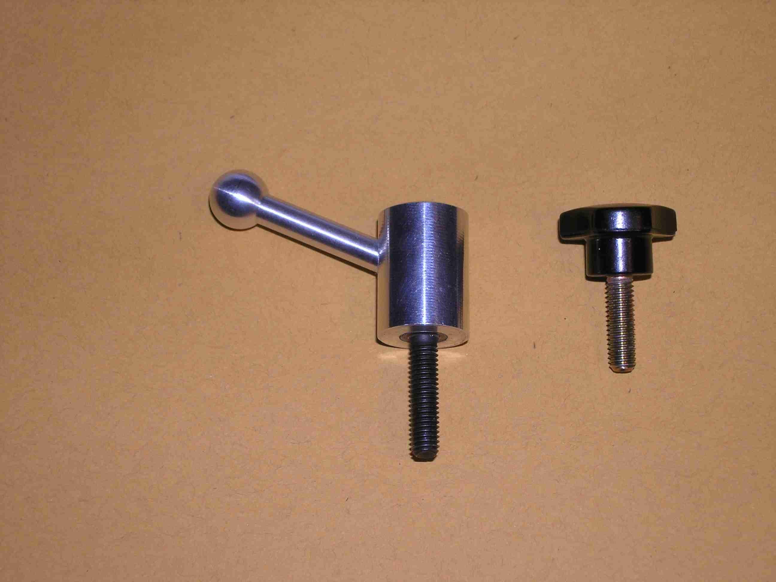

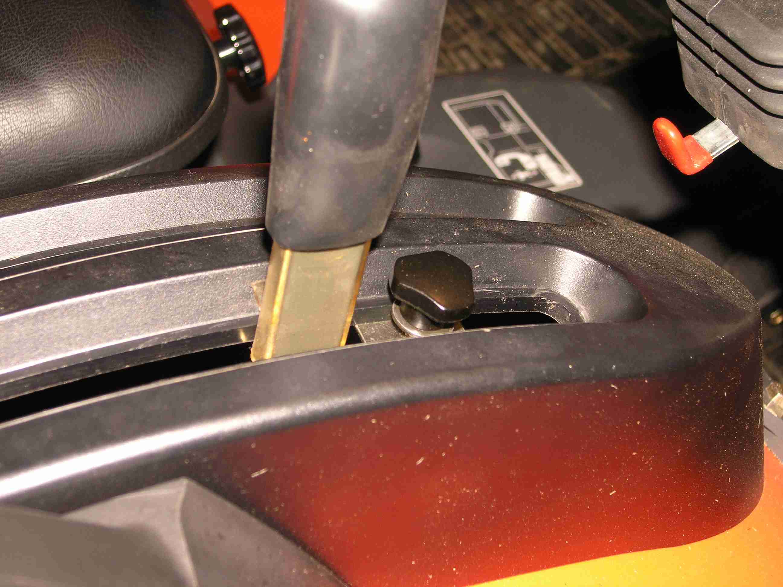

I didn't like position control lever stop knob on my B3030, so I whipped up a new one on my lathe. The original is difficult to get at.
I added a hard rubber/plastic washer under the knob to cushion the contact with the plastic frame assembly.
Works great and is easy to adjust now..
Attached is a before, after, and comparison of knobs..
Dan

That looks real good. I know what you mean about it being hard to turn. I put a couple of extra washers under mine. It helps, but could be better.

Probably not being politically correct here (What's new) but, the little Japanese guys that designed the stock knob probably thought it worked pretty good. With our big American fingers it is not as easy get a hold of it and tighten it.

schmism said:
hate to spoil it for ya... but their is an off the shelf knob almost exactly like that for about $5.
even "ratchets"
Ratchet/Ball Knob - Rockler Woodworking Tools
Dang It Danbuf!!!! Someone beat you to it, sortta!!! I still like yours though, it's a lot more stylish and durable!!! Probably be hard to produce for $5 each though!!! :(

I was aware of commercial knobs that could be adapted.. But, what fun is that? :eek:)
Might be tough to find just the right knob with 6mm screw, etc..
I love using my shop equipment and, mine was designed around the application.. So it fits perfectly..
So in winter months when I can't get any seat time, I can get all the shop time I can squeeze in...
