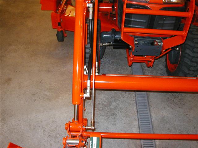

This was an idea I borrowed from this forum. It's nothing new I just thought I would share it with everyone. I haven't painted the inside rod yet. I just got it on tonight.I didn't want to weld on the loader so I drilled and tapped the curl cylinder pins.

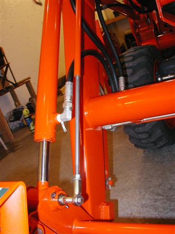

2nd Picture

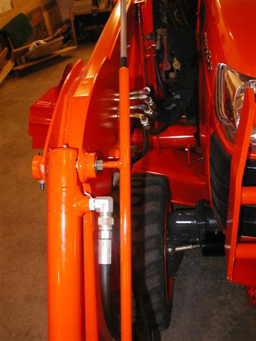

3rd picture

Yes parts are cheap. I bought the rod end from McMaster-Carr for $5.00. The rod and tube was some scrap from work.
   / B3030 Loader level #6
Tough to beat that price. I may have to look around and see what I have for scrap. /forums/images/graemlins/smile.gif
