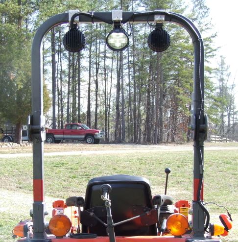

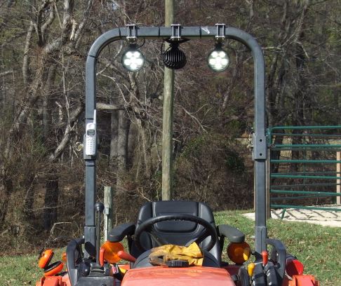

I'm quite happy with my light job on my B2630 (pretty much same as your B3030):
The ROPS clamps are from Messicks, went on easily and well. The lights are super-bright LEDs from Truck-Lite, purchased online from Ryder Fleet Products. They draw only 1.3 A each, so wired right in without overloading the circuit or my alternator. Not quite as bright as big-ole incandescent or halogen floods, but plenty bright enough. Pricey, though; $98 ea. OK by me; I'd do it again if I had to. I wired the lights into two weatherproof rocker switches from a marine supply store.

   / B3030 Alternator Kit? ROPS brackets? Lights? #9
Here's my setup (B7800). These are automotive driving lights (didn't like the floodlights). I'm running it off of the original dynamo, no problems yet but I'm running close to the max the thing can put out. These things are amazingly bright!!! I will be upgrading to the alternator soon, just because I like the extra ooommph it puts out, especially at lower rpm's.
