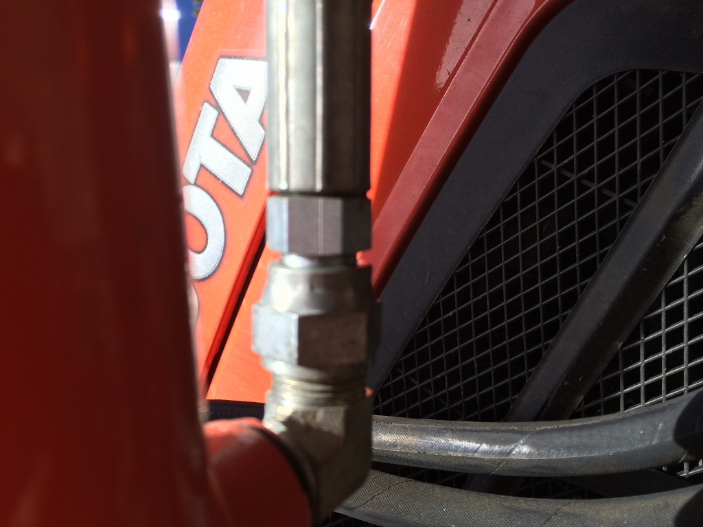

Ok, I'm stumped. Last weekend, after running my flail mower for a couple hours, my loader boom stopped being able to raise after I finished mowing. All other functions are working fine - loader boom lower under power, bucket curl & dump. When mowing, I do have to raise & lower the loader often to get around trees, etc, and all was fine while mowing. Initially, the loader boom raise issues were a bit sporadic, but I could not duplicate exactly how to fix the issue. It started out that if I dropped the loader all the way to the ground in float mode to remove any line pressure, I could then raise the boom back up, but that "trick" doesn't seem to be working on a regular basis. Hydraulic fluid did not seem to be too hot, as I've noticed in the past (odor) while running the backhoe for a few hours on a hot summer day.
I can get the loader boom to raise only occasionally, but there seems to be no rhyme or reason behind what works to "reset" and what doesn't. I checked hydraulic fluid level, and it was fine. Hydraulic fluid is still about as clear as when it was last changed at 100 hours. Machine has 175 on it now, and is not due for fluid or filter change quite yet.
When the issue occurs, the loader valve seems to go into bypass mode, like you hear when the boom is raised all the way to the top before releasing the joystick. The boom will raise about a half inch up the hydraulic ram, then stop and go into bypass mode. No change removing 3pt implement (wondered if the load and the 3pt valve may have been affecting things).

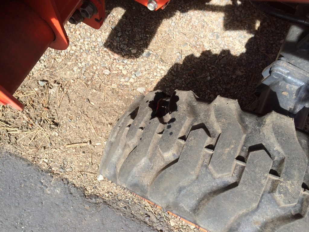

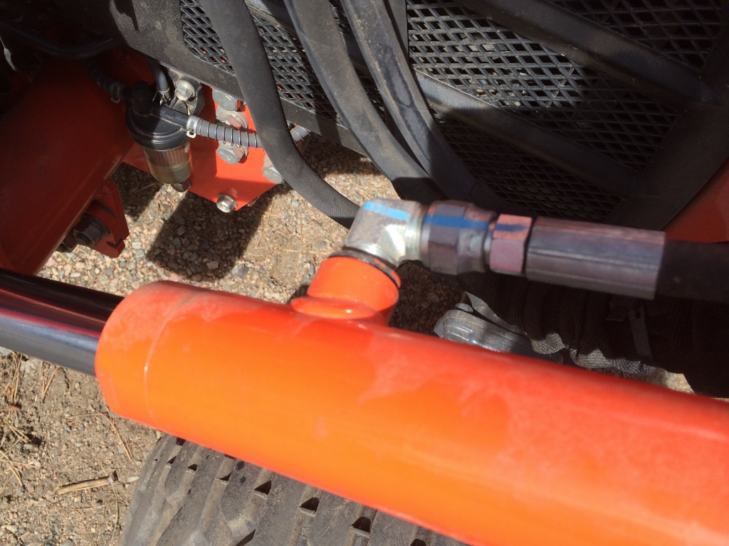

While messing with it this morning, I did get a leak at both boom ram fittings at the same spot on each of the hydraulic lines at one point, and thinking that was the problem, I wiped the fittings off to determine exactly where the leak was, and then no more leak. That one instance today was the only time I have found any hydraulic leaks over the last 2 weekends worth of messing around with it.
I unplugged the hydraulic fitting at the loader valve just in case there was something going on there, but that didn't appear to be the problem. Also checked the rear fitting at the back where I hook up the backhoe. Backhoe has been off since last fall. Loader has only been off the machine once a few years ago after I got it, just so I could say I've taken it off at least once.
Any suggestions?
I've included a couple pics of the one-time fitting leak that I so far have not been able to duplicate. The leaks (onto the tires) happened after lowering the boom to raise the front tires off the ground and then was able to raise the boom. Subsequent sporadic rasing (when I can manage to get it to go up) and lowering of the boom has not duplicated the leak.
Was going to try to make an adjustment to the loader boom cable going from the cab joystick to where it enters the loader valve, as that's the only adjustment on that one, but since I can actually get the loader function to work properly every so often, I'm not sure that adjustment would help.

OK, so switching boom raise and boom lower QC's at the loader valve, switches the "issue" to boom lower. So it guess it's either a cable adjustment or the loader valve internals. I guess the cable may have stretched enough to cause this issue, but with the sporadic nature of it, not sure, but worth investigating further before looking at the loader valve itself.

Save yourself some time and replace the quick connects on the tractor side of the boom circuit. Probably one or both of them is not opening properly and is acting like a check valve rather than a quick disconnect.
Much cheaper and faster than tearing into the loader valve and it's probably where your problem is.
There is also a possibility that it could be the loader side quick connects, if you switch the boom raise and lower hoses to the bucket curl and dump quick connects on the tractor side, that will let you rule the loader side quick connects out in a couple minutes.

So it looks like the male fitting on the loader valve may be the problem. The poppet does not return straight after it is pushed in, it twists a bit so does not seat properly, so I have to assume, and hope, that is the issue, instead of a problem with the loader valve itself. Frustrating, as I only have removed the loader once, so it appears that the fitting failure is simply a result of loader use.

I finally figured out the issue with my FEL boom not raising properly. I realized what was going on a week ago when I removed the FEL just to see how the machine handled mowing chores with the flail. I always figured the weight of the FEL would help balance the tractor a little better (it does) so the FEL has always been on for mowing duties. When I was finished mowing, I brought the machine down to the garage to blow all the dust off, and found hydraulic fluid had been dripping from one or more of the factory male QC poppets at the loader valve. The poppets were not seating properly, and were allowing hydraulic fluid to continue to flow through the QC's, regardless of FEL joystick position, thus creating a constant "bypass" situation at the valve.
I replaced all 4 complete factory QC assemblies today, and now I can't get the boom raise function to "fail", so I think the problem has finally been resolved for good.
