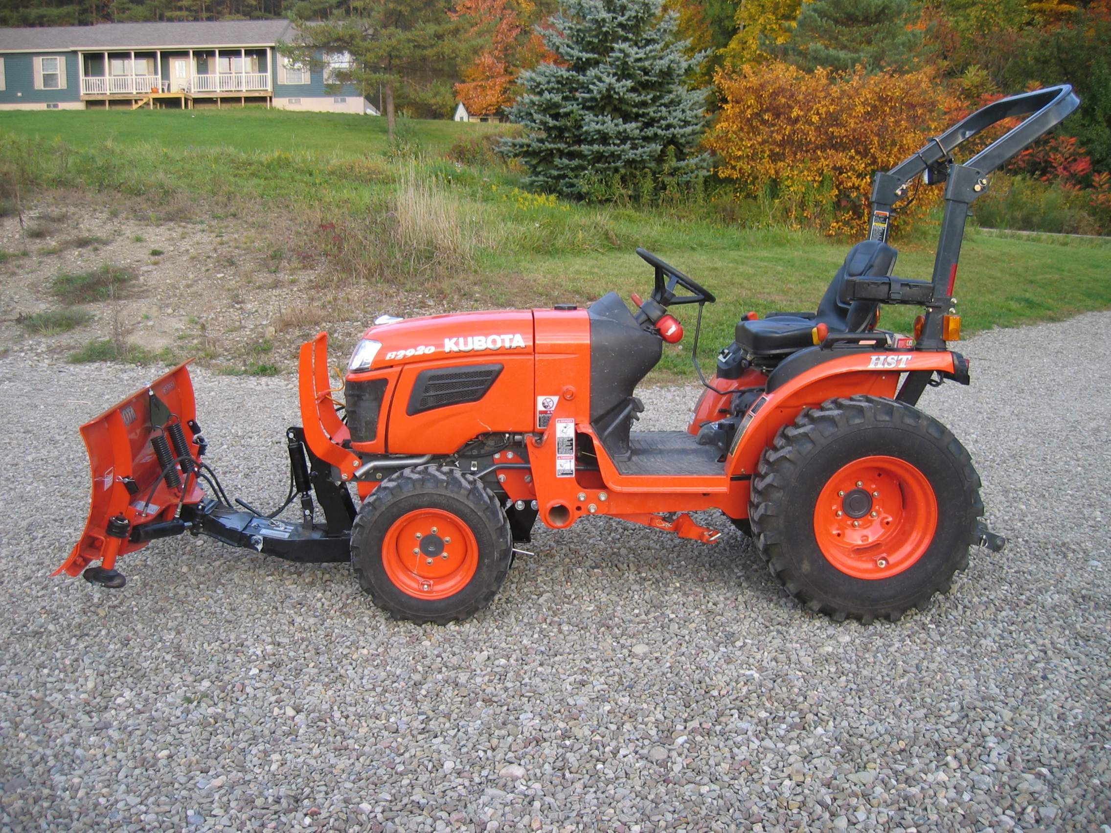

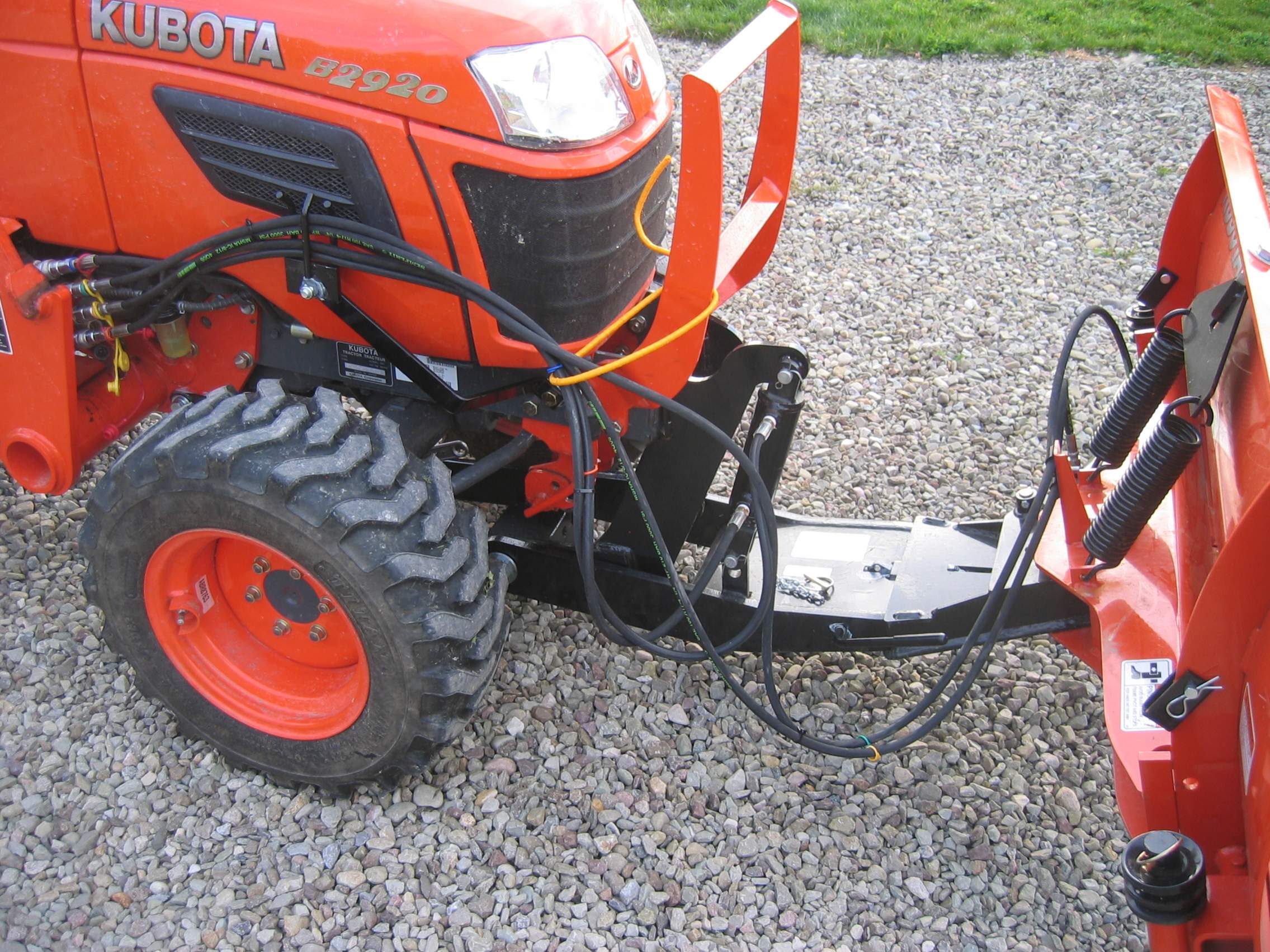

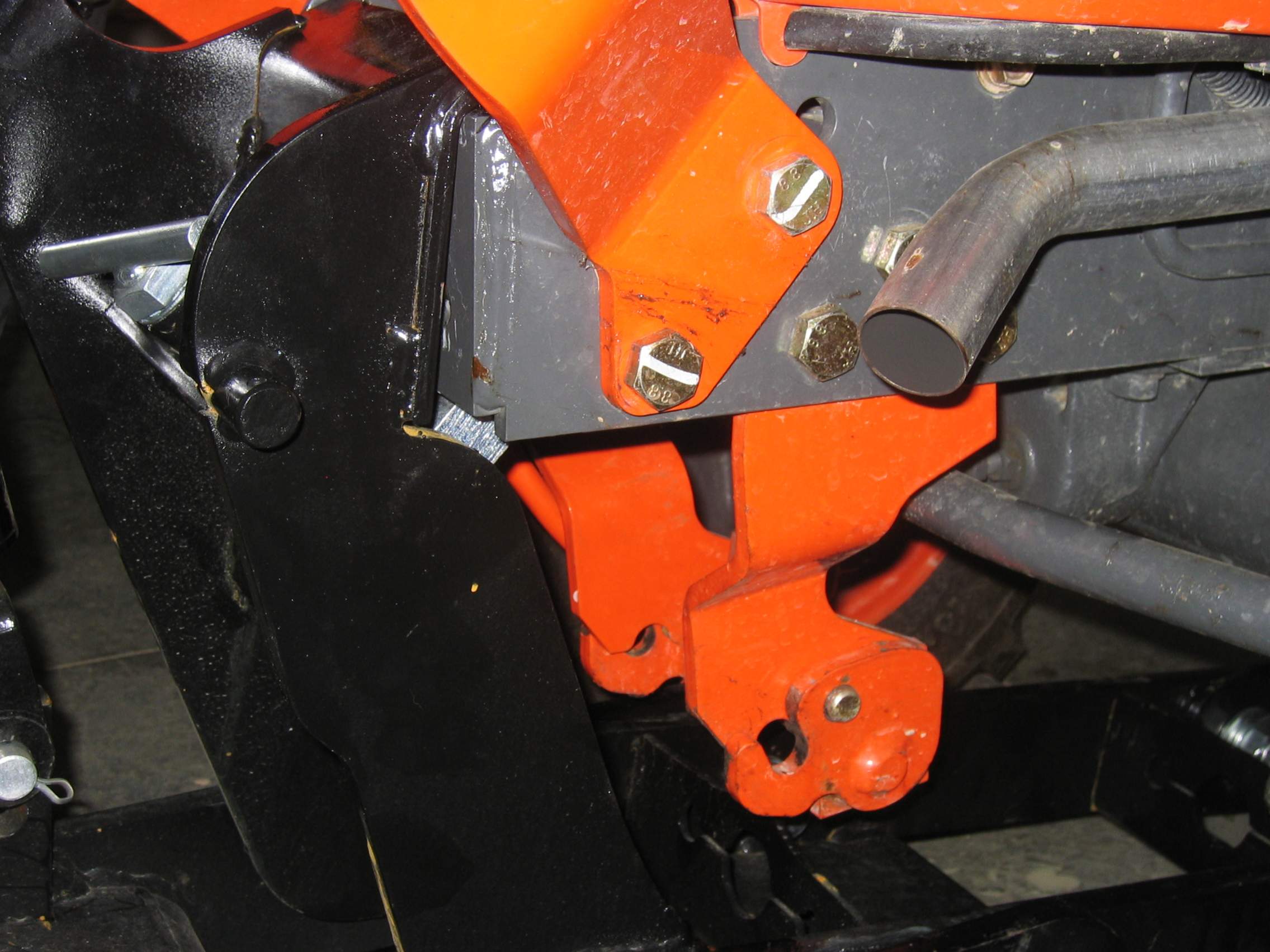

Hello everyone... I've been meaning to get back and and post an update/review of my B2920 that I received this May but I haven't had the time. This is not the review yet but its coming some time next week. I'm wondering if anyone else has the Quick Hitch B2791 for either the blower or plow on a B2920. It looks like Kubota is not issuing new manuals for the quick hitch since the B2920 is not even mentioned in the directions or the "for Tractors....." on the cover. In fact the web site doesn't list any Quick Hitch models. My dealer insists it is the correct model and as a result it took me most of this morning put it on. Things just don't seem to go easily when the directions aren't complete for your tractor.... Well after about 5 hours of fighting with it I think I have it right except for one thing. I can't seem to get the subframe to rest flush on the tractors bumper? The attached picture shows what I'm referring to. If anyone has a fix please let me know. If there is no fix do you think its worth having the dealer install it since I don't want to void any warranty? Finally does anyone else have the BH on the 2920? I find the seat is a real PAIN :( in the Seat! I just doesn't slid forward far enough I feel. And as a result when mowing I feel I'm reaching for the steering wheel and when done I have a sore back? I looked at the B2920 w/out the Bh and the seat moves more due to a different mechanism. As many problems Kubota had with the BX seats you'd think they would have worked on this longer before issuing a new model.
Thanks for your help and let it snow.......

I just went through something similar with the front quick hitch for my 2620. I got a 2733 quick hitch with my tractor. When I put it on, I found that the rear of the hitch's subframe would hit the crossmember of the FEL subframe, making it impossible to line up the holes in the hitch with the holes in the brackets (side plates) needed to pin the rear of the hitch. It would also cause the front of the hitch to not sit flush on the bumper....like your's.
The Service Manager from my dealer came over to look at my dilemma, since Kubota insisted they don't have a problem with the front hitches fitting on the new B's. He noticed that my manual didn't have as many pages as the copy Kubota emailed him. That's when it struck us.......my manual (which, by the way, is like your's.....no mention of the new B's at all......everything in it references older models)....my manual says 2733 Quick Hitch. The hitch itself had a sticker with model number 2733 on it. The manual Kubota emailed the Service Manager said model 2733A. They originally gave me the wrong hitch ! ! I swapped it out with a 2733A, and all fits as it should.
Strangely enough, the manual that was packed with this latest, correct hitch, was the same manual as what I got with the first hitch. No mention of the new B's. Since there are a few different brackets with the A hitch, I wanted to make sure I had the correct manual. The extra pages in the new manual are needed for the instructions specifically for the new B's. The 2320, 2620 and 2920 are even listed on the cover.
I think your dealer possibly made the same mistake as my dealer did. According to my new manual, the 2920 takes the same hitch as my tractor.....2733A.....not the 2791, like you ended up with.

In looking more closely at your pictures (especially the 2nd one), I really do think your dealer gave you the wrong hitch. The brackets that you pin the rear of the hitch to (I'll call them "pinning" brackets)....the one's bolted to the side of the tractor (to the FEL subframe)....are way too low. The correct brackets will only use the front bolt hole (of the 2 you are currently using), plus the 2 bolt holes above them. This will raise the rear of the hitch, changing the angle enough to allow it to fit flush on your bumper. When pinned in place, the rear of the hitch subframe will just barely clear the FEL subframe crossmember underneath the tractor.
Also, it looks like the front part (male half) of your hitch is longer than the 2733A.....at least in the pictures.
Another side note......the 2733 and 2733A are exactly the same hitches. The only differences are the 2 side "pinning" brackets and a couple of hose routing brackets.

RRbota... You were right my dealer delivered the wronge Quick Hitch! They are going to see if they can locate a 2733A for me. This time of year I hope to get it before the snow flies! Seeing I was a close to getting one that was not designed for my tractor as close as I did to working I'm hoping the 2733 will be a cake walk!
Farmall45b... I'll have to get back to you about the model # on the plow. I'm at work now. From what I recall it should be the normal 60" plow. As it is it appears more than substanial! I saw a MF with what looks like the exact same plow on it, also made in Canada.

Farmall45B- The plow model number is B2765A 60inch. The manual lists it as a front Dozer Blade. The manual is also for model B2775 70 inch version. It does not discribe it anywhere as heavy duty but it does have the ability to lock the plow blade so that it can be used as a dozer blade (meaning that the blade will be locked and the springs will not be able to release any tension.)
