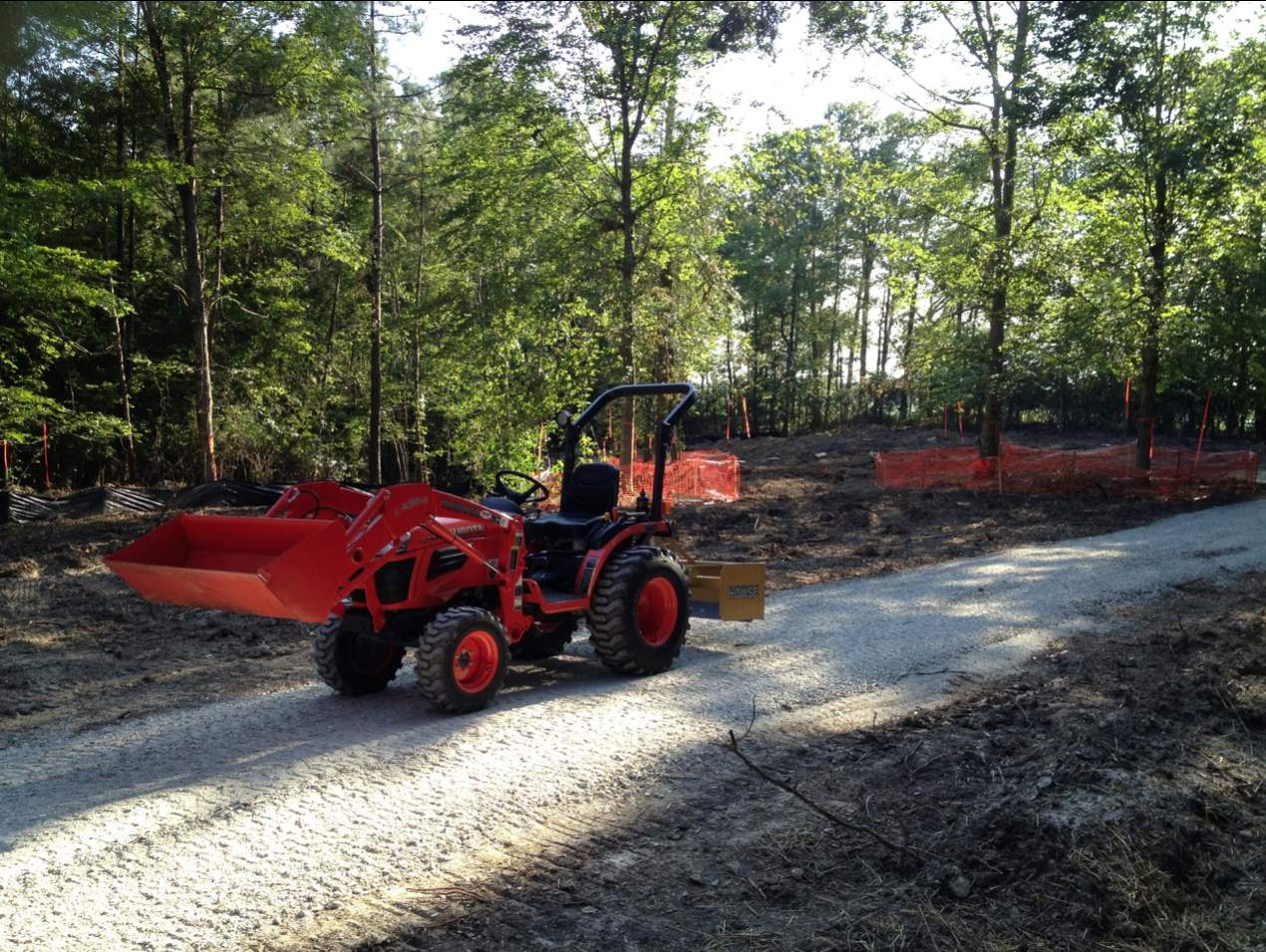

I have a 48" Howse box blade for my B2920, and used it just last night to top-dress a new driveway:
The 48" blade (which actually measures about 51" wide if I remember right) is a good size for the tractor. It has a weight of 425 lbs. For heavy dirt work in clay soil, with rippers down and the 3-pt in float, it can sometimes stop the tractor (loss of traction) once the box fills up. In that scenario, the weight of the box and fill does not aid traction obviously, it just drags against forward motion. In fact, I think the only time the box blade can definitely help traction is when it's elevated and the extra weight is all on the 3-pt. So it's only a traction enhancing device when it's *not* engaging soil.
I think one could go wider on the 2920 as long as the box wasn't going to be used for heavy dirt work. For instance, when dressing the driveway last night, I adjusted the top link so that the box didn't catch a lot of material. There was very little drag at that point. A wider box would have worked fine for that.
I guess you can also figure out how wide of a box is needed for typical jobs. That driveway I worked on last night is 12' wide. So I covered the whole thing in three passes, which is about the minimum needed anyways. The first pass was down the middle, to knock down the hump between tire tracks from construction traffic. The next passes were on each side of center. Even if I had a 6' box, I still would have made the first pass down the middle, and needed two more to finish the job.
