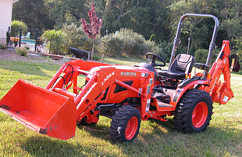

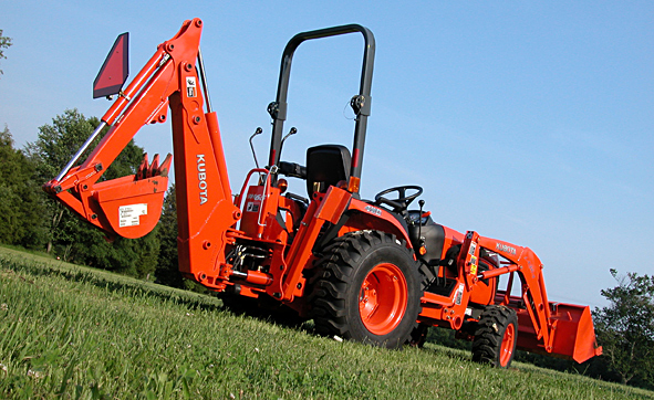

Although they've got nothing to do with this post, I never posted pictures before. So here goes nothin'.
