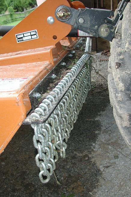

Re: B2910 + Woods 5\' Cutter = Happy Hogger!
And here is a second...hope they help!

   / B2910 + Woods 5' Cutter = Happy Hogger! #22
</font><font color="blue" class="small">( .. what was the cost of the chain guard.. )</font>
I just ordered the chains for the same Woods cutter. I paid $240 but my local dealer is higher than others outside of my area. /forums/images/graemlins/smirk.gif
   / B2910 + Woods 5' Cutter = Happy Hogger! #23
Thanks henro now i have an idea of what OEM is. i think i can make that happen no problem. probably gonna be a fall project though.
i am estimating about $100 bucks to build it.
   / B2910 + Woods 5' Cutter = Happy Hogger! #24
