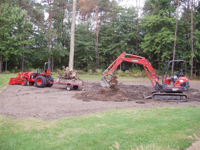

I have a B3030 with FEL and 60"MMM and I think it is a great machine. I don't have a BH because I don't need one very often. Too much money to set around 364 days a year. For the one time I needed a BH, since I bought my tractor, I rented a Kubota Mini-excavator instead. For $300/Day it will far outperform a small TLB. On paper it looks like the B2910 might be the best deal for you. You are getting the mower you can use and after you get your major tasks done that require a BH you could sell the BH and get some money for it. For any future BH needs I would rent. Much better ROI, IMHO. Overall condition of the machine is a factor, too. 75 hrs is practically new. 275 hrs is not much, either. Looks can tell a lot. If the machine looks good then it was probably not abused. If it is bent and scratched then it may have been worked hard and could have some hidden damage. Tough choice. Good luck.
