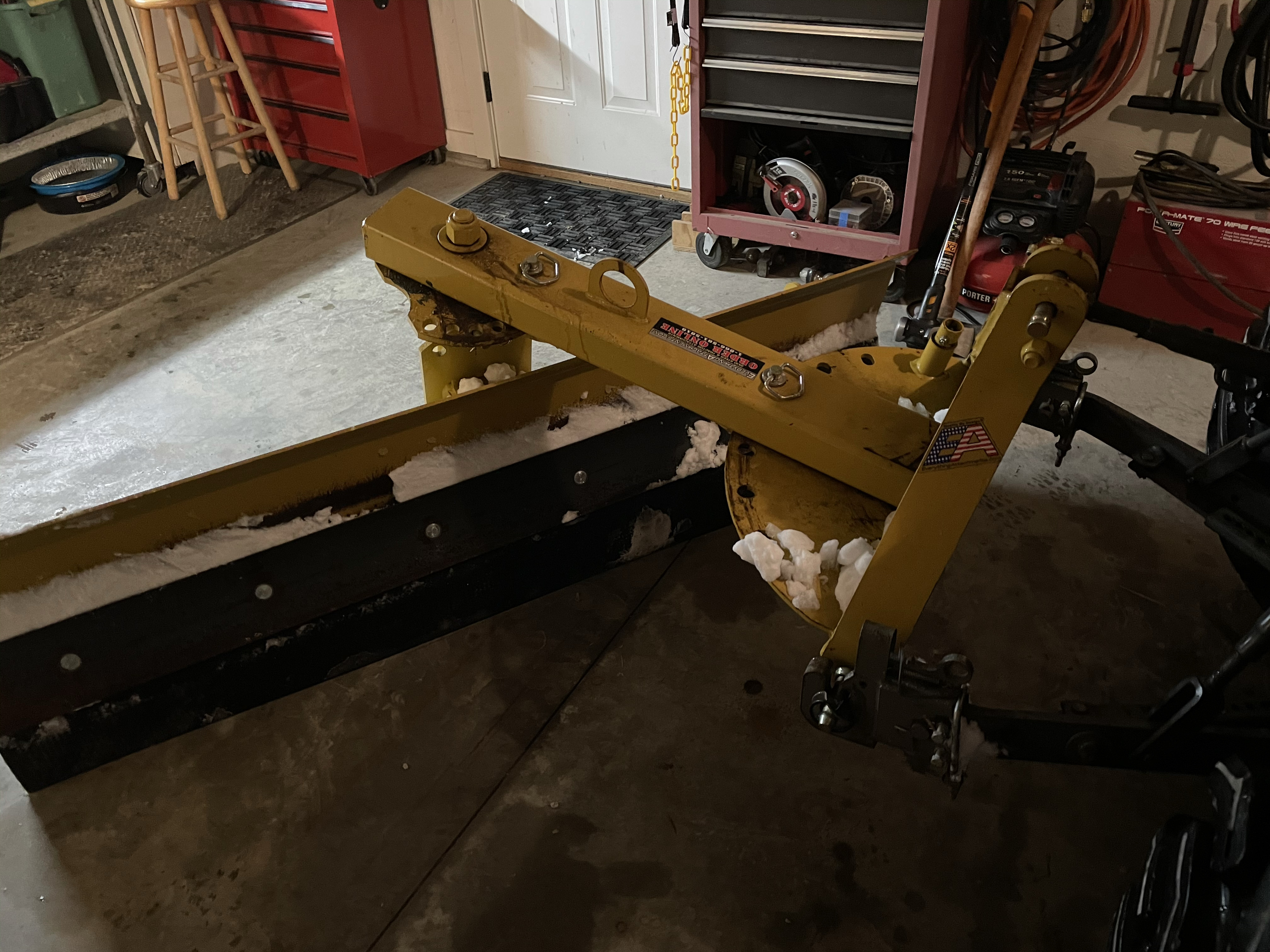

Plowed a few inches of heavy wet snow last night. Was a great learning experience. Turns out I’ve been doing it all wrong. My blade angle wasn’t steep enough to properly “roll” the snow out of the way. I had been dragging the snow around in the mid range gear and it was taking forever to get it cleared often requiring multiple passes.
With the correct blade angle I was able to blast through it in high range!
I held my hand on the 4WD lever during most of the session. It only slipped into 2WD a couple times when my hand was needed elsewhere. On this machine 4WD is the “higher” lever setting meaning gravity is working against it. Given that I never felt the lever get pulled out of position I’m hoping it’s just a lazy detent. I’ll dig into it and report back when I’m able.
I suspect that at higher speeds under heavier load the long lever just wiggles more and works its way out of the detent (fingers crossed).
