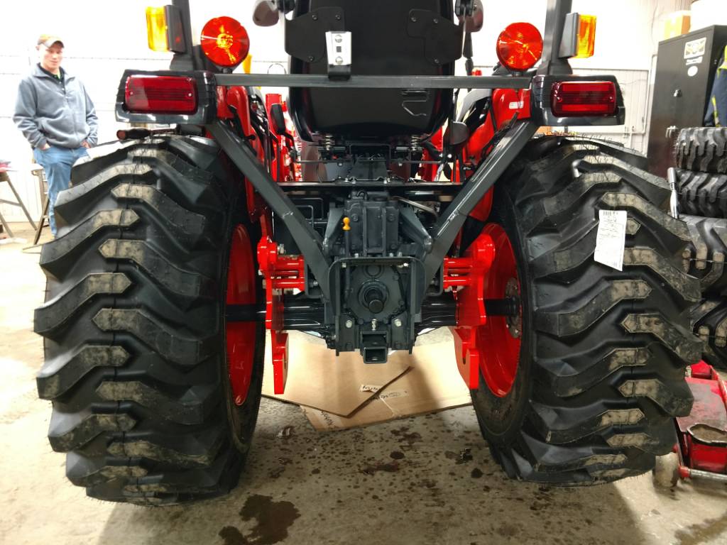

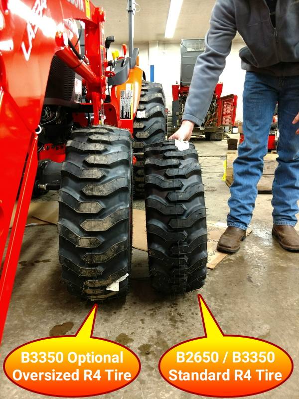

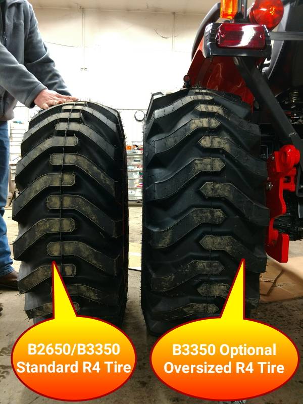

Yes, the spacers were installed when the tractor was assembled. They will never be removed. If in 10, 20 or 30 years my rear axle bearings fail, I'll fix it. I have to have the spacers and I have to have the loaded tires otherwise I wouldn't call it a tractor, I would call it a ball.... As it rolled down my property. I live on a steep slope and my tractor lives on it with me. I need all the low weight and wheel width I can get, that's why I have the B3350SU optional wider tires, spacers and about 400 lbs of Rim Gard. My B2650 is 60" wide at the rear wheels, yours is I believe 53" it 54" with cute little tires, little wheels and no spacers. The attached photos are prior to the spacers going on, the spacers added another 3" to those offset wheels and wider tires. 1515543341-picsay.jpg1515543521-picsay.jpgIMG_20180109_165259199.jpgIMG_20180109_170118299.jpg

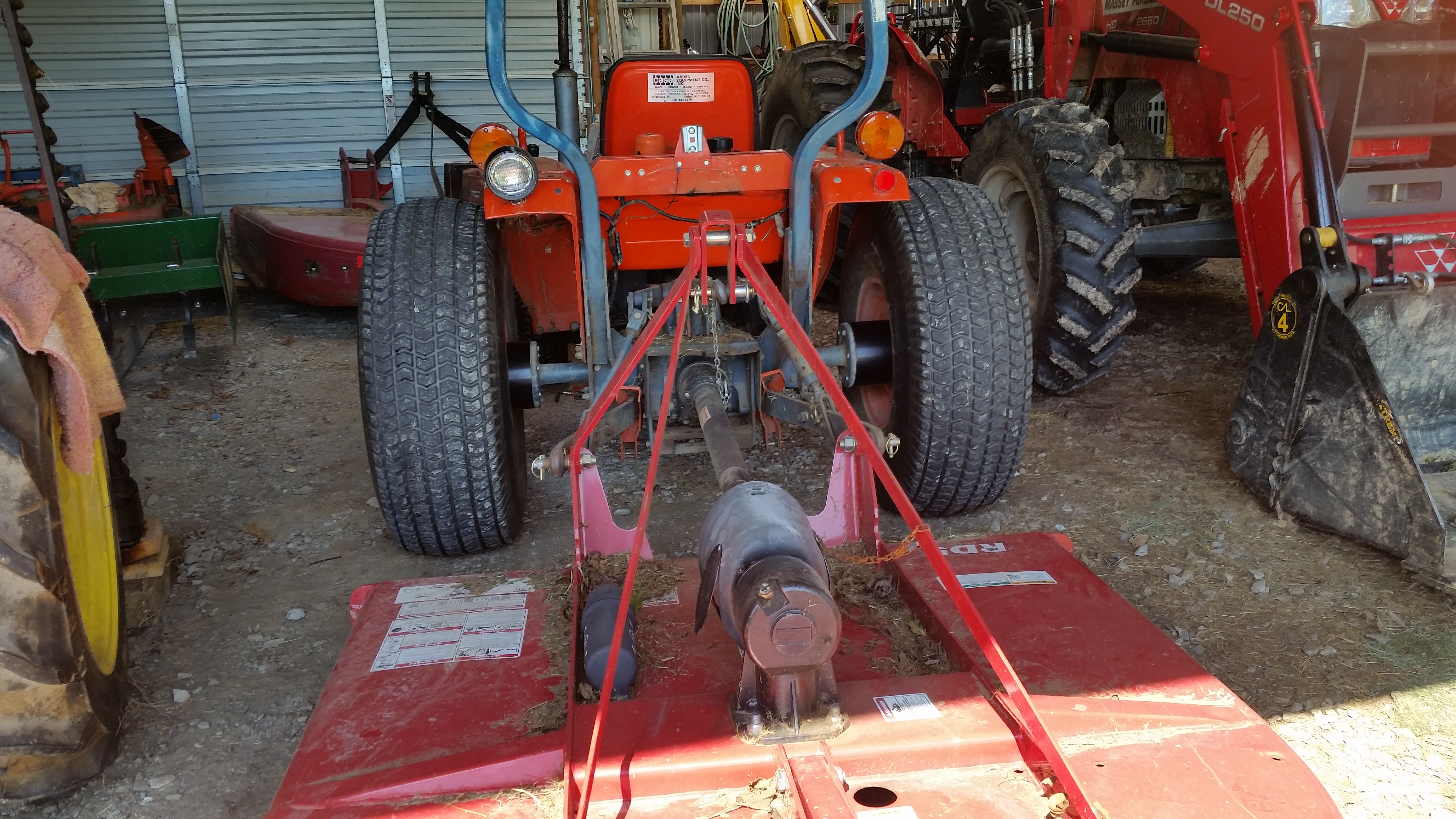

Crawler: I too have enough steep ground down in WV 130 miles south of you that wide spread wheels/tires is survival gear. Very unstable/unsafe as it was in the "before" picture below. Huge improvement in the "after" picture with 6" spacers on each side. For size ref that is a 5ft Bush hog attached.
Before:
After:
