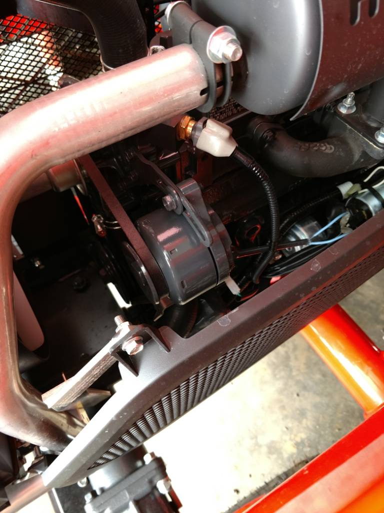

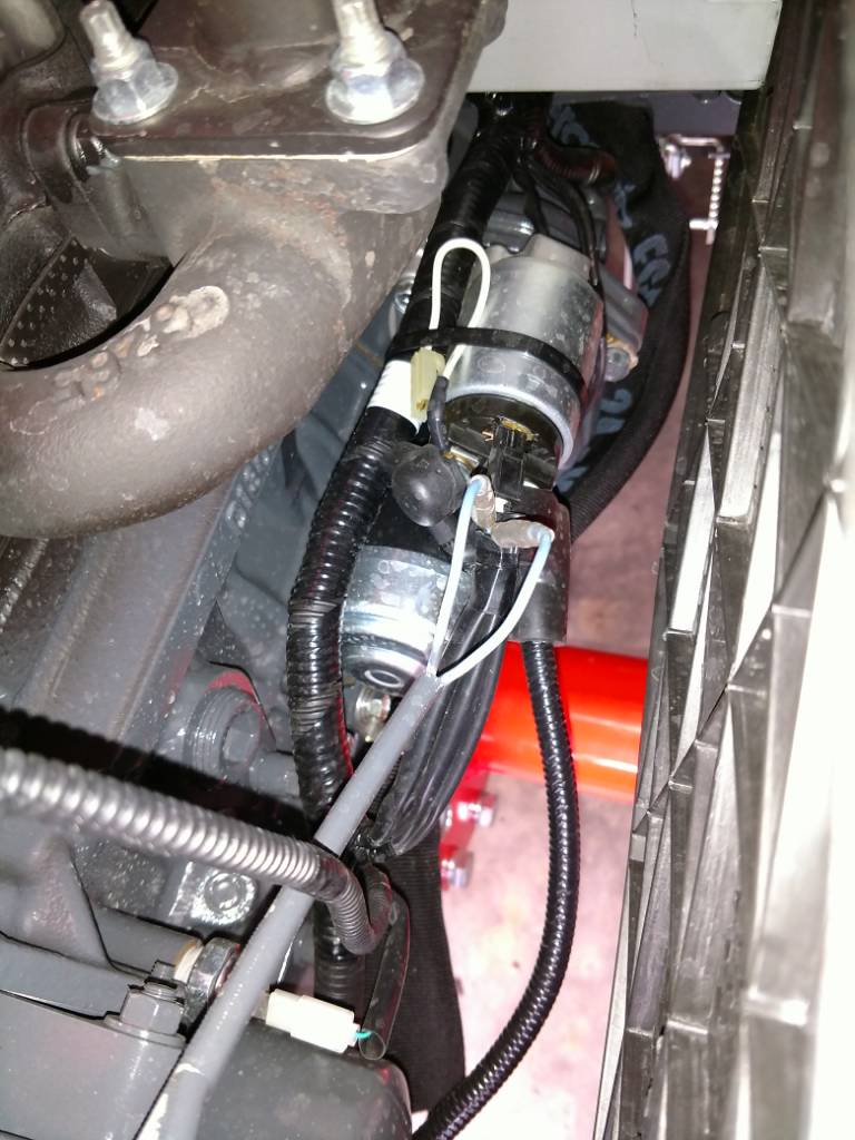

So based on the WSM I'm pretty sure that we are not stuck with the dynamo.... Whatever that is? Also, I'm going to guess that since we do have an alternator according to our manual, we have AT LEAST 40 amps.... 100 amps would be a lot better! IMG_20180202_083148300.jpgIMG_20180202_083613125.jpgIMG_20180202_083627702.jpgIMG_20180202_083652002.jpgIMG_20180202_083658922.jpg

When I bought my B2650 rops machine, I researched this question. The rops model has a 14.5 amp dynamo, and the cab model has a 55 amp alternator. There are some alternator upgrade options for the dynamo. When I added 4 LED lights to my tractor, I bought an amp clamp to check amp draw with everything on, and then knew what I could use for LED lights. with all the lights, flashers and new 4 LED lights on I am about an 11 amp draw for the whole system. The 4 new LED lights are 6 amps out of the 11 amps. So my dynamo will handle it ok. Through experimentation though, I have to be running at least 1800 rpms for the dynamo to put out that many amps. That is not a problem as I run close to pto rpm for doing any work. If I am going to take a break from like plowing snow, I just flip off the LEDS and set it to high idle. I have almost 800 hrs on mine doing it this way with no problems. I was going to upgrade to the alternator if need be, but havent had to. I would suggest buy an amp clamp or from where I see you work, you could probably borrow one, turn everything on and see what you have left available and then figure out your lights. Good luck with your build.

Do this is a 14.5 amp Dynamo?
There is a ton of space, I could add in a 140 amp GM 1 wire alternator and replace that.IMG_20180202_093108040.jpgIMG_20180202_093125840.jpgIMG_20180202_093143552.jpg1517582065079.jpg
