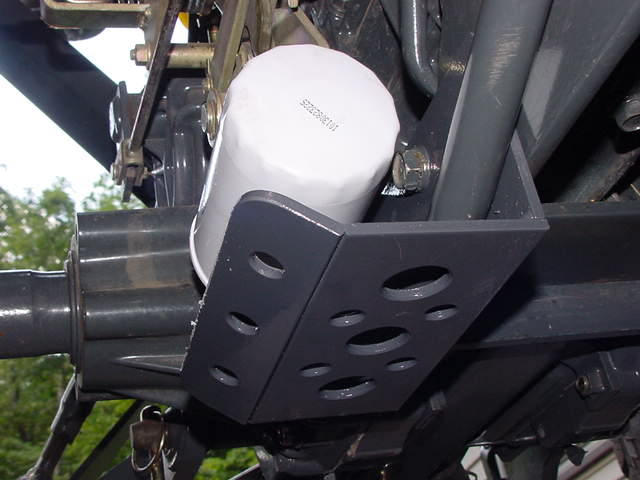

Built some guards for my hydraulic filters and thought somebody might wnat to see how I did them, so here you go.
You can see by the old filter why I needed it.
Little tip: if you want to change the filter without draining the oil I put a small vacuum cleaner on the fill port. Be careful as you may get some oil when it is splashing around in the gear box.

Nice...... they came out very professional looking.
   / B2630 Hydraulic Filter Guards #3
Looks VERY nice! What hit the filter to bend it like that? I have noticed on my B3030 that the suction tube below the filter hangs lower than the frame. You don't have to worry about that anymore, either. Good job.
