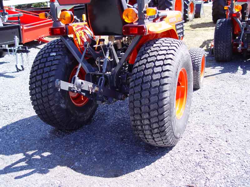

I know what you're talking about. I have 3 pics of turf tires on a B7800 but my dealer told me these are the same for a B3030.
Here's the first

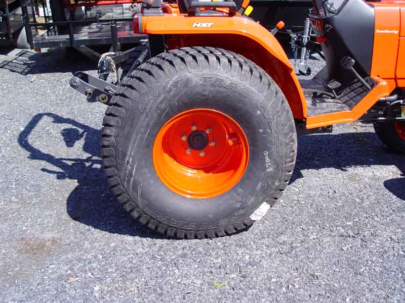

Another one
On this one we see clearly the round shape of the tire.

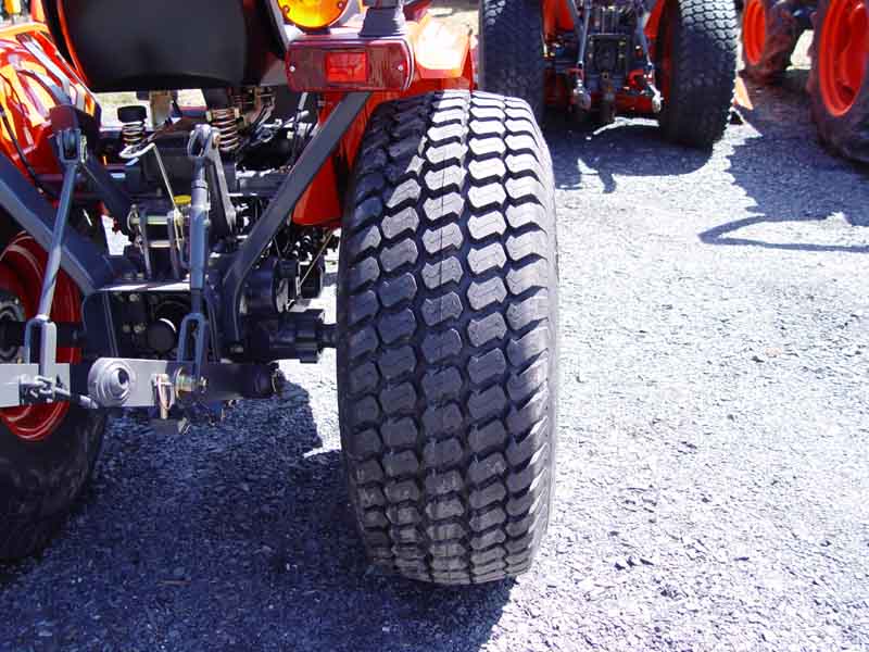

The last one.
We see that there's not a lot of space between the fender and the tire. I looked with my dealer and if you want to put chains you'll have to use a spacer because there's not enough space between the tire and the interior of the fender (interior side near the transmission, below the seat). And we were not sure there was enough space between the top of the tire and the bottom of the fender.

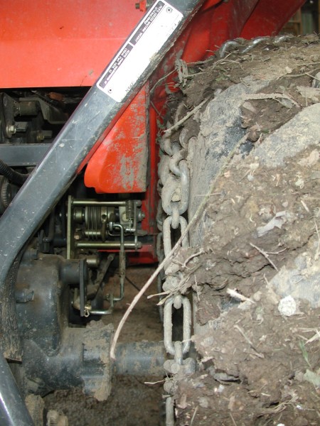

Pondfish,
I don't think going to R4s would be the complete answer. From some comments in this thread, it sounds like the B3030 has a tad less clearance between the tires and fenders than the B2910 has. A tad may be 1/8" but that is still a lot when there is almost nothing to begin with... /forums/images/graemlins/crazy.gif
Attached is a photo showing how TIGHT ladder chains fit on my B2910. There is maybe 1/4" clearance between the chain and the fender. It works, but I don't like it. If I could get a set of spacers for $154 like Stef, I would do it today. Even if those were US$! /forums/images/graemlins/grin.gif
Why don't you see if the dealer will sell you a set at his cost? If you don't get them, another disadvantage is that with the chains on R4s being so close to the fenders, they drag mud up and it scratches/scrapes the paint off... /forums/images/graemlins/frown.gif
