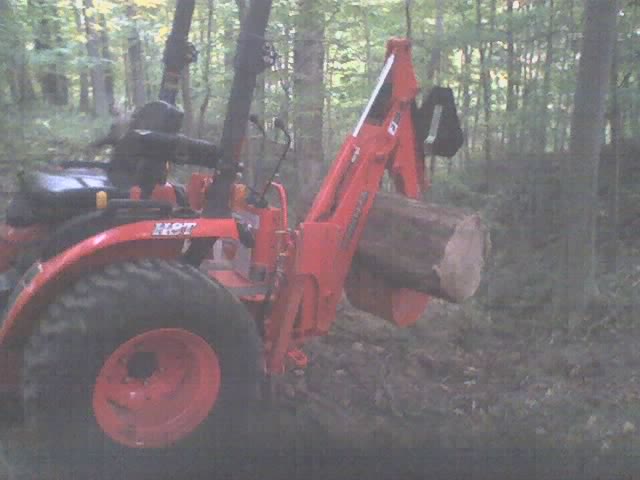

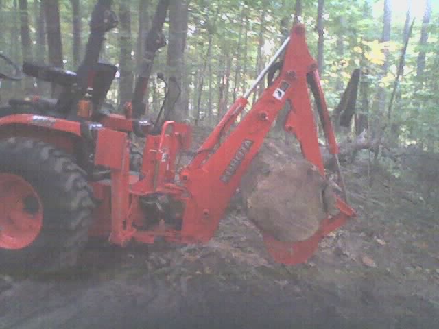

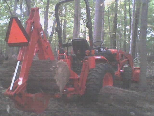

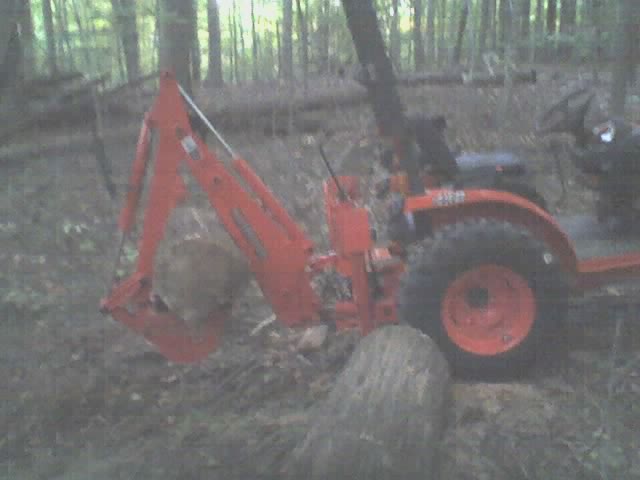

I was working in the woods tonight and grappled a log with the BH. This made the front end light enough that I had trouble steering. I noticed that I could use my heel on the hst fwd pedal and push the left wheel brake at the same time. So I unlocked the brake pedals and tried it. I was surprised when it didn't help me turn at all. All it was doing was like dragging the brakes on both wheels. It was just putting a load on the tractor. Has anyone tried this or had different results?
By the way who says you need a thumb on the backhoe!
