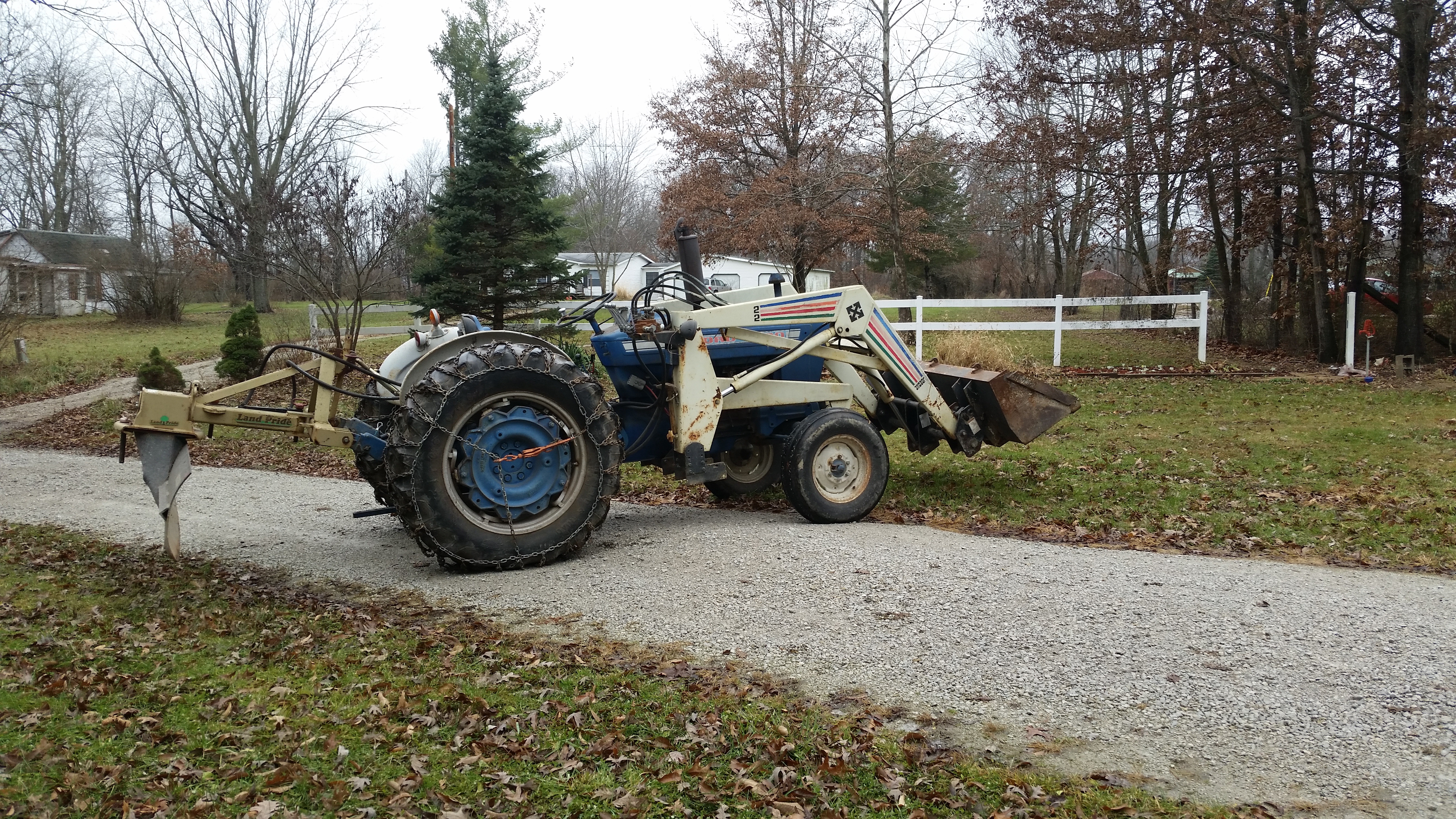

Same as skipperbrown, use BX to mow, till and roll lawn. Use B for fun stuff. The ford when raw power is needed. Ford and B have loaded tires.
