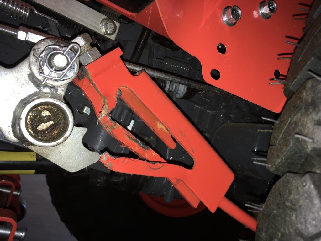

Can anyone look at their B2301/2601 with mmm and take a picture of the orange link that runs from the 3 point arm to the mower? Mine is broken and I think it was installed backwards . I have enclosed a picture of mine.

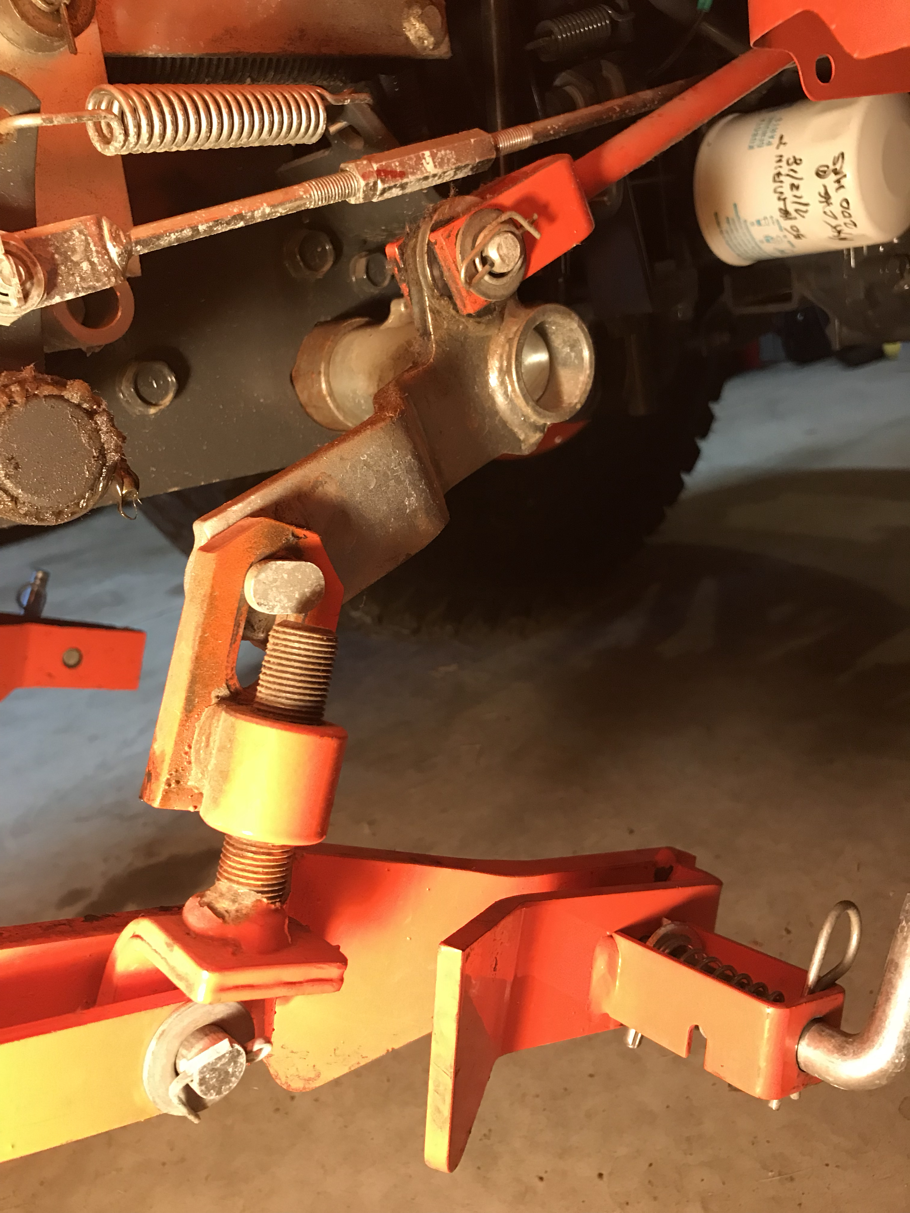

thanks for taking the time to take the picture, I am certain now they installed mine backwards. Dealer warrantied it but the fine threaded bolt is buggered and dealer had to order one.
