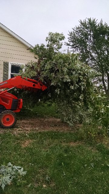

My b26 with foam in the tires will make the rear light when at max loader lift which with a grapple happens a lot. When compare to other 26hp tractors there is no comparison with these b26 will do. I have not checked my hydraulic psi but in last 6 years I have been very pleased with it.
