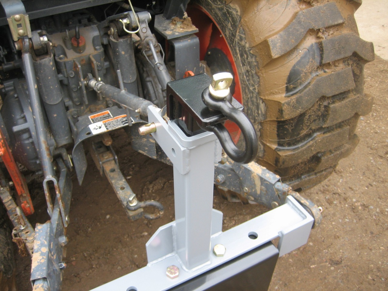

I have several questions please:
1. Has anyone tried moving a 5th-wheel trailer with their 3-point hitch on a B26 (or any tractor for that matter)? I'm looking at buying a 3-point trailer hitch and then modifying it to accept the 5th-wheel pin. I tried using the loader but the loader isn't strong enough to lift the 5th-wheel.
If you are just going straight forward and back maybe but with how high 5th wheels are on the hook up I would not even try it as the center of gravity will be high and it could just push the tractor over. I have bent 3pt arms before moving dirt going backwards with a box blade on much bigger tractors ( not the tractors fault at all).

What is the pin weight of your RV 5th wheel trailer?

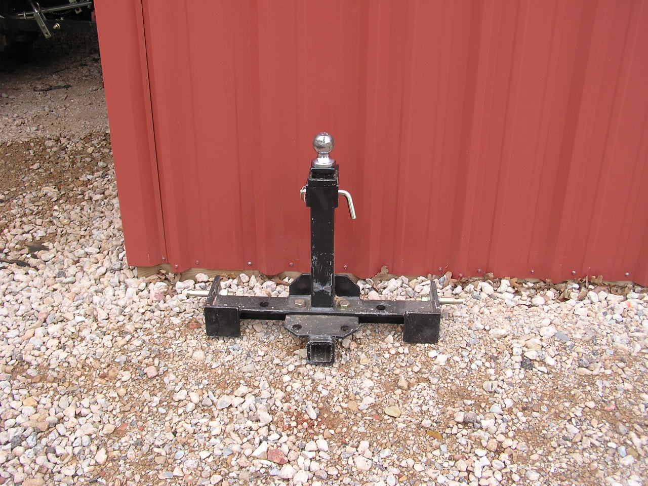

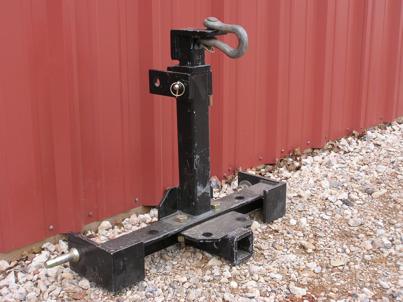

This hitch from Omni mfg, would be easy to put a 5th wheel plate on, but I don't think your tractor is big enough to do much with it.

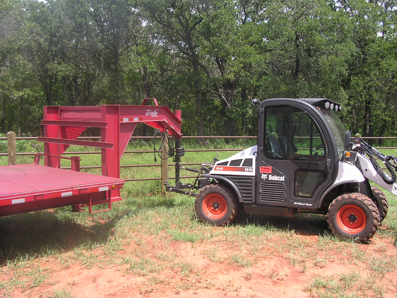

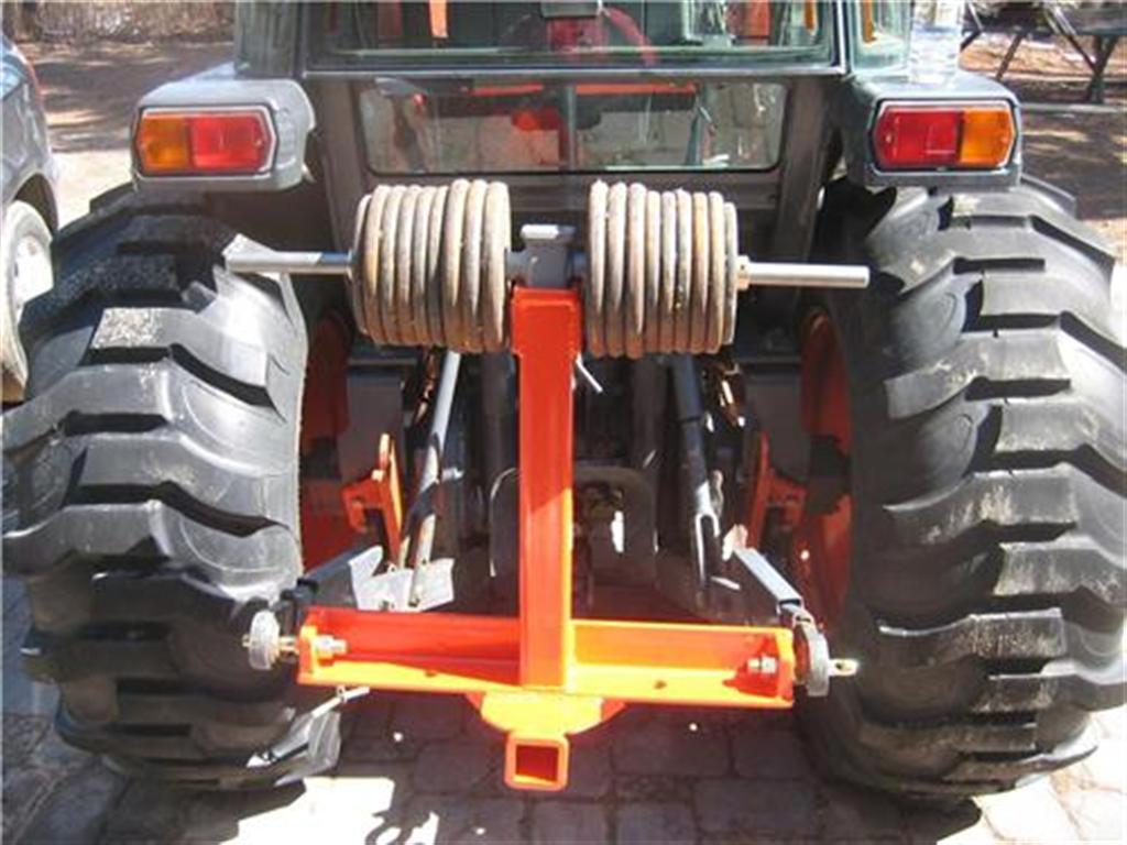

I use it on the Toolcat to park this gooseneck that has 1000 pounds on the ball.
