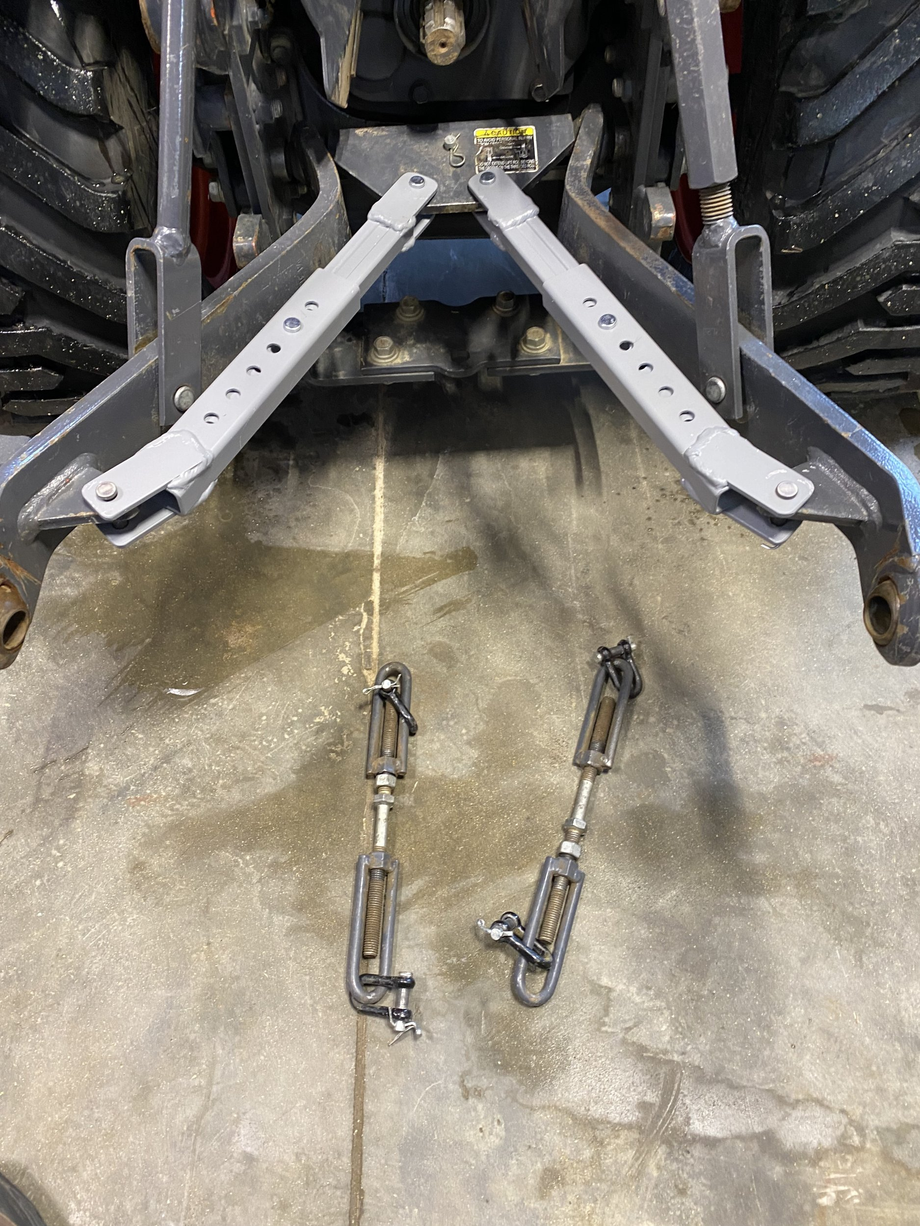

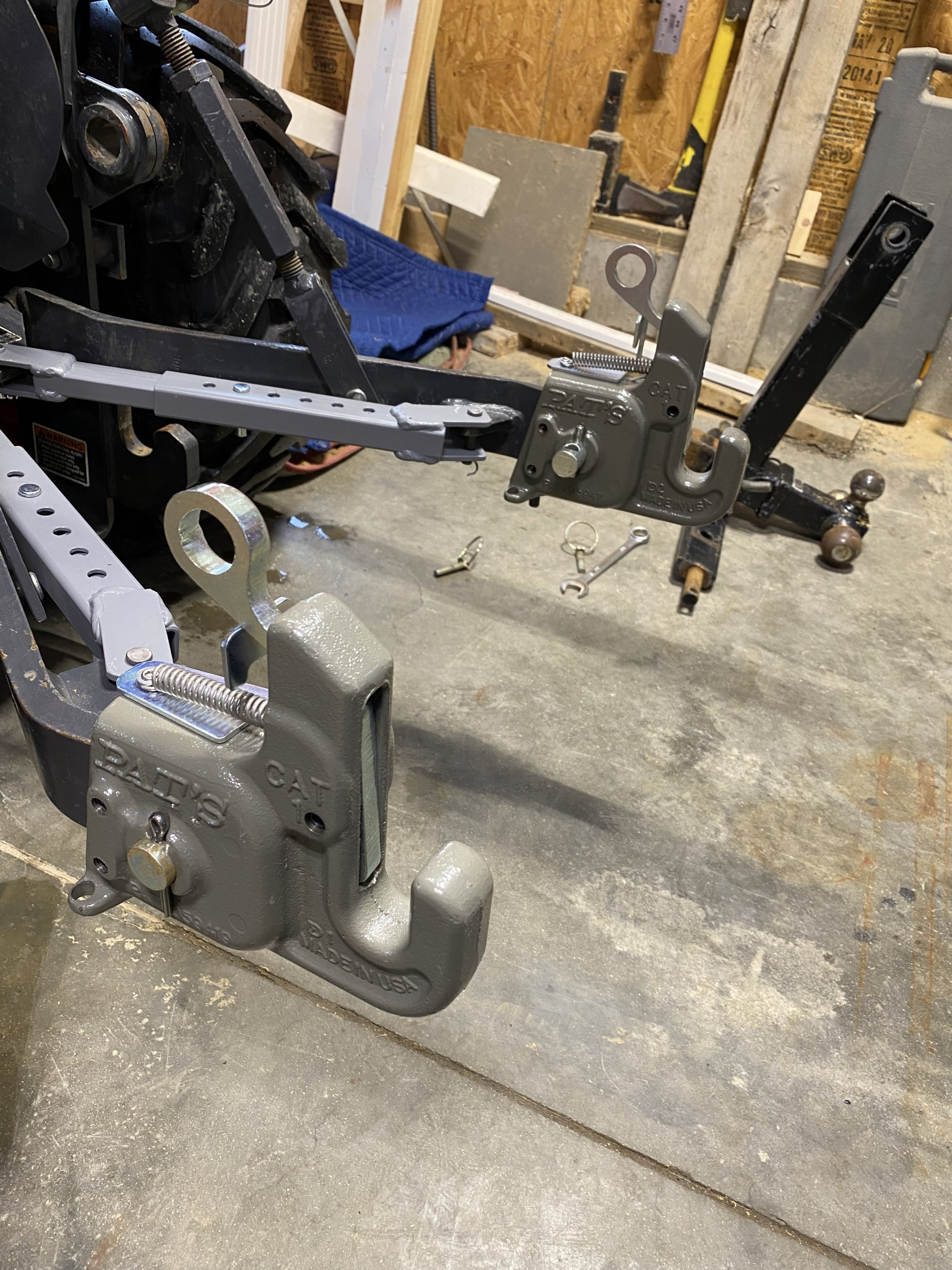

   / B2410 with Pat's Easy Change? #5
Got rid of the turnbuckles and got Pat's quick changers installed.
