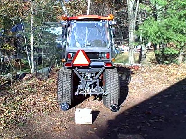

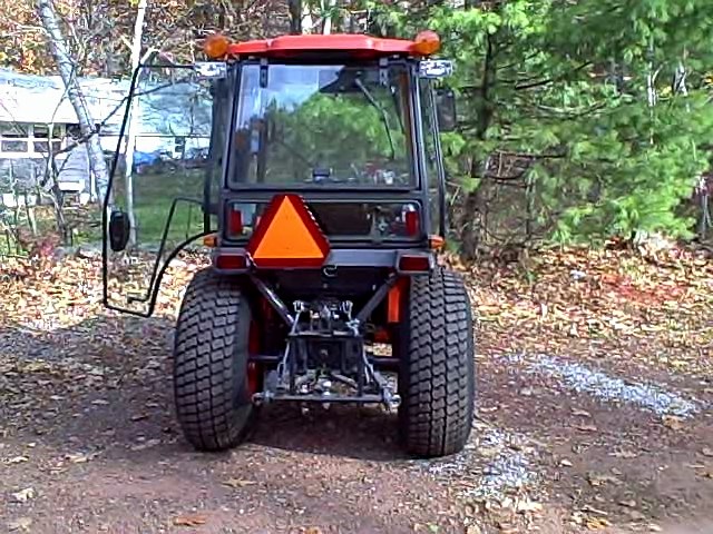

   / B2320 Rear Wheel Stud Removal #6
Another method is the "double nut" technique. Put two nuts on the stud and tighten against each other really tight, then back the stud out using the nuts. If the stud is in real tight this might not work, but many times it does.
I had spacers installed on my B3030 and this is the method my local garage used on my tractor.
