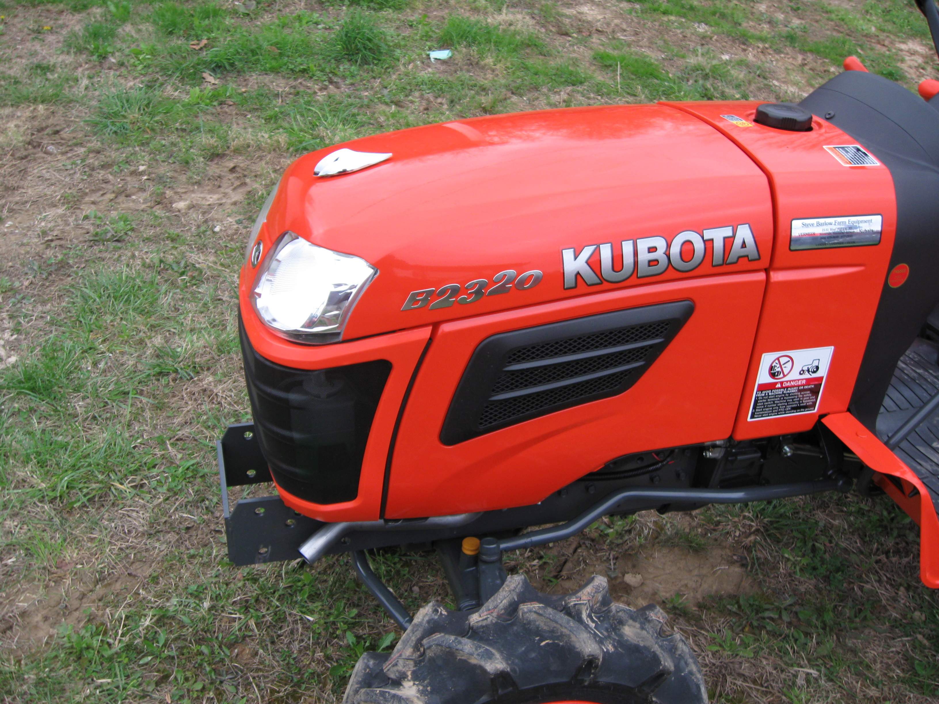

OK my B2320 needs weight on the front. Kubota weights are $1.00 per pound. I don't want to pay that much. Need maybe 150 to 200 lbs. There is a front plate on the tractor where weights hang on that protrudes out a bit for the weights. The plate has three holes on each side of it.
Sakrete is under $6 for an 80 lb bag so Sakrete is available for $12 for 160 lbs. I'm telling friends to try and find me 150 lbs of barbell weights and call me if they do.
I guess I can buy L bolts to stick out the front from the holes or some kind of L shaped steel to attach a box to but what I'd really like is what have some of you other cheap skates like me done for front weight?????

Back in the day when I raced I would use old lead tire weights. The tire stores would sell them (usually in a 5 gallon bucket). I would melt them down and pour them into an old valve cover. They usually weighed about 40lbs. Might be more work than you want to do but they do make nice weights. Just be sure to paint them otherwise the rain will oxidize the lead.

John,
I use barbell weights for ballast on my subsoiler and my PHD. You've seen those pics before. I also have in the back of my mind a rack that will attach to the ROPS sides and go right behind the seat. I shopped my local Craigslist for months and got, if I remember this correctly, two dozen 25 pounders and three 50 pounders for $110 total. I also have a handful of others that I got from a second hand exercise equipment store.
Olympic weights have about a 2 inch hole, whereas standard weights have a 1 inch hole. Standards are usually considerably cheaper and obviously easier to bolt onto something. As far as how to attach these to the front, I'd have to ponder that for awhile. One good thing about suitcase weights is that the design is ideal. The price, however, isn't.
Tom
O.K. So it's a few minutes later here. After looking at the front of your tractor for a bit, here's what I'm thinking. Do you weld? Do you have a heavy duty drill press? I'd get a couple of plates of steel, bore holes, and bolt them to the sides of that front frame so that they cantilever out in front of the tractor. To that, I'd weld a piece of steel plate that'd be like a table top. In the center of that, I'd weld a piece of 1" dia. steel rod sticking straight up. This sub-frame shouldn't be too heavy to bolt on by itself. You could then stack as many discs as you want on it, handling them one at a time. To top off the stack, you use one of the locking collars that goes onto the end of a barbell. If you don't weld, you could use pressure treated lumber to make cantilevers that support a little pallet or box. Put the weights on the pallet or in the box. Use large dia. threaded rod with large wingnuts, oversized plate washers, and lock washers from Grainger to secure the discs. Actually, if you went with the box, you could just toss in any old scrap metal, big chunks of heavy rocks, etc. that you already have laying around.

I don't weld but I have a brother in law with a machine shop. If I catch him at the right time he'll do stuff for me or if I don't ask him very often. Course he'll always do it for my wife, his wifes sister. May get her to get him to make me the flat top plate with side arms and rod sticking up.
Thanks, hadn't considered using the side holes only the front ones:thumbsup:. That's why we need someone with a different view of life to talk with. Some people hate people that don't agree with them, I've usually appreciated them after I decided they were usually "wrong" but still not stupid.:D:laughing: Truly Thanks.

Check out the 'thrift stores' (Salvation Army, etc.) they often have weights.
   / B2320 needs weight on front How to Homemade? #6
I have a couple of old rail road tracks I am going to have my son cut up for weights when he gets time.

I was able to scrounge a weight lifting machine for my weights. Try looking for that in your classified searches. It's nice that they are rectangular. 2" holes so I can run a chain through them to hang.
