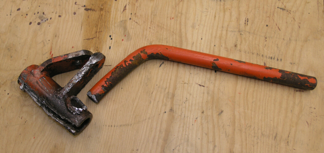

The backhoe is off the tractor. I originally wanted to remove it to get at the 2 rear hydraulic fluid drain ports. I didn't realize this was going to be such a diversion.
The photo shows a remaining chore. Both pin levers are still on the frame. The one in the photo shows where the lever handle broke off from my attempt to rotate it. After that I used a sledge & piece of rebar to wail on it enough to rotate the ears out of the way so the big pin could retract. Check out the deformation from the beating I laid on this poor piece of metal.
The pivots are still frozen to the frame pins but at least now I have more room to work.
I need to get some penetrating oil into the middle of the joint. I thought I could drill some holes through the sleeve in various locations & oil through them. Anybody ever tried this?

I won.
But I think I need a new lever.
When I put the new one on the pin should I use anti-seize or something like Fluid Film?
