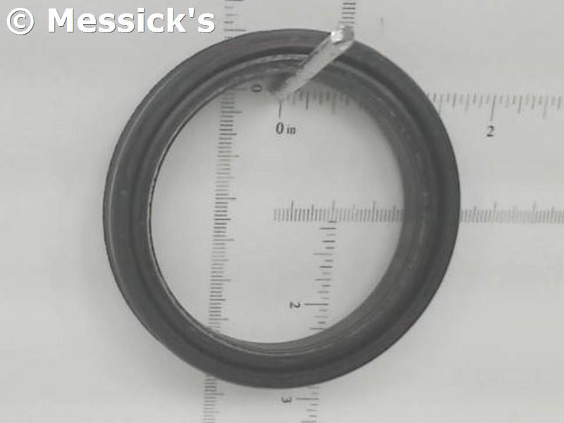

it doesn't appear to be a two piece seal - from the pics it looks like there is another bearing - per the parts list it shows two circlips and I only see the bottom one.
I would call Messicks in the AM and ask them - attached is a pic of the seal.

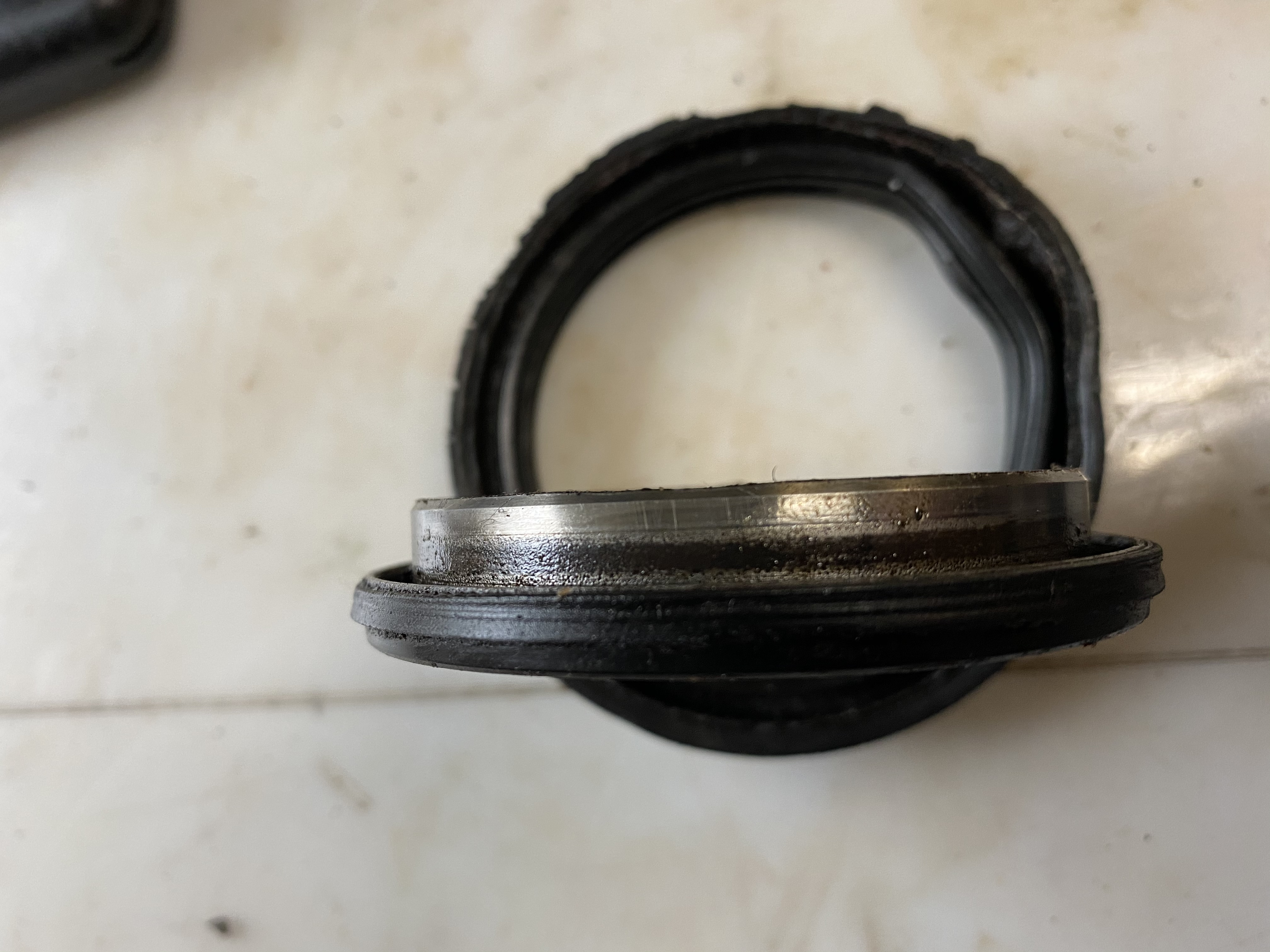

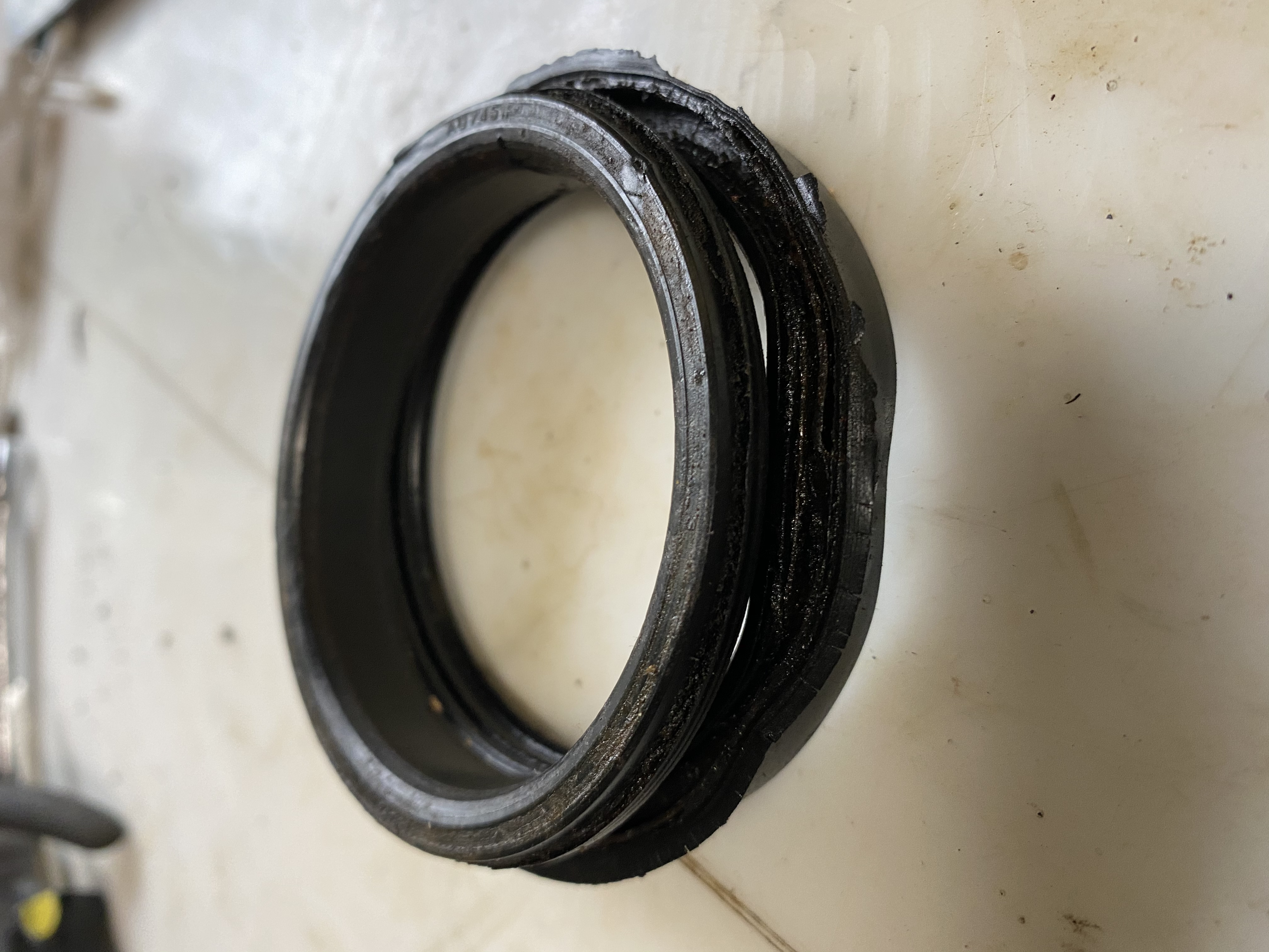

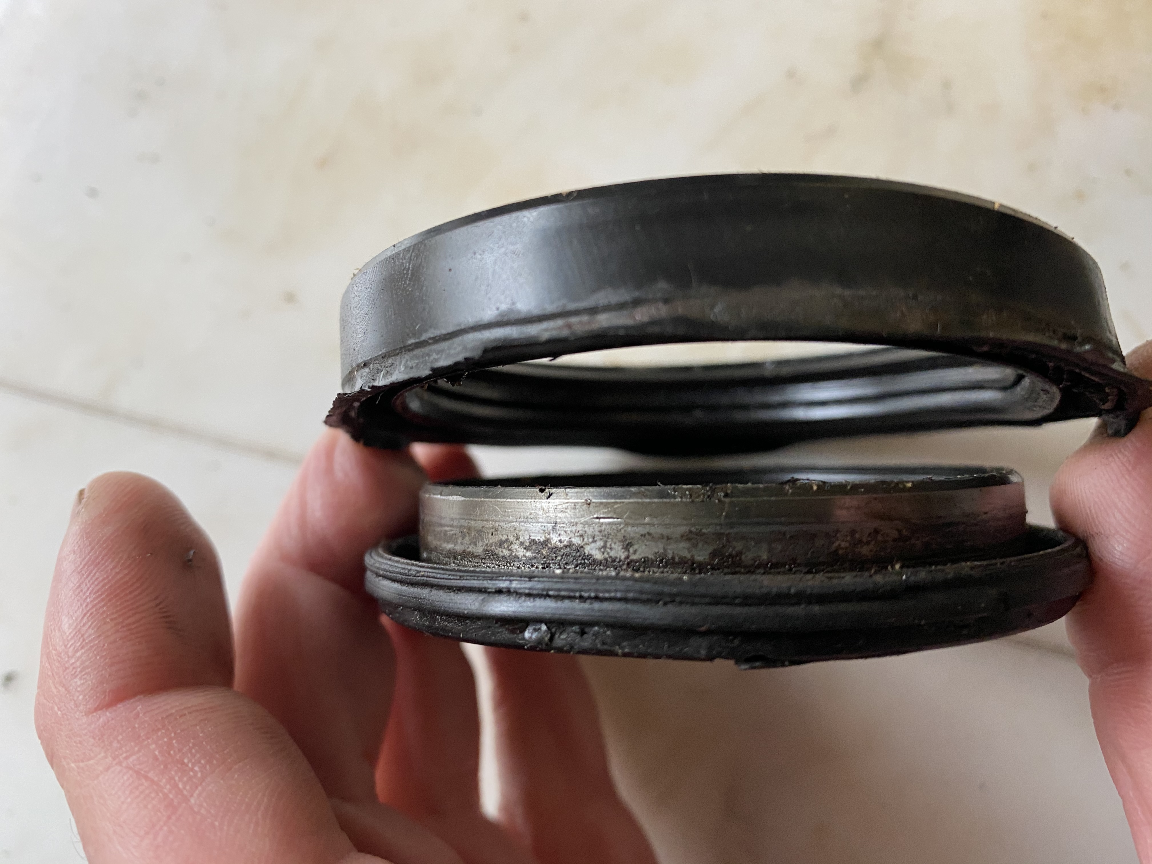

   / B21 Kubota Front AXLE/HUB LEAKING

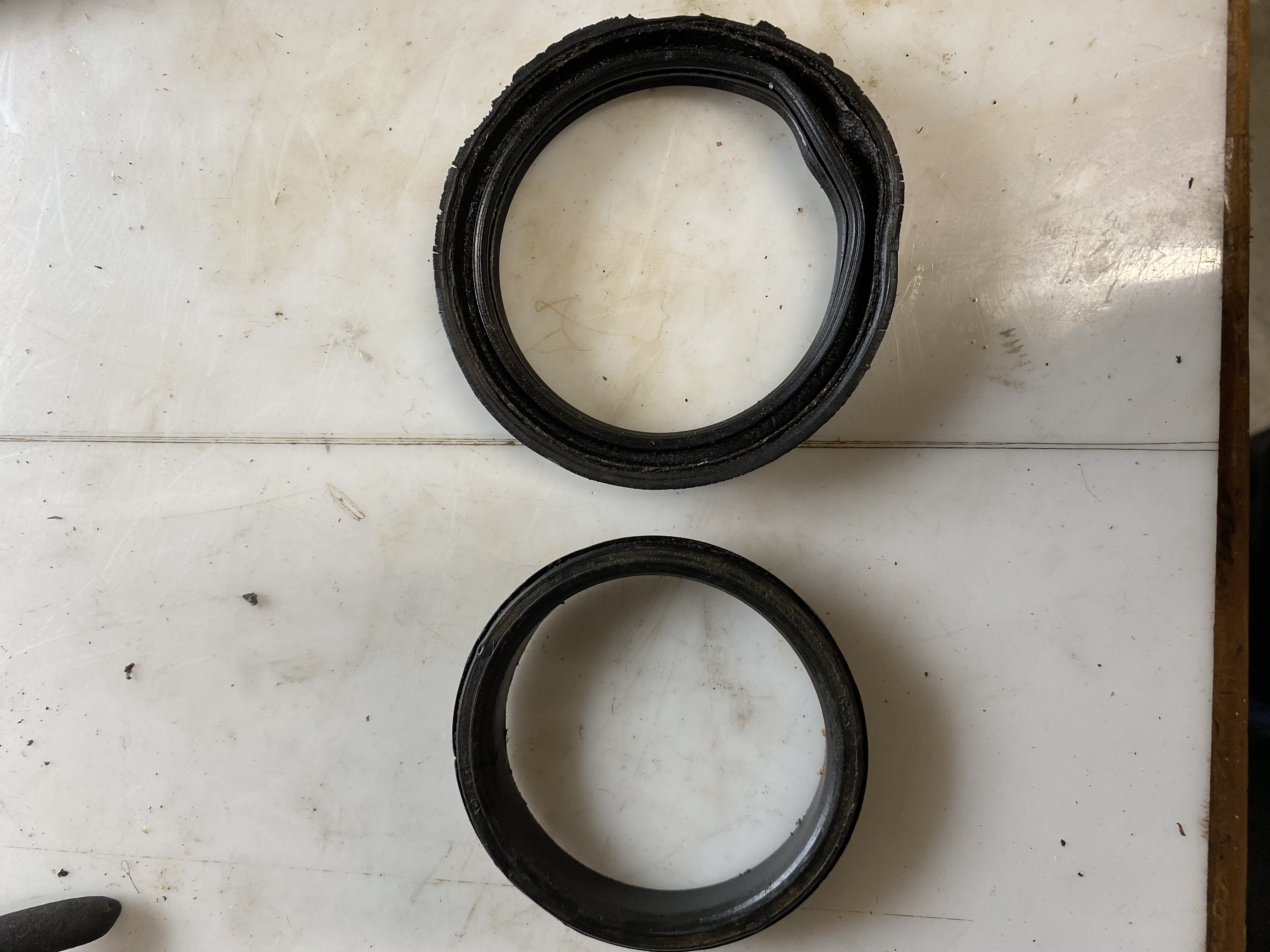

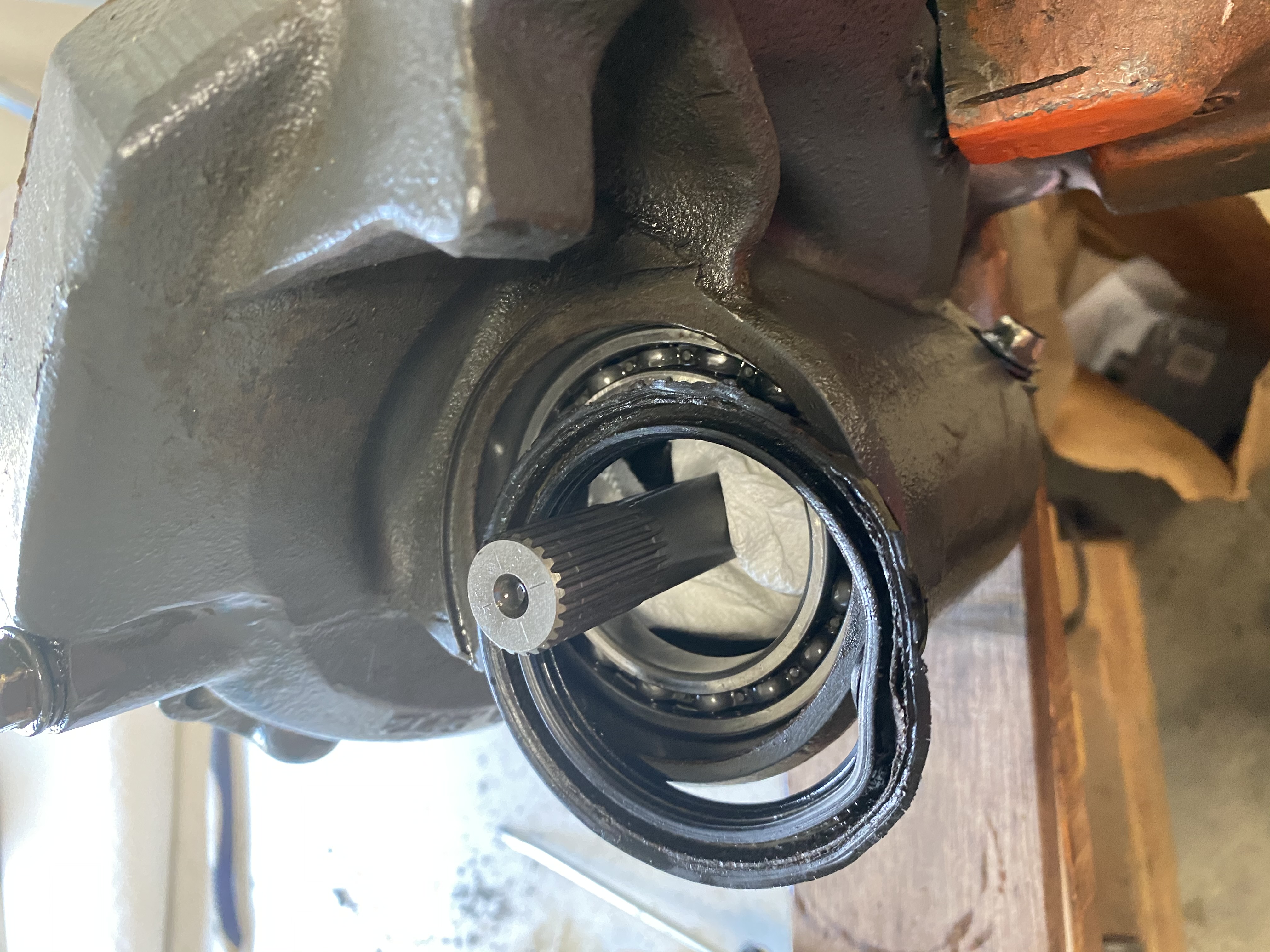

Apparently the seal was torn into two pieces clean. waiting for new seal.

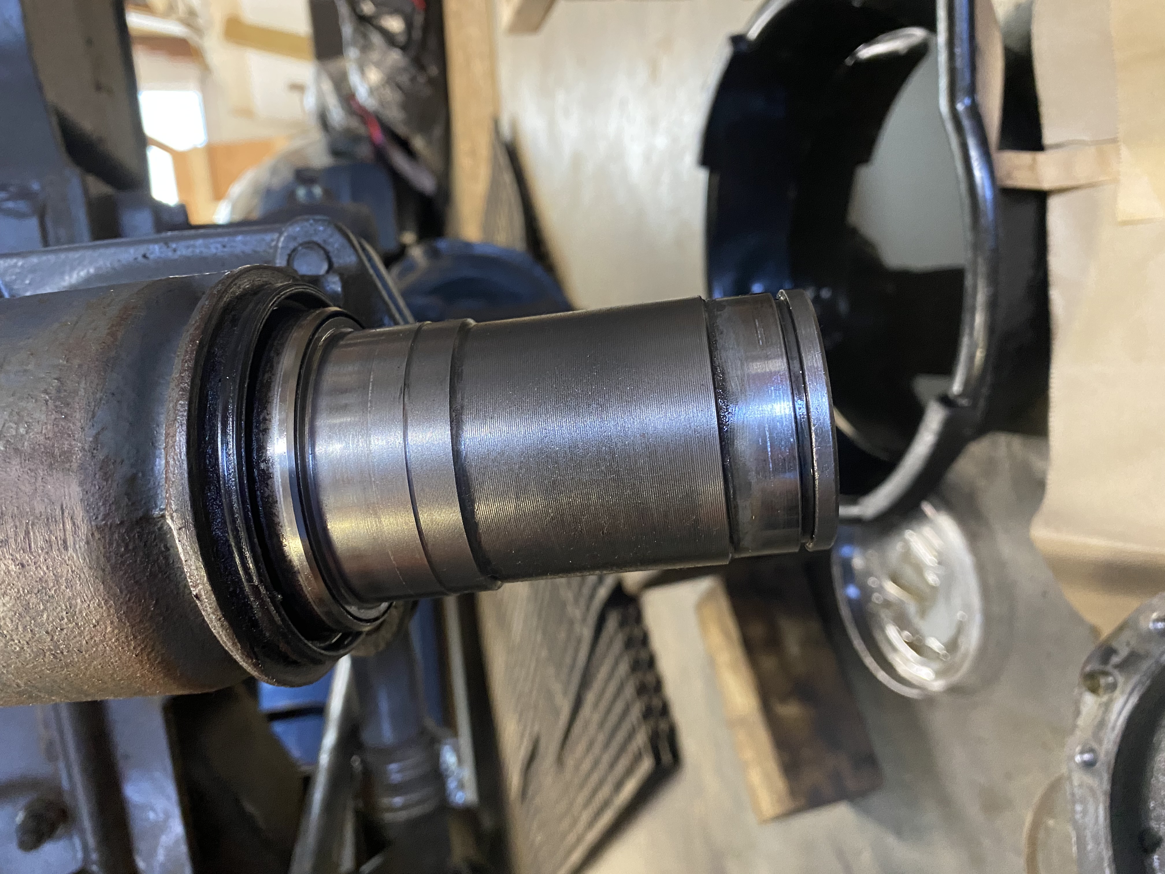

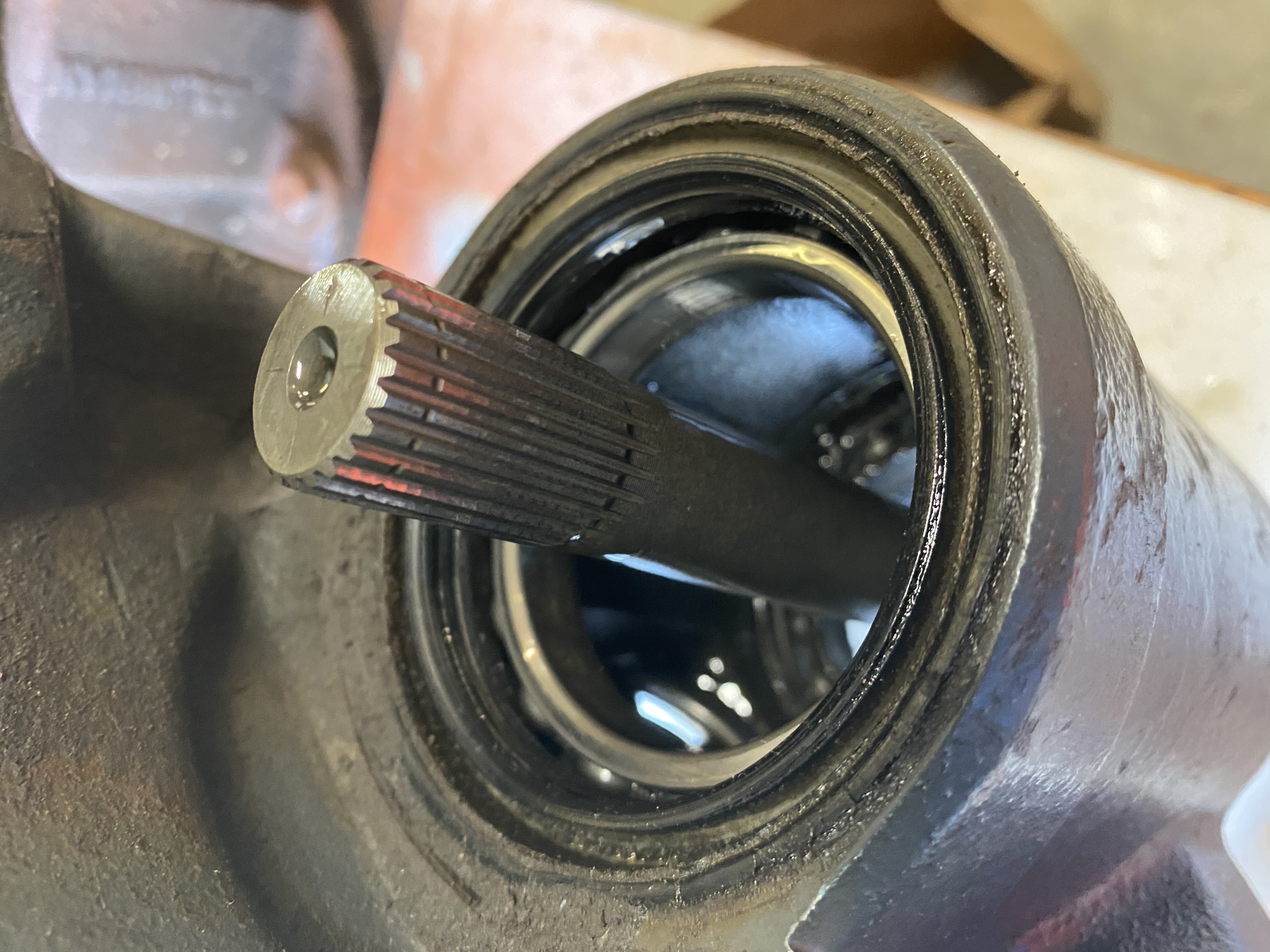

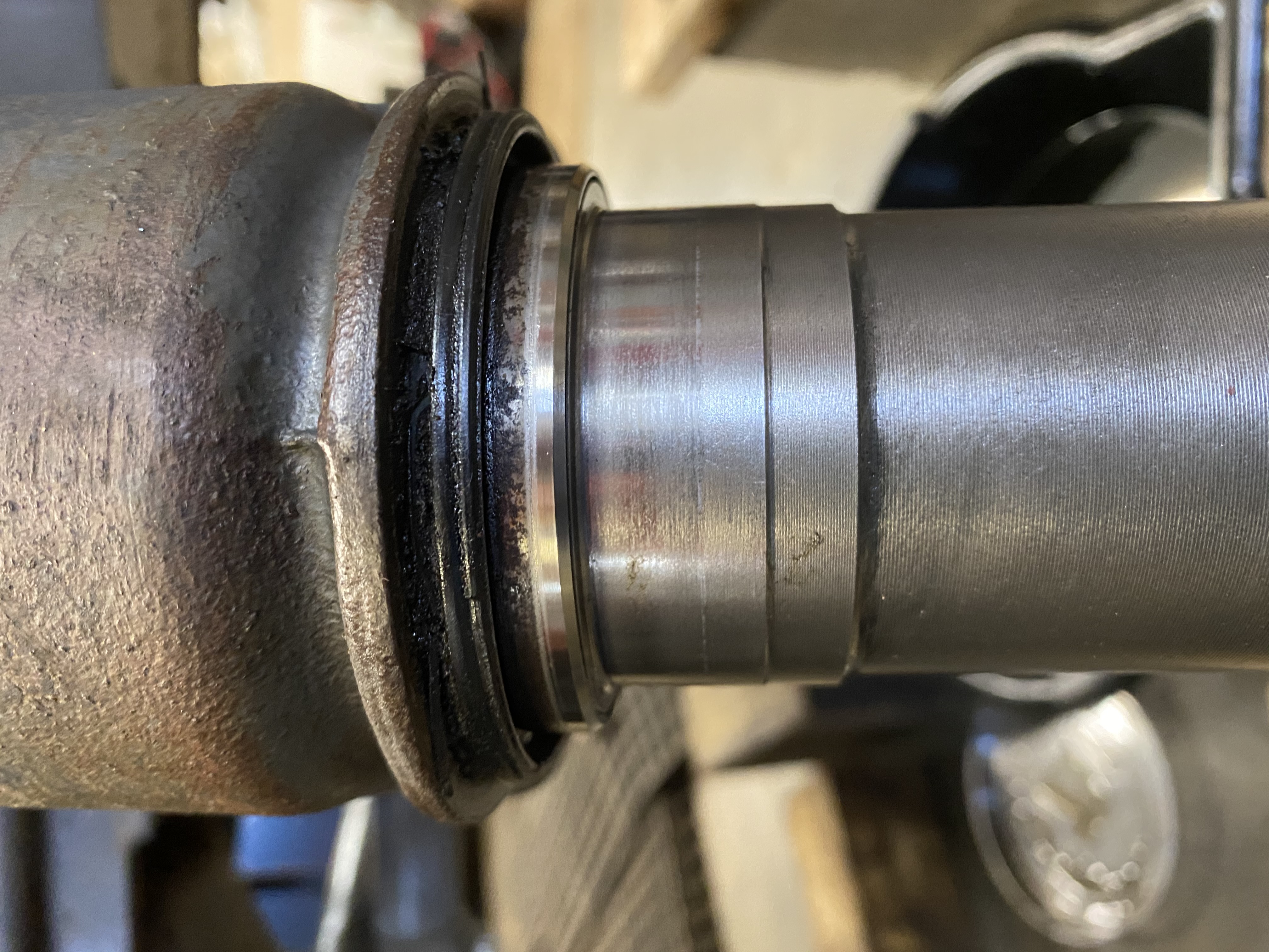

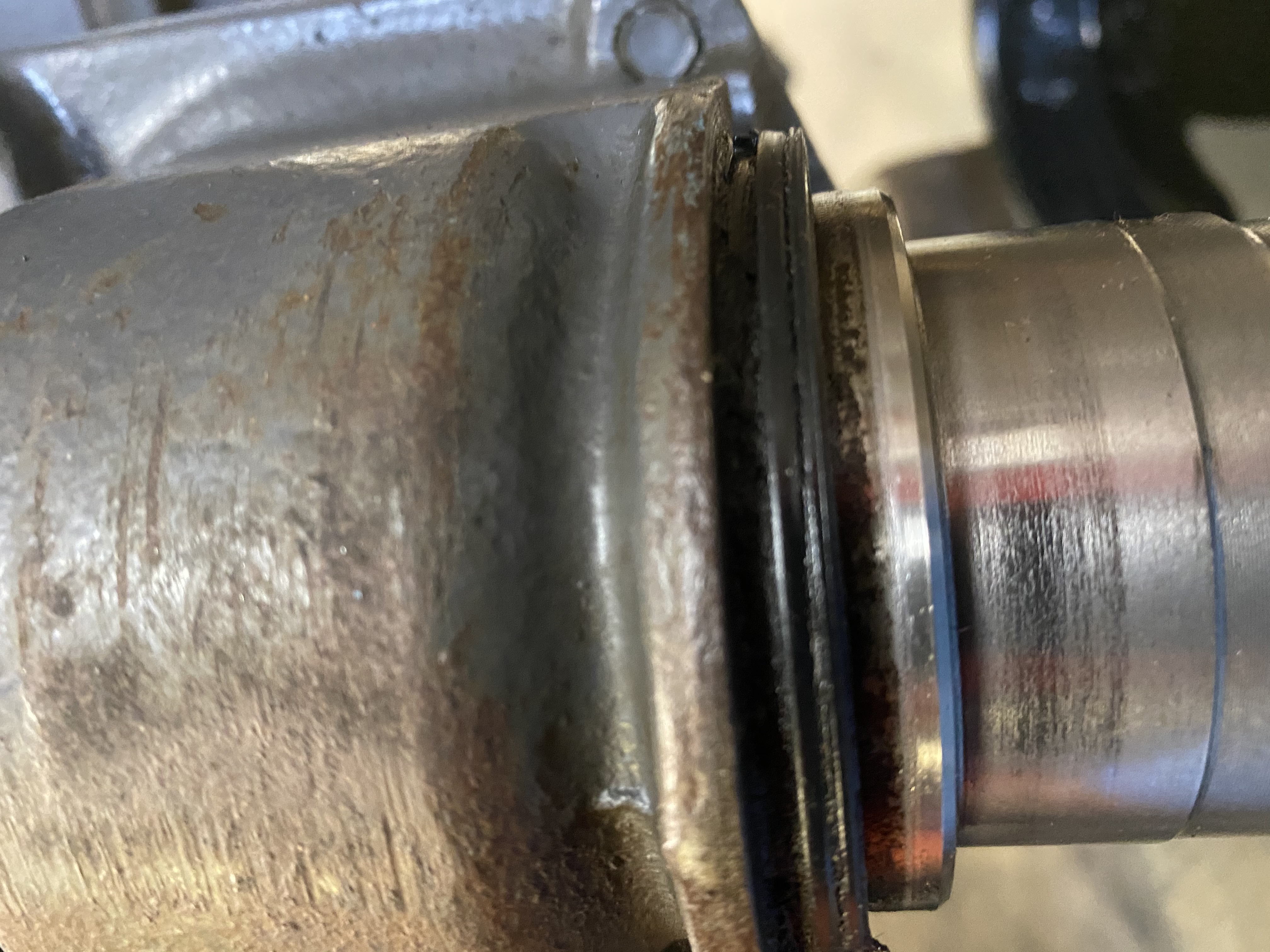

Unfortunately I did not take pictures when reassembling but here are a few pictures of the broken oil seal. In the Youtube link above the guy states it is a two piece seal. That maybe the case on a BX, but not on a B21. I did have to apply heat to the seal on the axle to remove it for about 10 seconds. The new seal gets placed into the housing first then onto the reminding section left on the tractor. Wasn't a difficult job just make sure the collar set stays in place when reattaching. IMG_3963.jpegIMG_3964.jpegIMG_3965.jpegIMG_4014.jpegIMG_4015.jpegIMG_4020.jpegIMG_4019.jpeg
