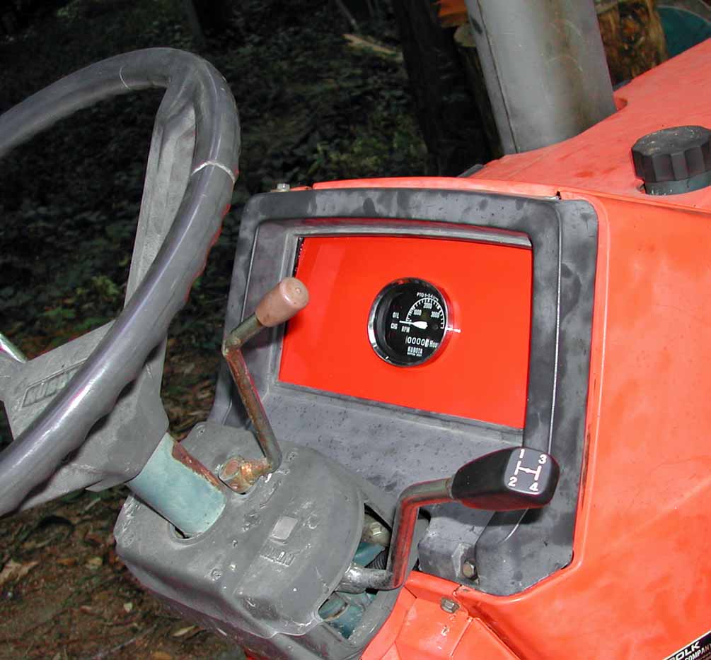

Just had that happen to me with an old L2550. Sadly the tach AND mechanical hour meter were
broken and not repairable. Needles all broke off just from the vibration of handling the cluster.
If the tach is working and the hour meter is not, then often the plastic worm gear is stripped. I
have added a separate hour meter when that happens.
In this case, I used another Kubota gauge that I got cheap.
