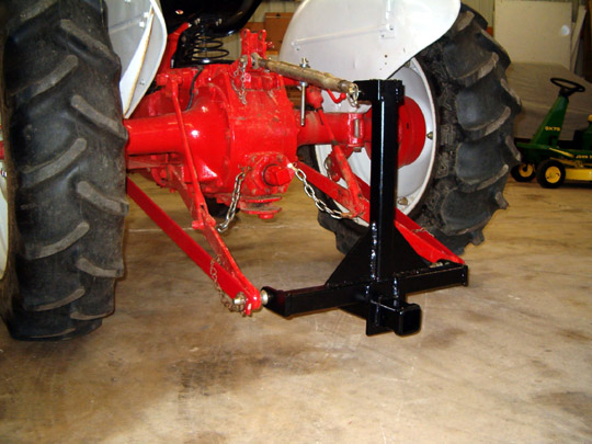

Good morning fellow B owners.
I have my BX2200 towing everything from trailers for my trucks around the yard to pulling a yard sweeper. Has anyone found a way to change single pin yard implements to a 2" ball or a way to make the tractor more "convertible". Is there a hitch adaptor you like that allows more versatility?

Are you asking about changing the implements or the tractor?
I have seen a 3 pt adapter for the tractor, where it has a 2" ball on it and you back up and lift it with the three pt and drive off then just drop the 3 pt and your done
If it's the implements your talking about, then no I havent seen anything but you can buy trailer tongue hitches,,,and weld them on

Make or buy the 3 point to 2" receiver hitch then make or buy a drawbar that has a 2" ball on one side and a single pin plate on the other side. Philip.
